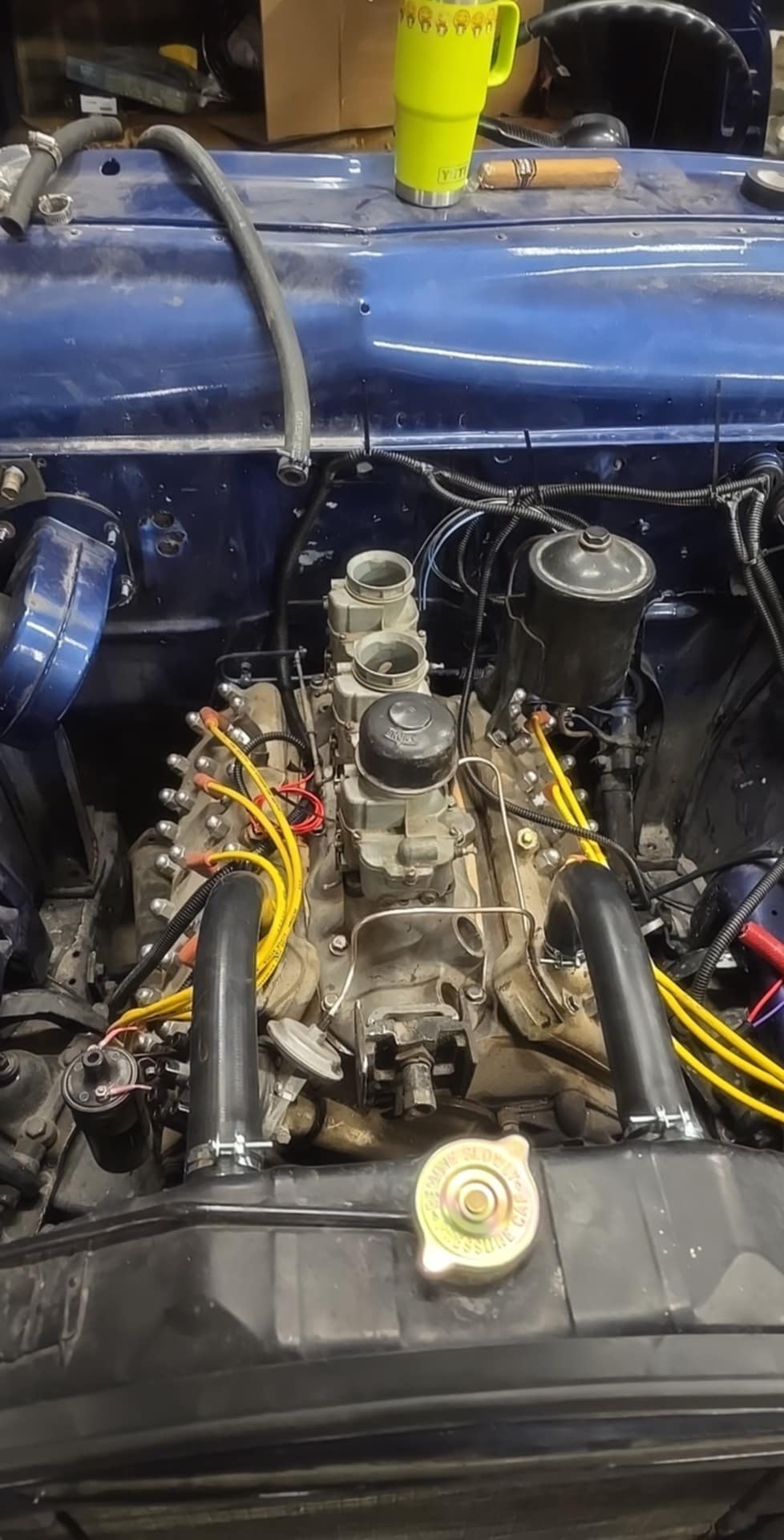

  26. Made a little progress this week under hood almost completely rewired, fenders, and radiator back on. Waiting on a big delivery from Shoebox Central so I can continue...

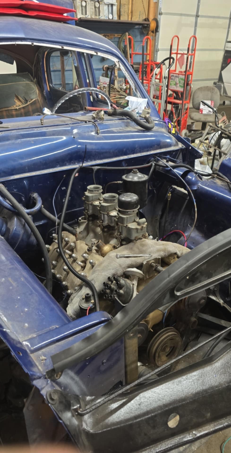

  27. Engine compartment just about finished rewiring

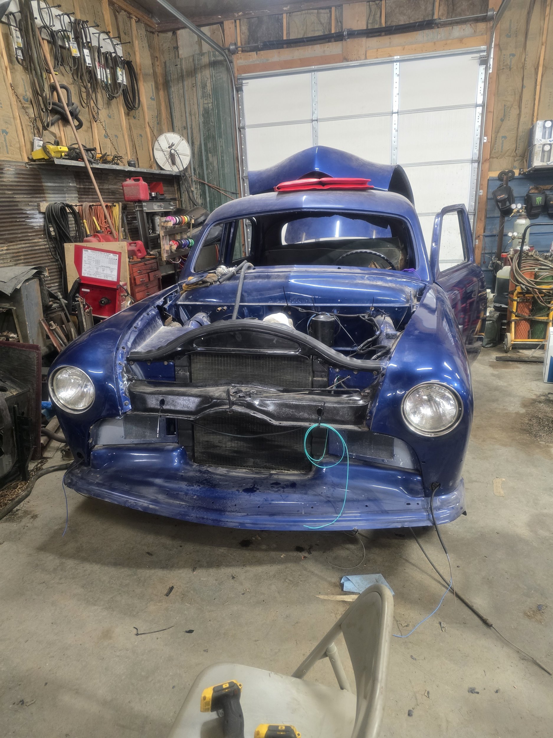

  28. It was another good day in the garage... Trying to piece all this together out of 14 boxes lol but it's looking pretty good 20250303_171818.jpg
