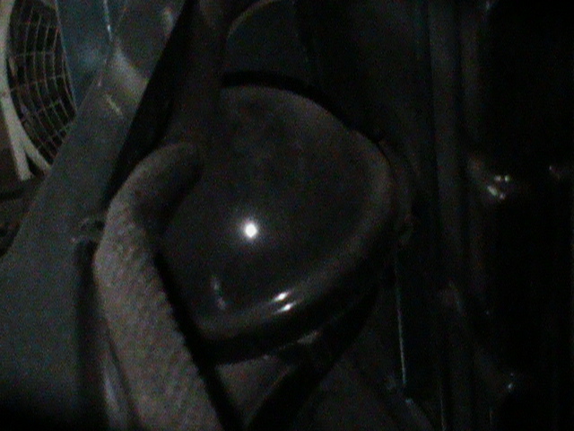

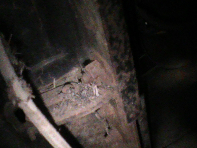

    Two horns, one on each side of the front panel between the radiator and the inner fenders. Last picture is the back of the panel that faces the engine and the horns mount on the front side of the panels.
    Okie Pete and Ratchet57 like this.
  13. Man thank you so much I had overlooked that spot 100 times I would never have figured that out... Thank you for the explanation and the pictures they help a lot ...

    two horns, one on each side of the radiator. you'll see rectangular holes, about 1"X2-1/2". an angle bracket goes in each hole and a horn mounts on it.
    Ratchet57 likes this.
  26. Thank you so much for the information... We got that sorted out lmao now on the the next problem so much fun getting a car in 14 boxes you learn a lot about it
