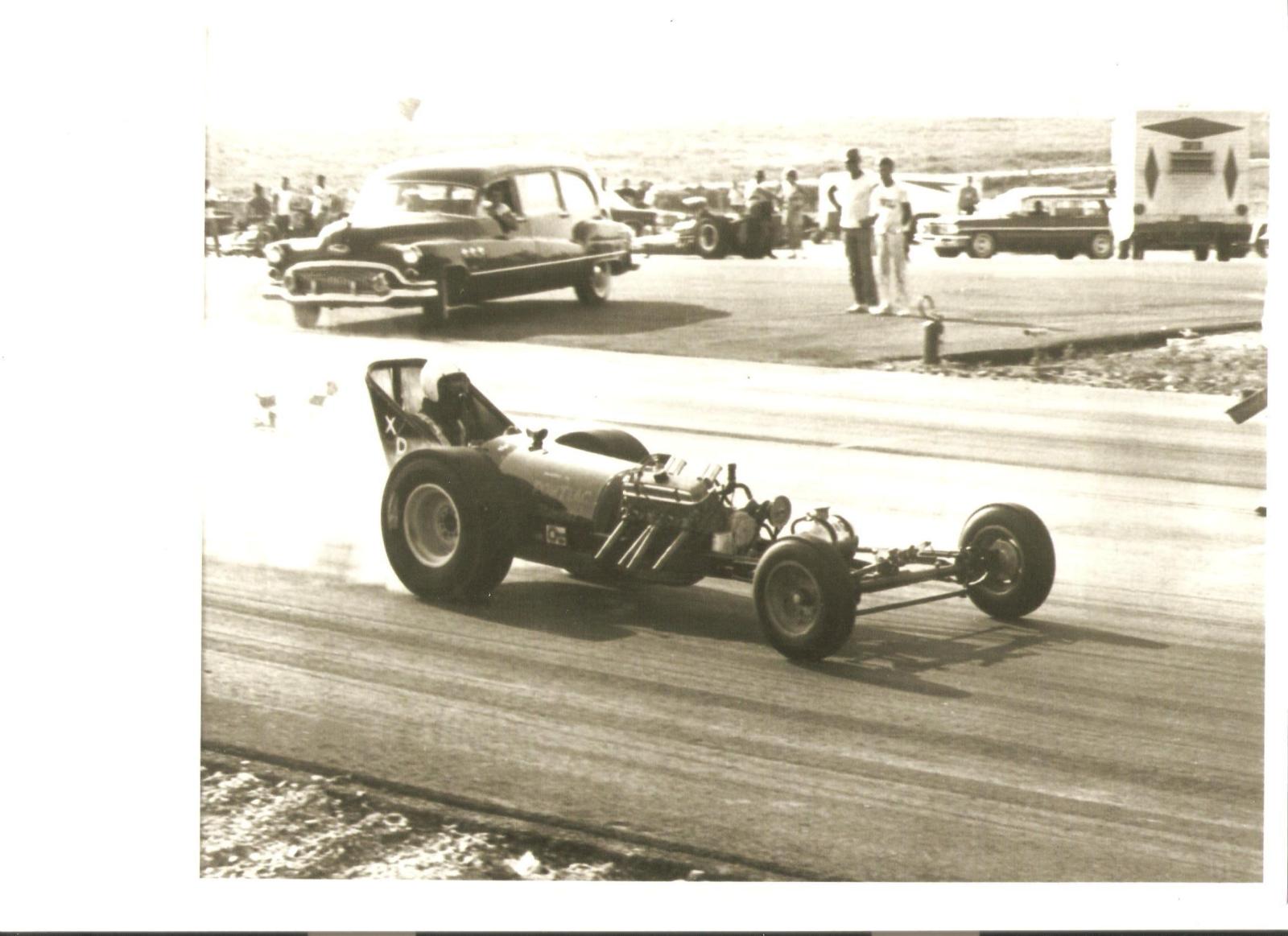

    My brother ran a 194 Pontiac in an X/FD at MoKan in the mid sixties, ran in the mid 10's and 130 mph. The Buick he**** in the background was the tow car. Later installed a Pontiac and sold the car, always wondered what happened to it. He also had a 1963 Tempest with a 194 and 4 speed at the time, would like to see one in a street rod, it would be different.
