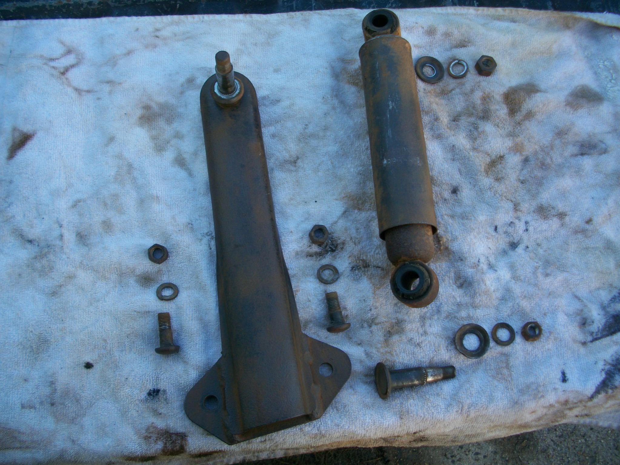

    Thanks. Do you mean this type....

    Yes- excactly-
    A bit clumsy compared, but stock….?

    Not Stock but an early aftermarket kit to put tube shocks on in place of the lever type.

    Ahhh-
    Explains the ‘quality’ of it, welds aso.
    But strong, and hides under the fenders.
    Thanks for the input.
