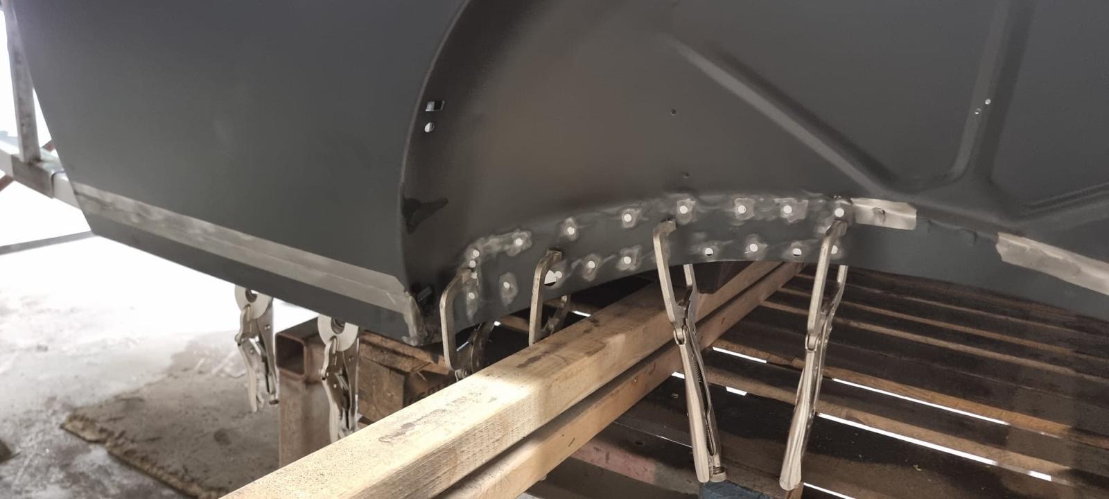

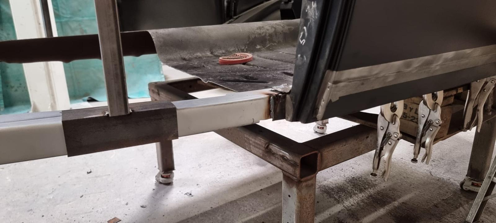

    Some more paint shop updates. Welding has been ongoing and the fenders are all done now.

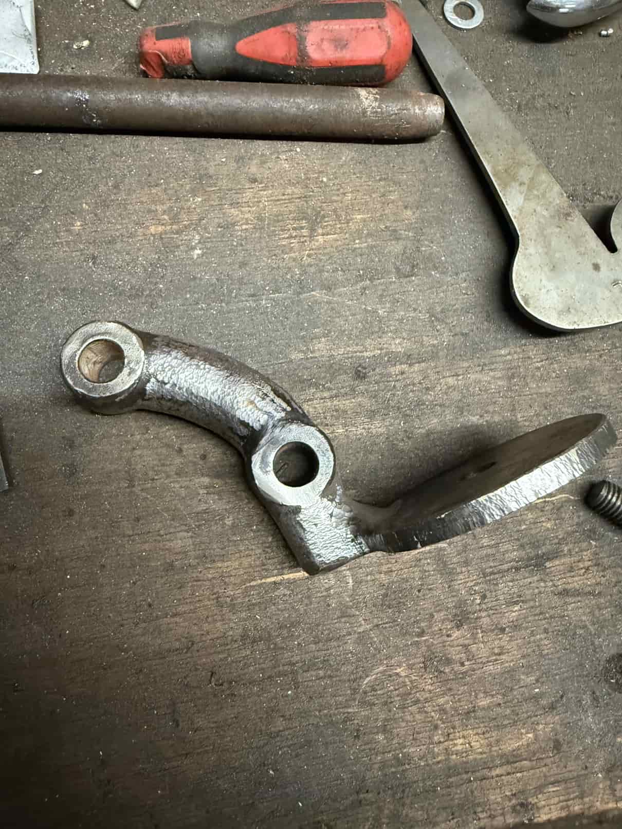

    I have been making a set of lower rear shock mounts from some Chevy steering arms.
    They still need a few tweaks to get the mount and the bolt holes into the right position, but not far off.
    These use the brake backing plate bolts to mount them to the axle hubs.

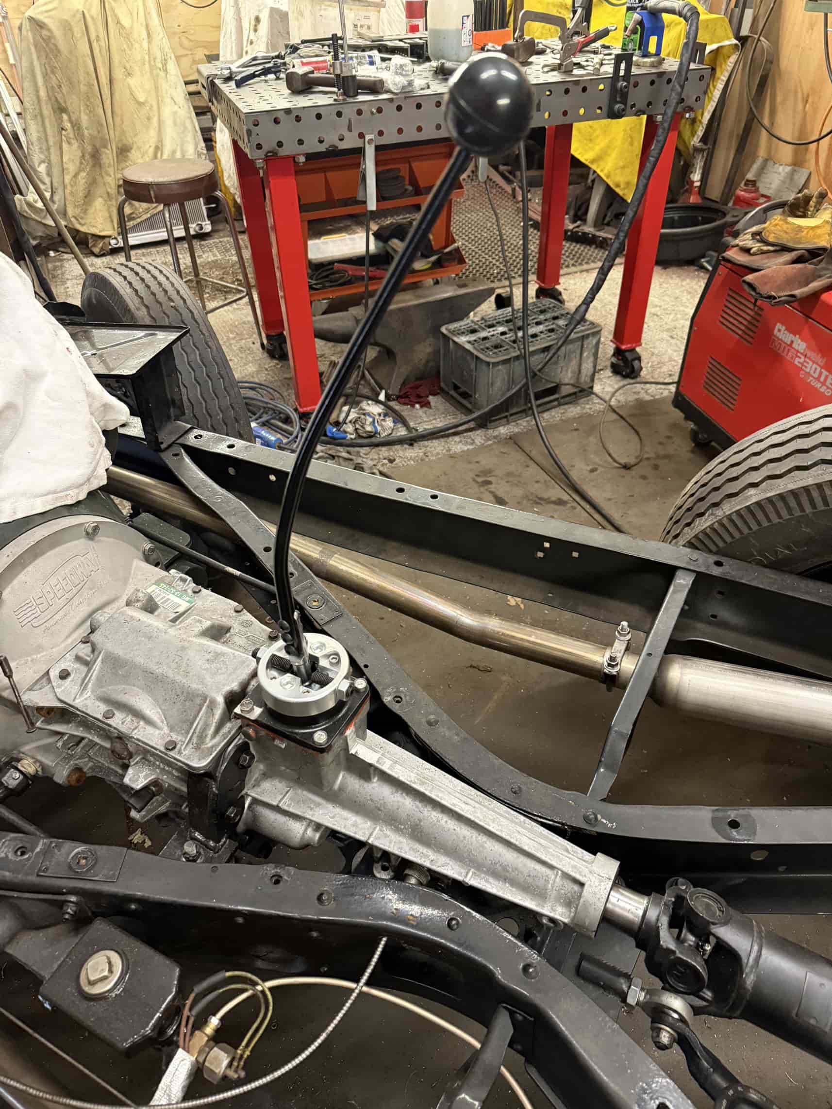

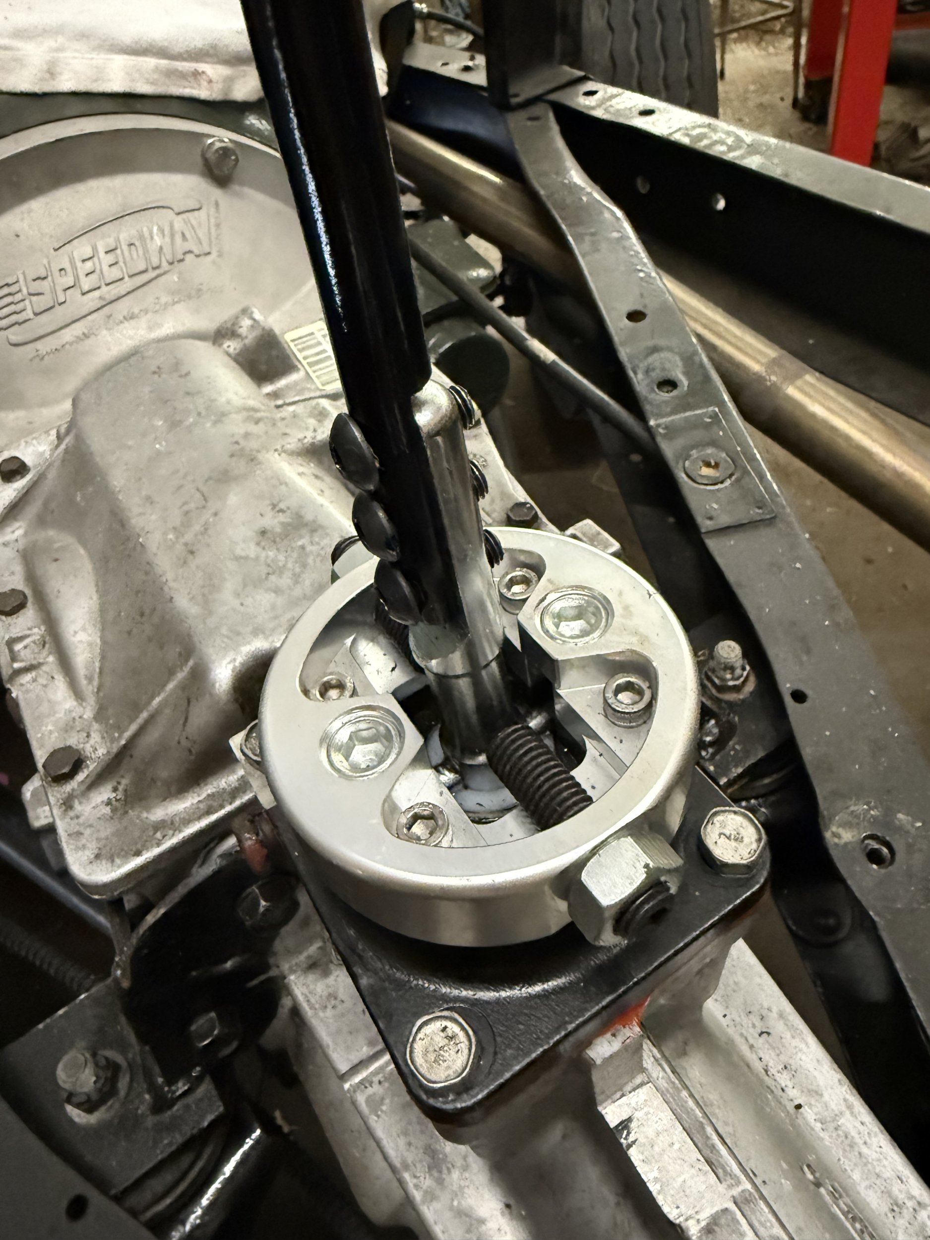

    Gear lever done. It looks a bit better than the T5 tubular unit and I will put a nice ball on the top when the body is back on. I used a Model A lever and trimmed the bottom to match the quick shift unit.…..
    Thor1, Okie Pete, Deutscher and 12 others like this.
  18. 57tailgater
    Joined: Nov 22, 2008
    Posts: 911
    57tailgater
    from Georgia
    Nice conversion on the Mustang shifter for the S10 T5. I am planning on doing the same thing. Very nice work on all the things going on with this car. Have fun and keep it up!

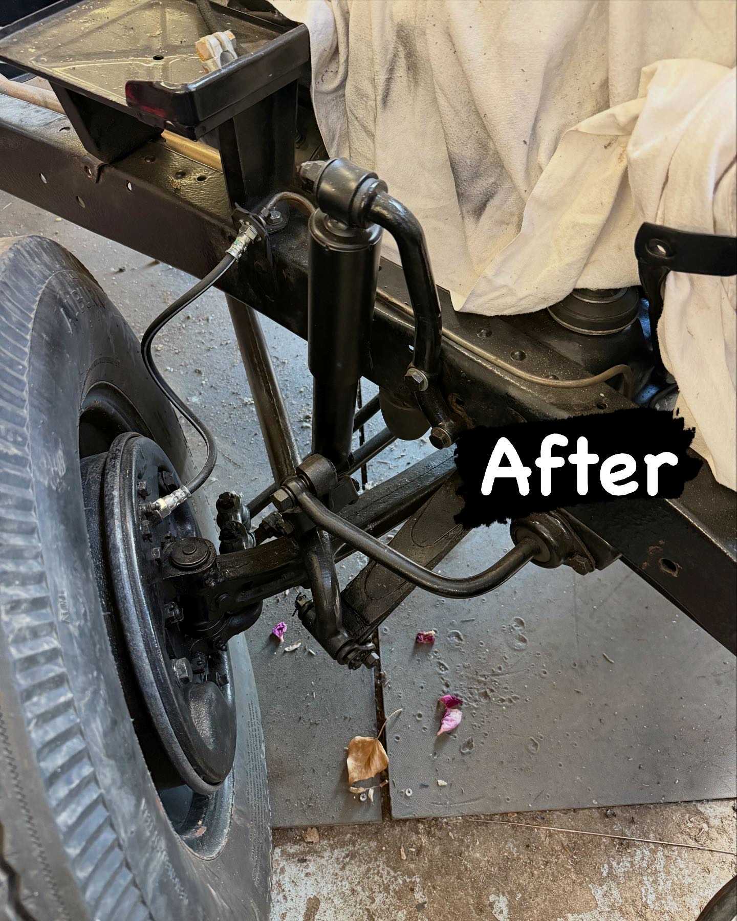

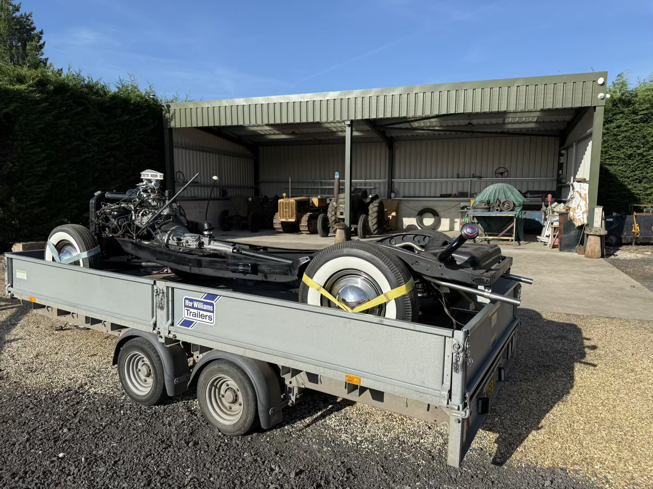

    I'm pretty much done with the rolling frame now. Suspension mods all seem to have worked as I had hoped and all 4 corners move up and down much nicer than they did. It also looks a lot neater overall. It's been easier for me working with the body off than the previous guy(s) doing their stuff from underneath.
    I might not be able to leave the gearbox mount as it is - it's the only bit bugging me now. I will see if i can lift the gearbox out without dropping the rear end out. That will give me access to the underside of the crossmember and I can remake the mounts a bit nicer.
    I will have to hurry, though because the floor panels finally landed from United PAcific after a long wait for the container ferry. I dropped them off at the body shop so they are moving forwards again.
    Here is how the frame sits right now....

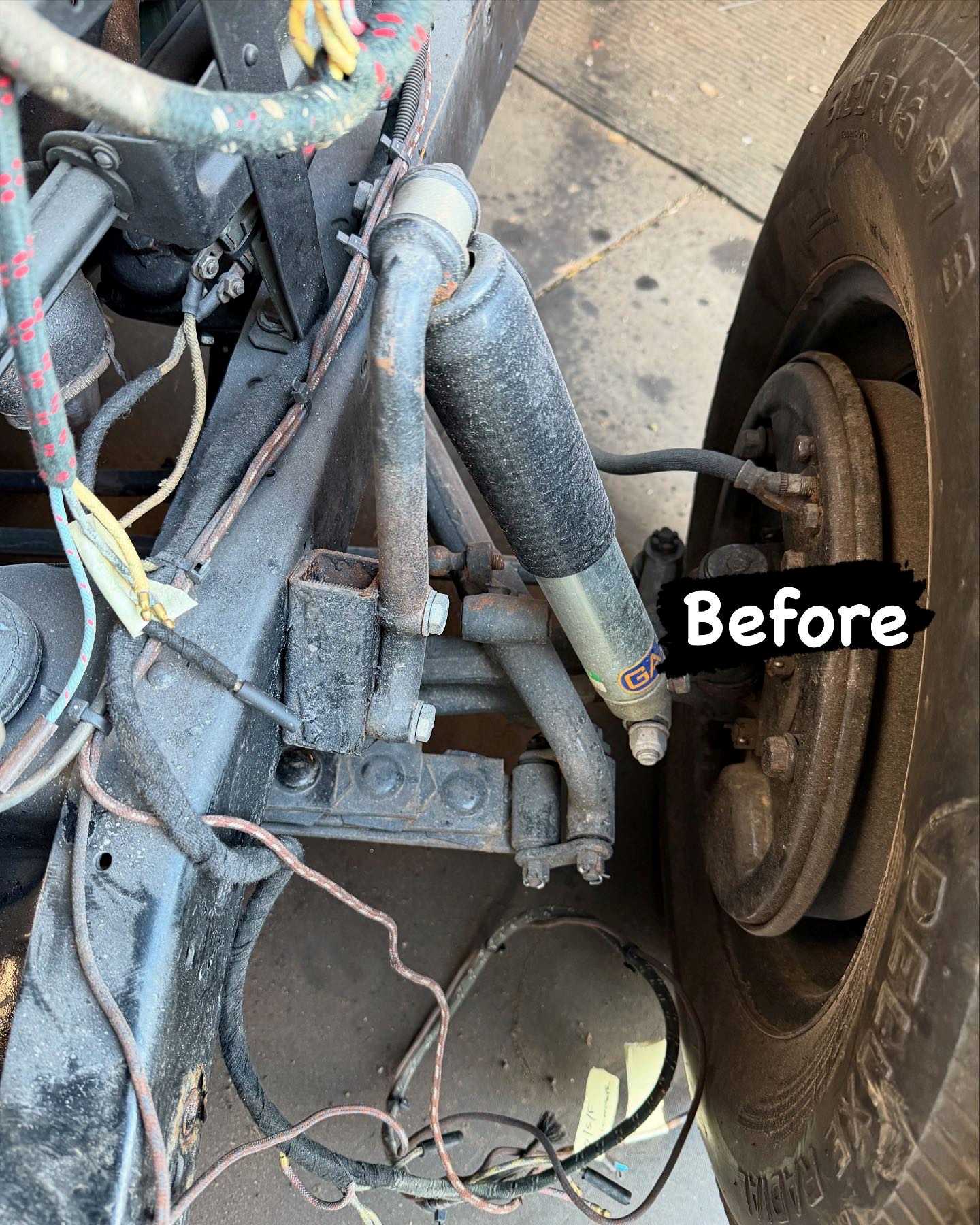

    Here is a quick review of how the front end has changed. Those Gabriel shocks are much softer than the gas-filled Gaz ones as well, so it should drive like a different car.

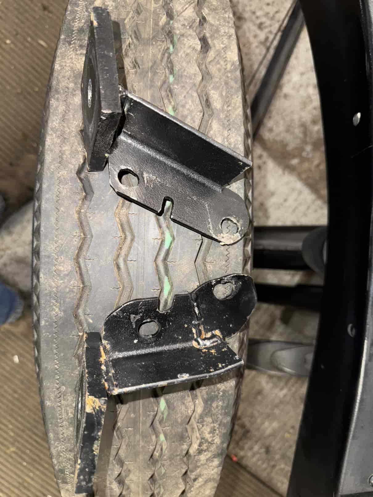

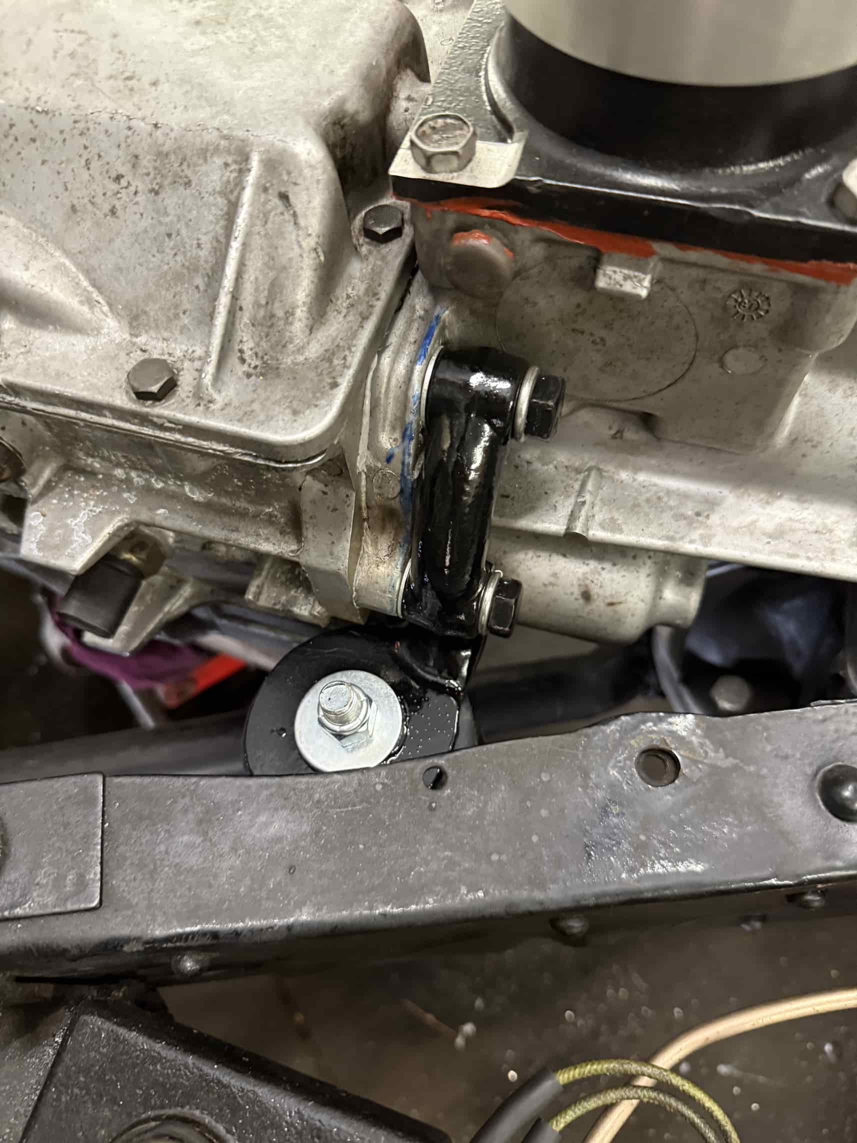

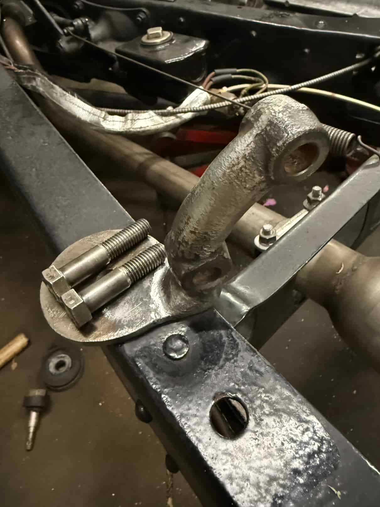

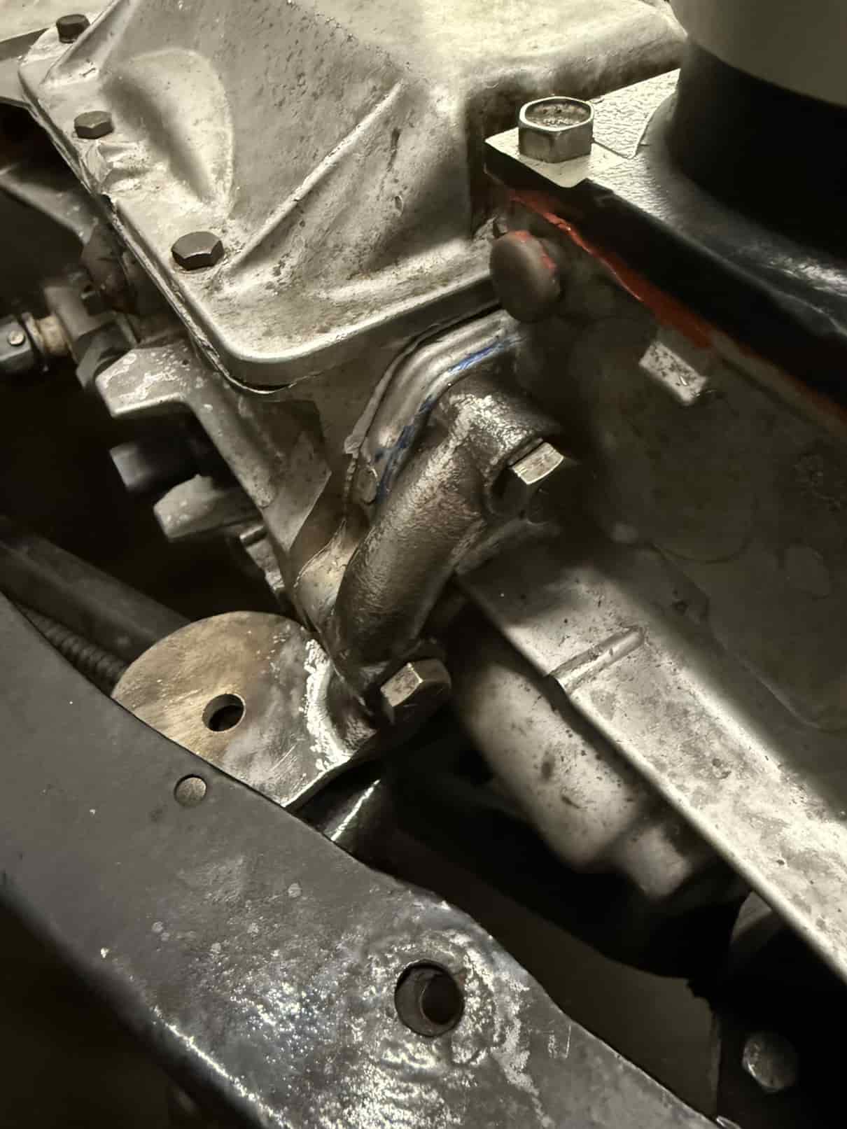

    I had a go at making some new gearbox mounts. The ch***is pads are ok, so I left the gearbox in place and decided to just re-make the top halves. Here is what I took off:

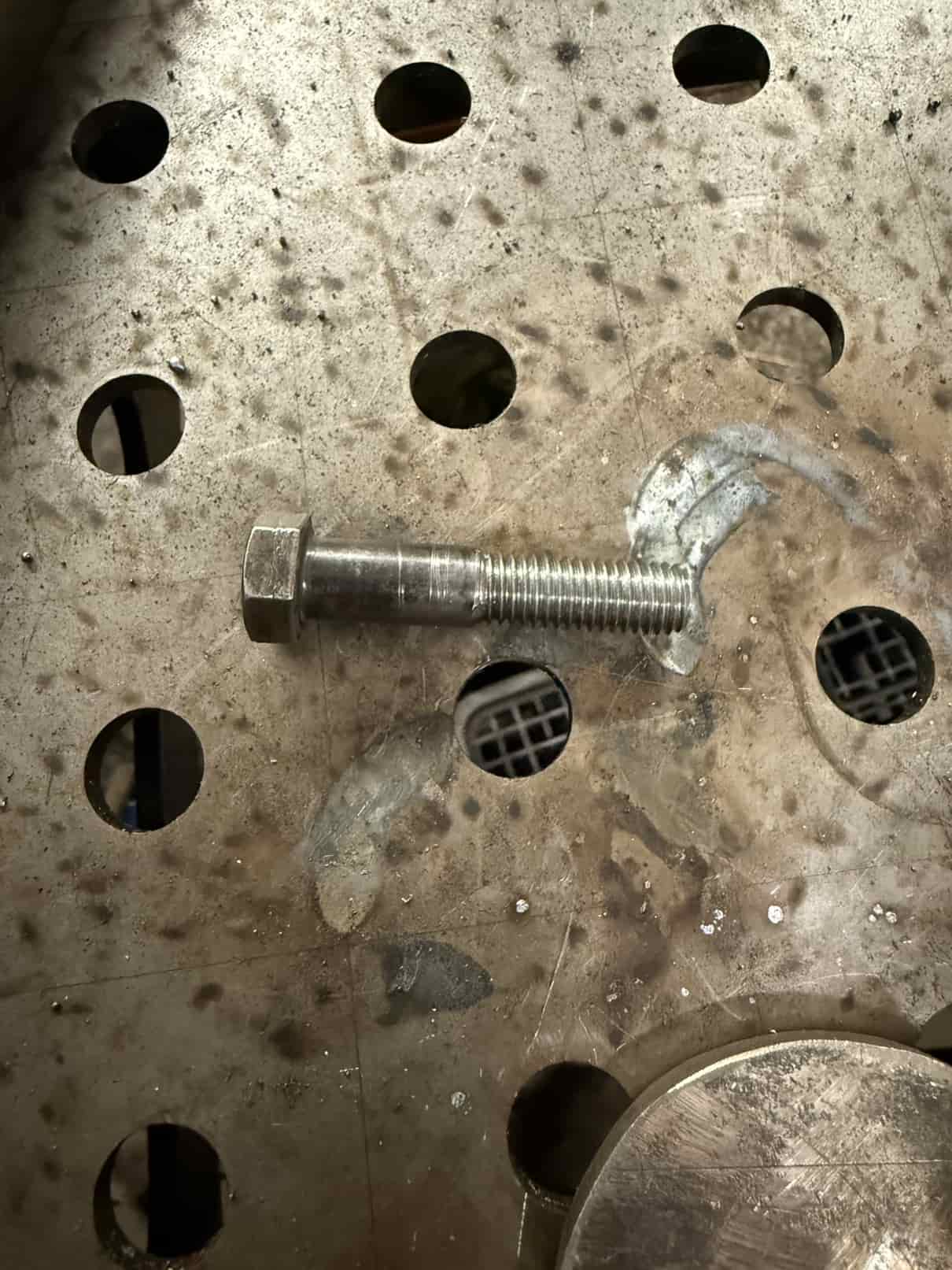

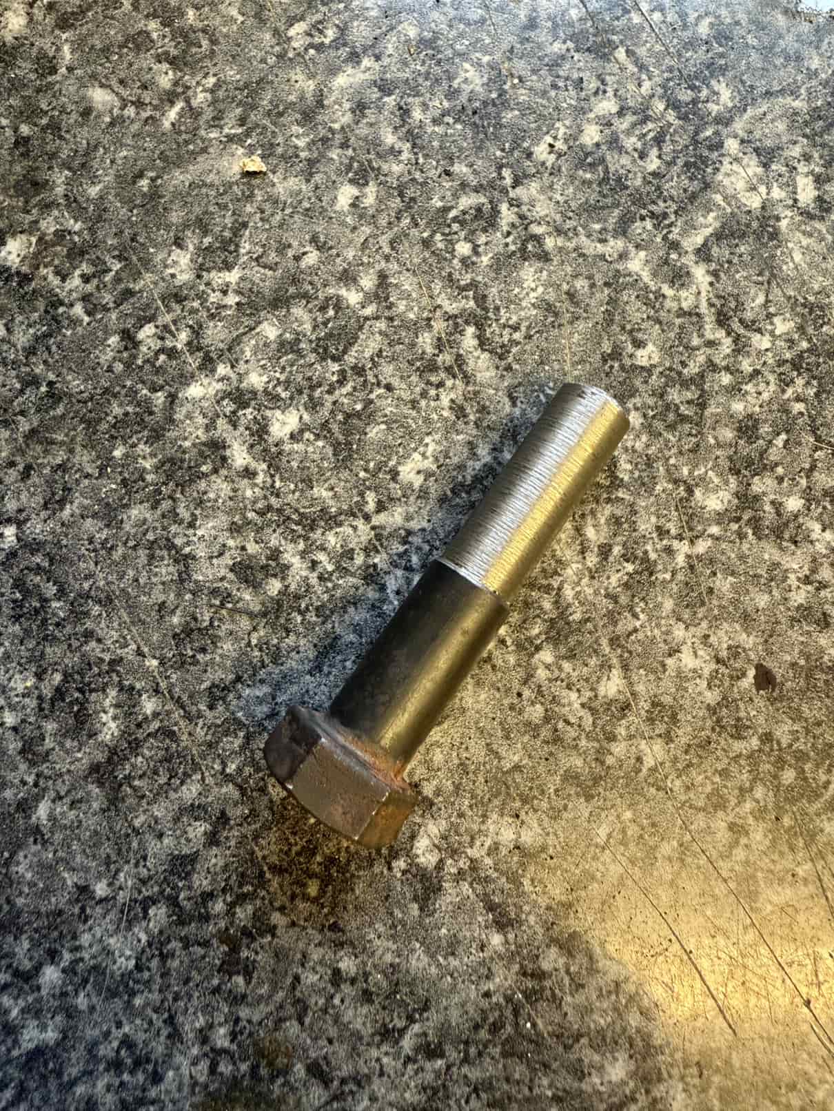

    I used some old F1 shock mounts and welded them to a piece of plate. Had to turn some 7/16” bolts down to take a 10mm thread….
    Just waiting for some new rubber donuts then I can get them bolted down. Paint in the meantime.

  23. flamedabone
    Joined: Aug 3, 2001
    Posts: 5,764
    flamedabone
    No one will ever see them, but you will know they are there. I'm sure the old ones worked just fine, but the new ones are WAY better.
    -Abone.
  24. joel
    Joined: Oct 10, 2009
    Posts: 2,740
    joel
    That's a clever trans mount. Nice work.
  25. Little Terry
    Joined: Oct 17, 2007
    Posts: 808
    Little Terry

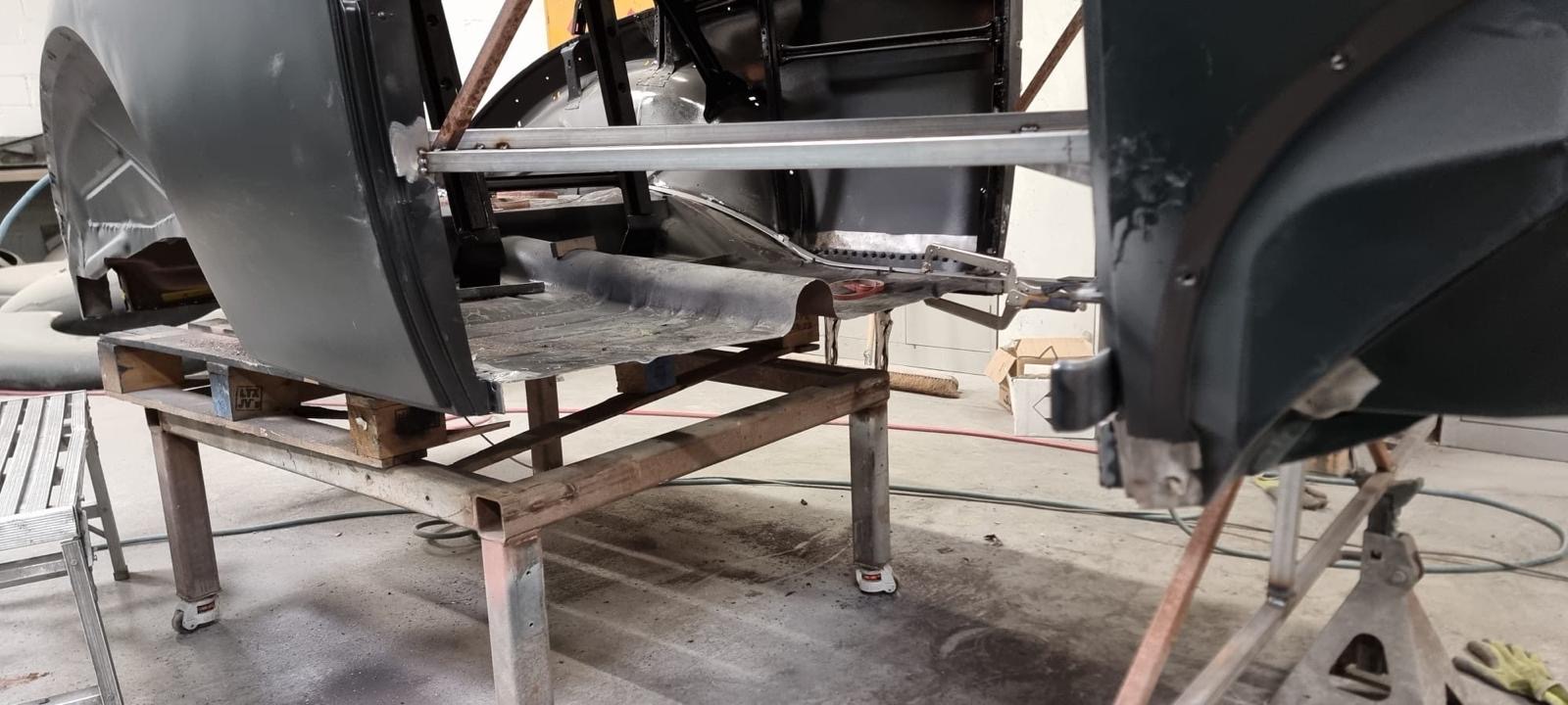

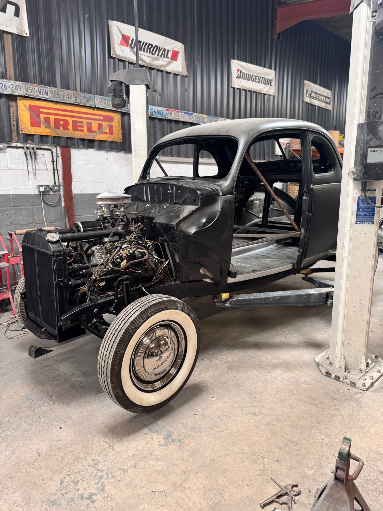

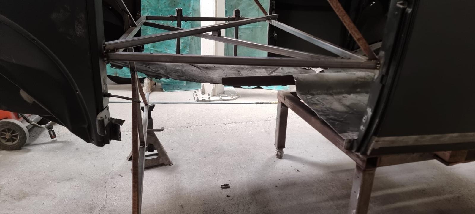

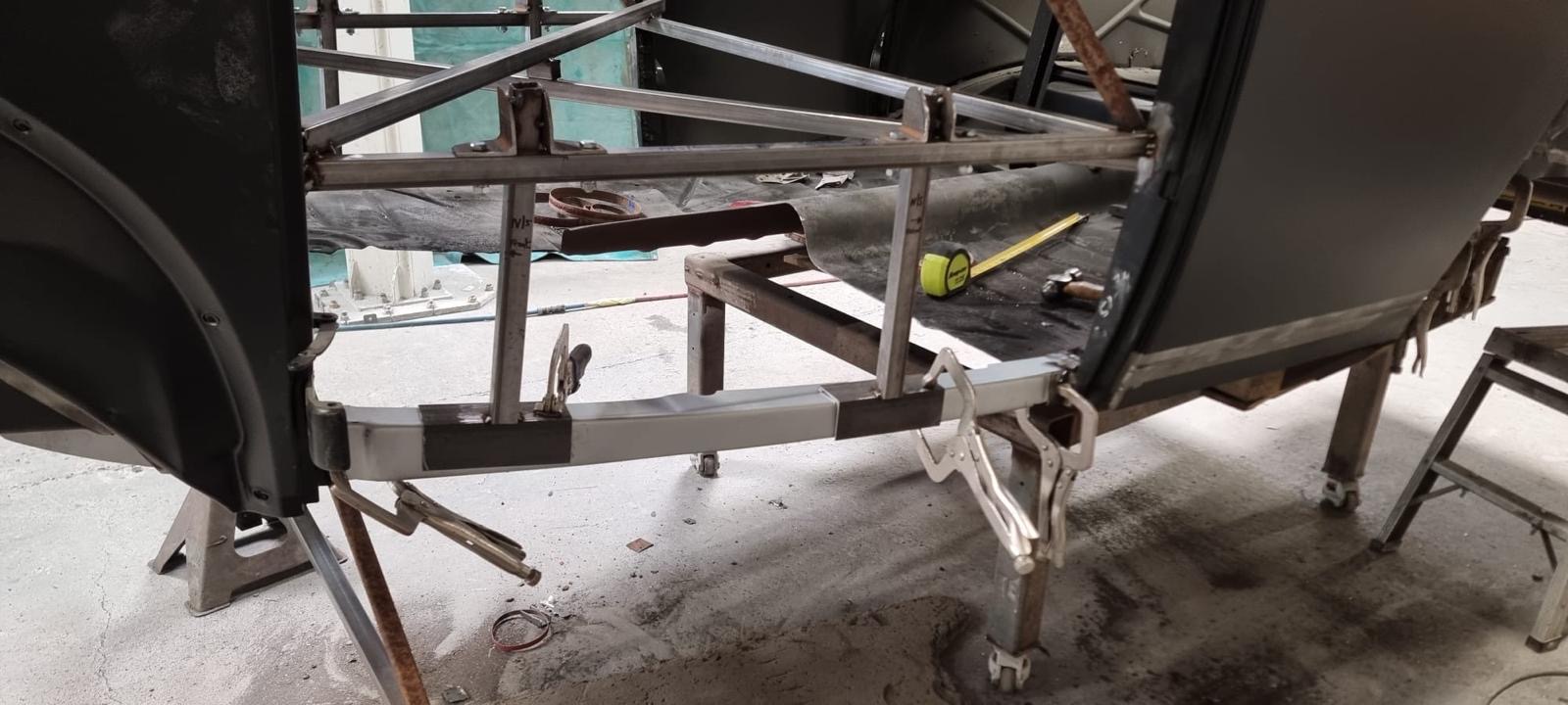

    Here we go folks, we're back in business......

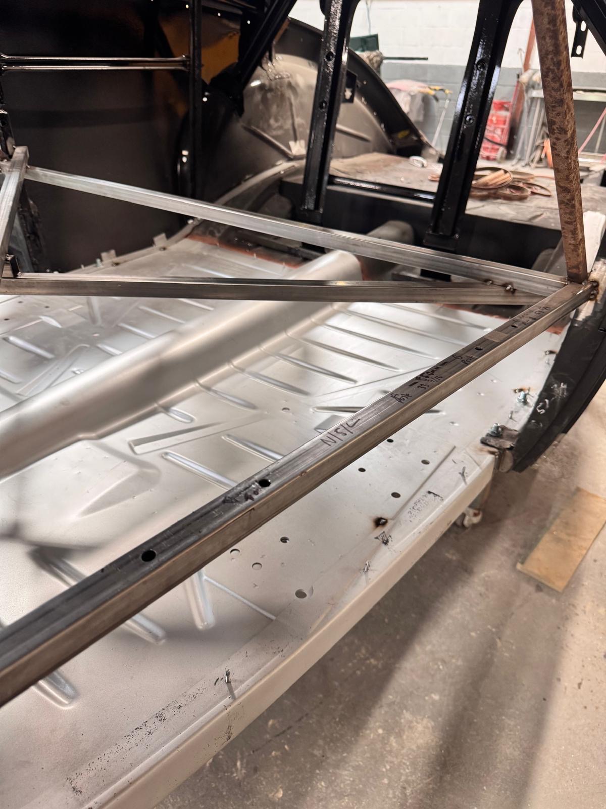

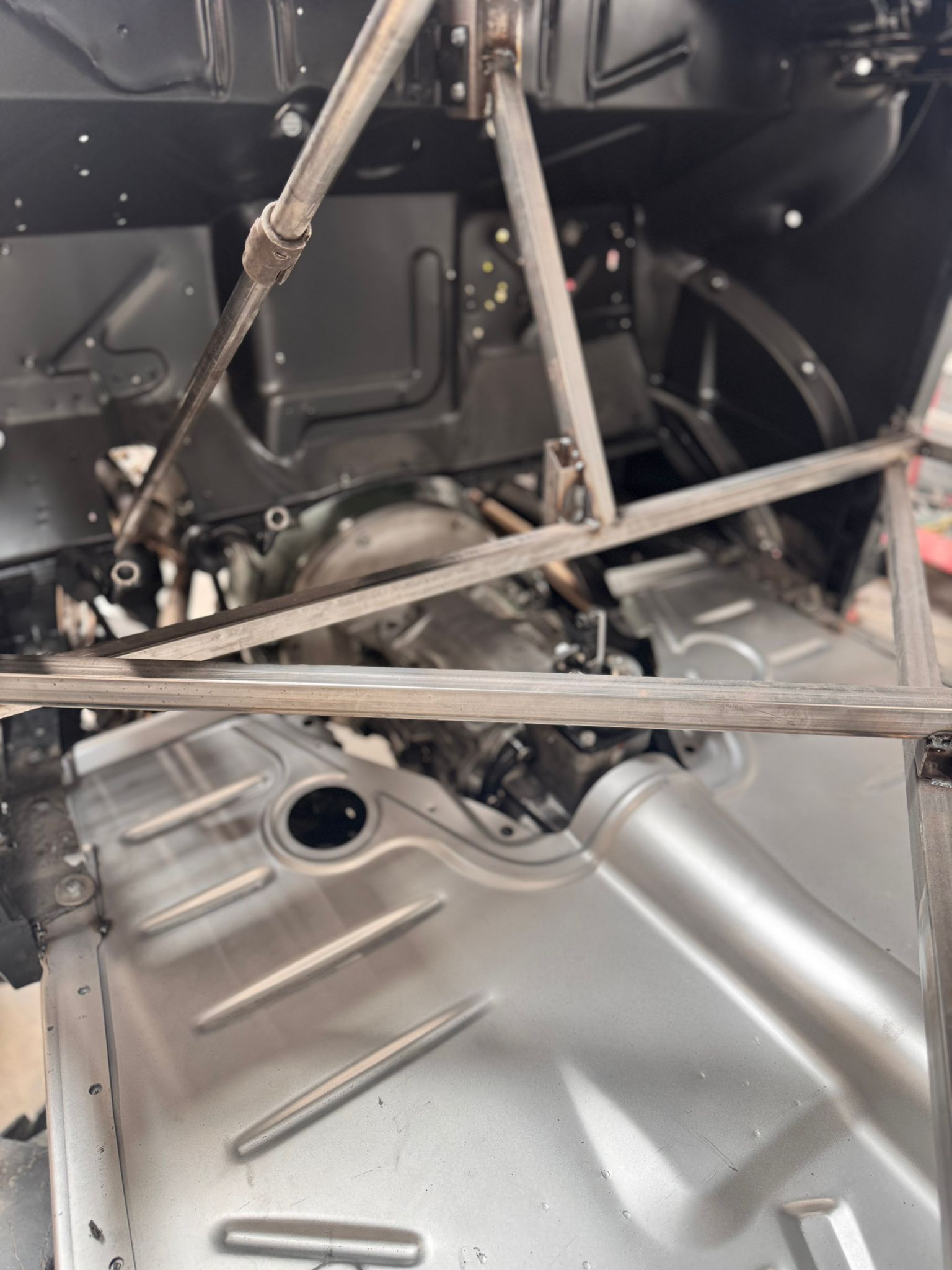

    The welding on the floor has begun. The quality of the UP panels seems great on the whole. The trans tunnel is a bit taller than stock, but the guys are going to pie cut it to get it to blend in.
    c363bd61-1a86-408d-8073-db08ec8507a9.jpeg b24473a2-6b2c-42bb-9cd4-ef6061507e4b.jpeg 7e8e874b-28ce-43c2-996f-9bfa261c1149.jpeg 3f18b688-db5b-4518-9108-baae55434d90.jpeg 94acc31b-0924-421e-b540-1dfd6e93d0e8.jpeg ef8dcf32-9ddb-4780-a267-da32a71f07a8.jpeg d9a149b8-3062-42a1-8ce4-236247f8ac14.jpeg 177e9637-0bca-4d7b-973d-612767305c17.jpeg
    So the next stage was to get the frame back from my place and take it back to the body shop.
    And later that day they managed to get the body re-united with the frame for a trial fit.
    043746a5-de60-4bd4-81f3-07c3400198b4.jpeg 9a515bbb-2569-4ea2-b82e-71da158ee20a.jpeg 93e64bbe-34ec-4c7a-a9d4-eb979a576fe6.jpeg
    That's it so far. I will call by the body shop in the next few days to have a look at the floor and then they will proceed with fully welding it in. Happy days!
