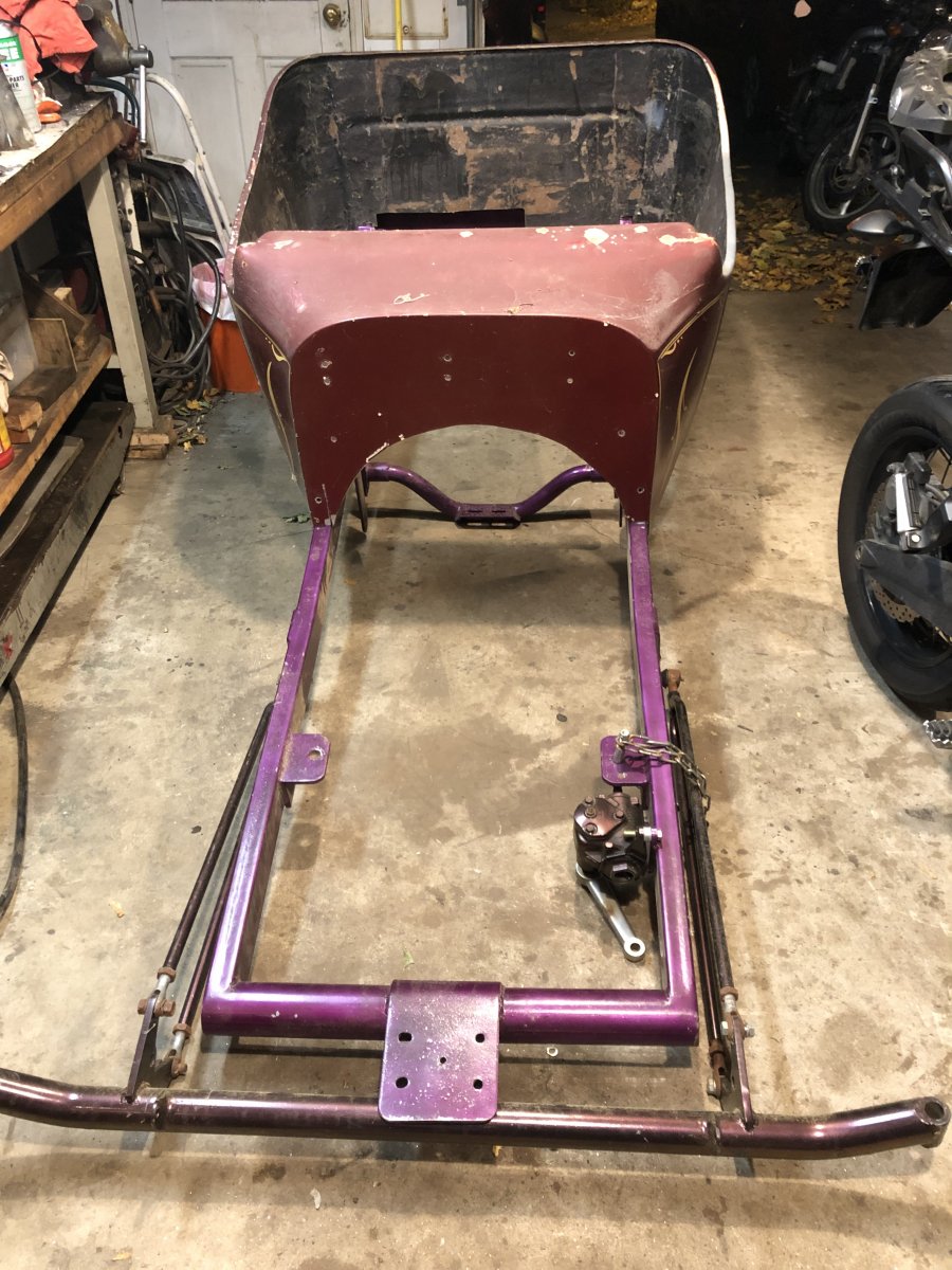

    Upon making it to the farm this is what I was presented.

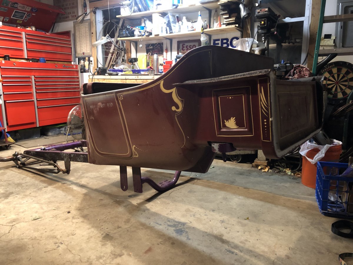

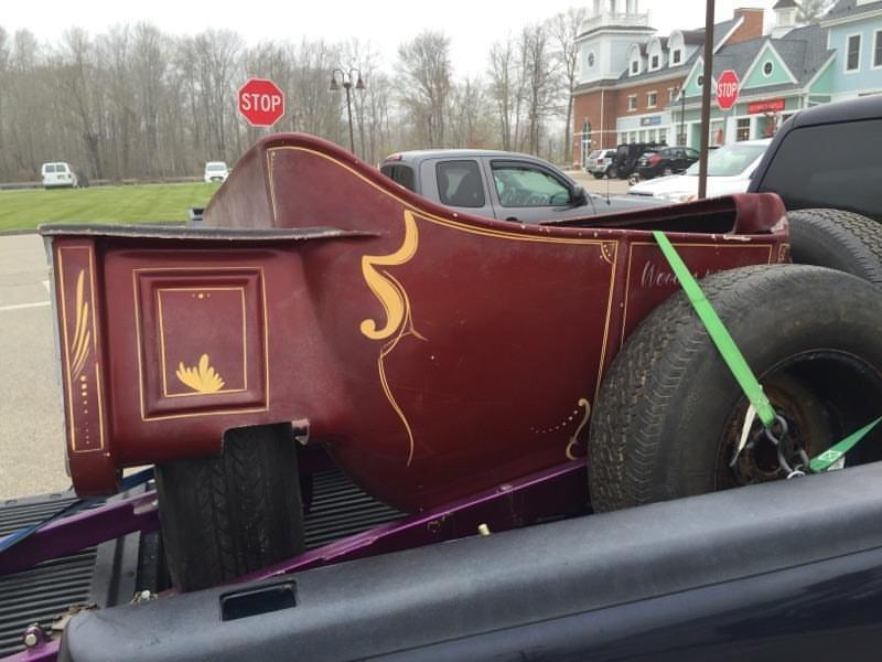

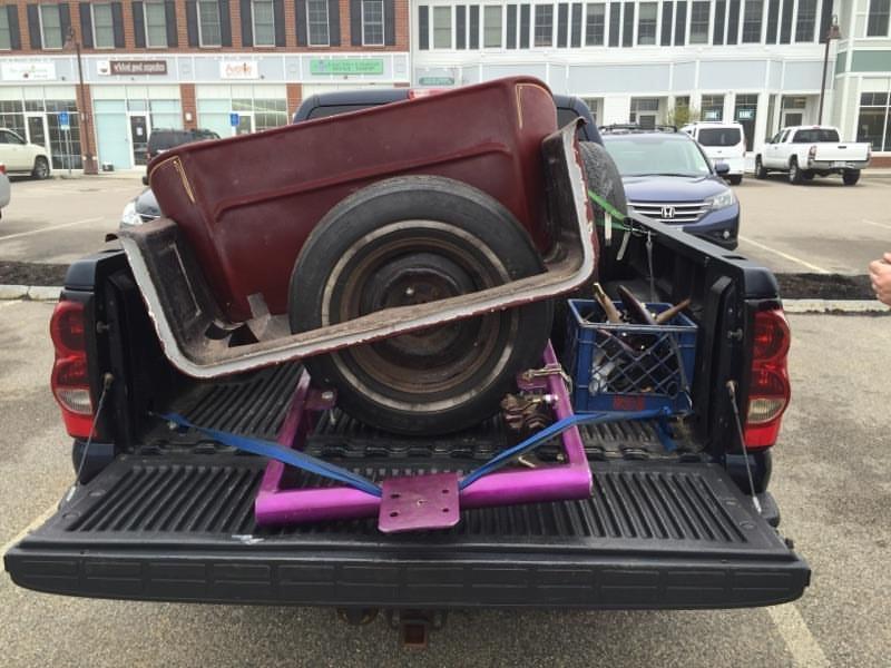

    No origin story on the body except that he'd bought it as a collection of parts from someone on craigslist. It definitely appears to be old hand laid fibergl*** and it had a slide out rear tail gate, which is a feature I haven't seen before. I was told that the US Speed and Sport bodies would do this back in the day but I have no way to confirm that, so I guess I'll just perpetuate the concept until it becomes fact.

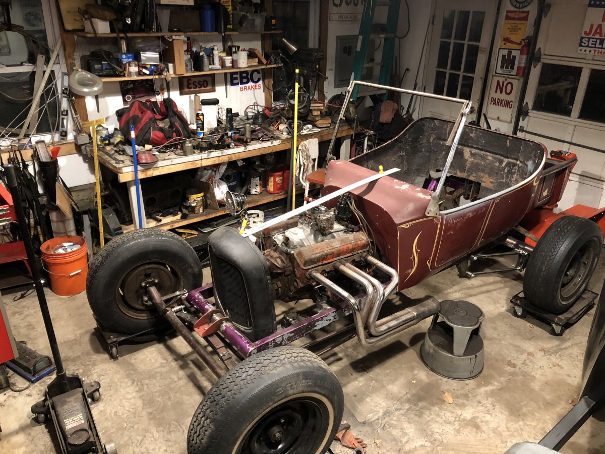

    At the end of the day this was the haul of parts; old gl*** t bucket body, front axle of unknown origin, Chevy spindles and brakes, Vega steering box, box tubing perimeter frame which was crudely set up for coil over suspension and a '58 Chevy posi rear end.
    I got it home and after a little mocking up this is what I had. Looks great, except I didn't want to use coil overs, the front spring mount was nowhere near strong enough. the transmission crossmember hung a foot below the frame, the motor mounts were in the wrong spot, the steering box was booger welded on and the front hairpin plates were completely crooked. Yep, other than that it looked great. In the end every bracket welded onto the frame would be cut off and fixed.

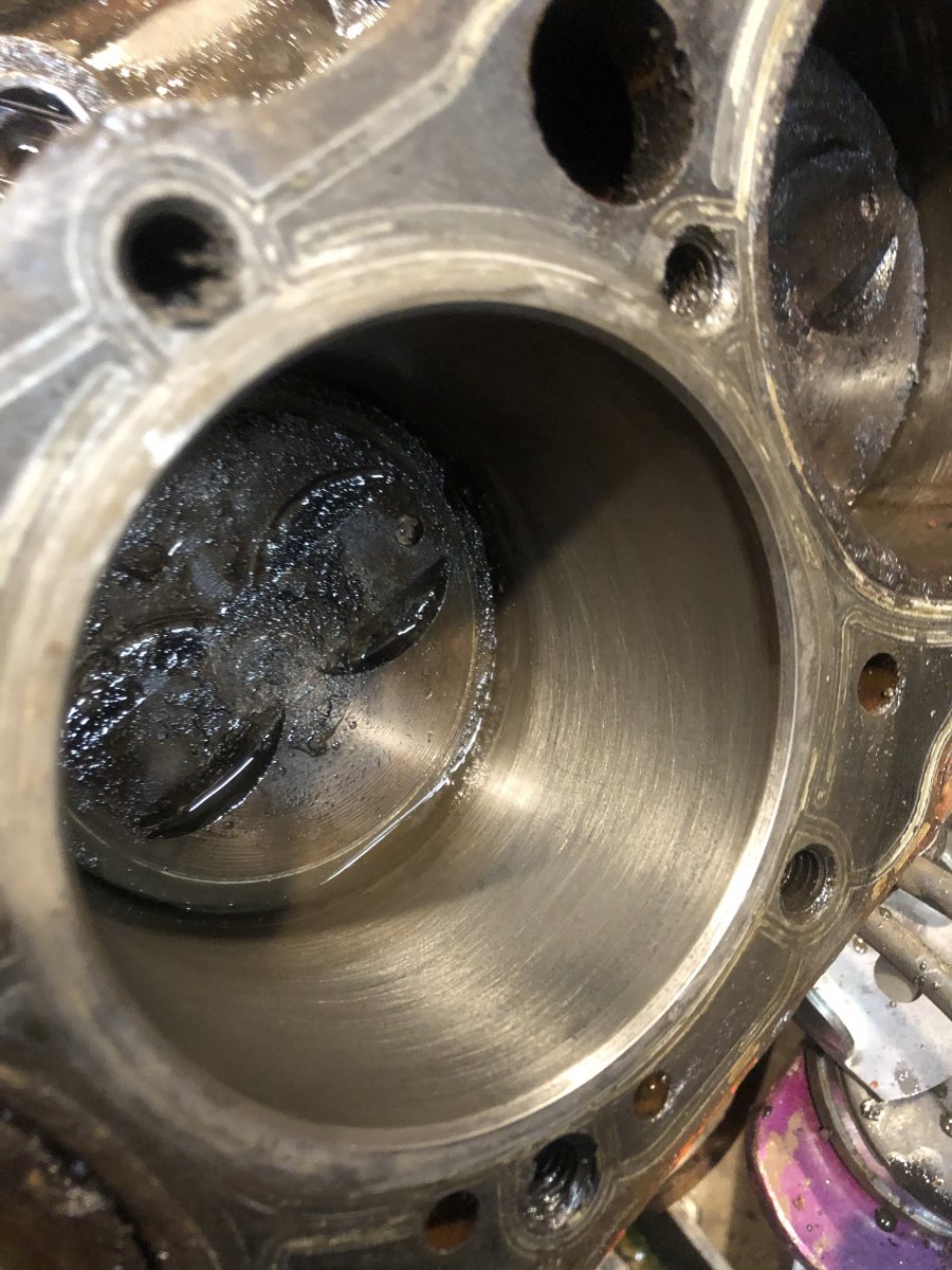

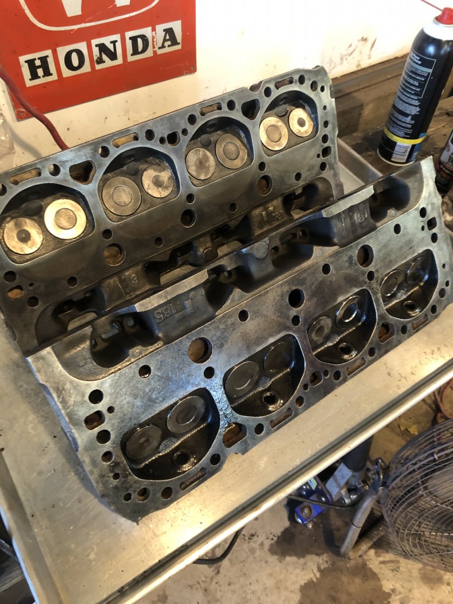

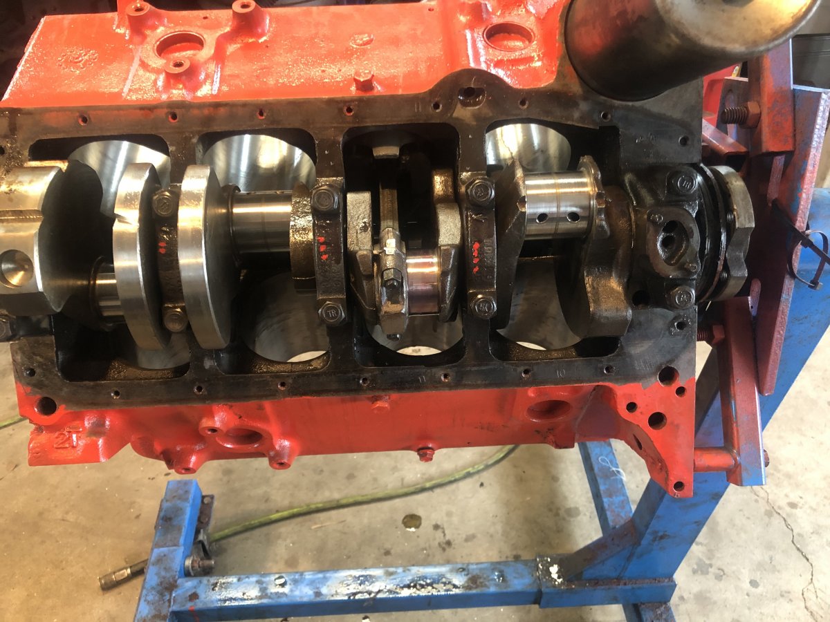

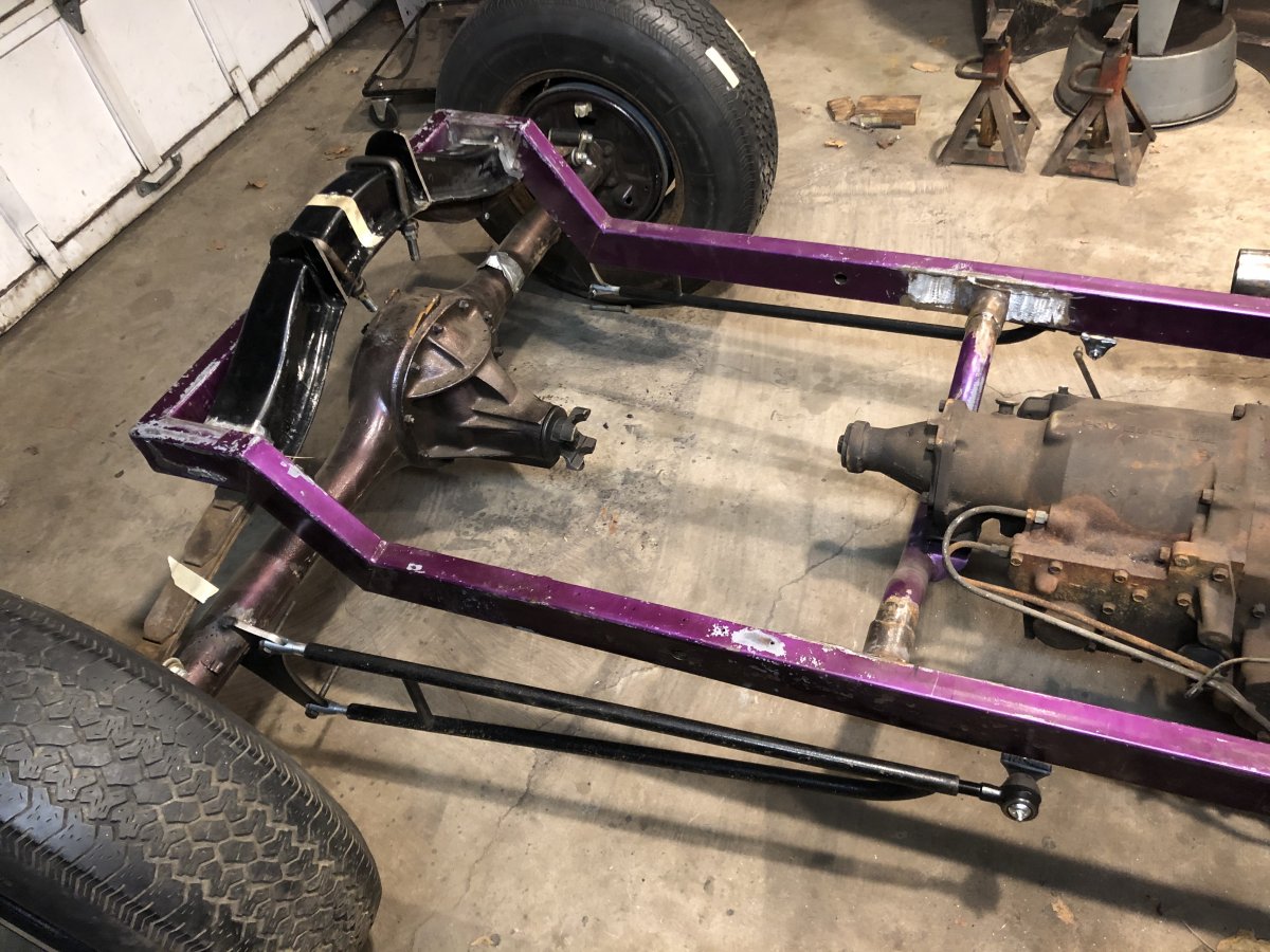

    The first order of business was finding a power plant. Chris at Millworks Hot Rods had a '64 283 and a cast iron powerglide hooked to it, supposedly out of an Impala that a customer gave him after upgrading to another engine. It was stuck from sitting but a little oil and heat and it freed right up. I decided that I'd blow the thing apart to reseal and re ring it. It actually looked great inside. I replaced all the rings and put a set of small chamber 350 heads on it as the original heads were destroyed from some animals using the exhaust chambers as a food locker. Also installed a Mellings cam.

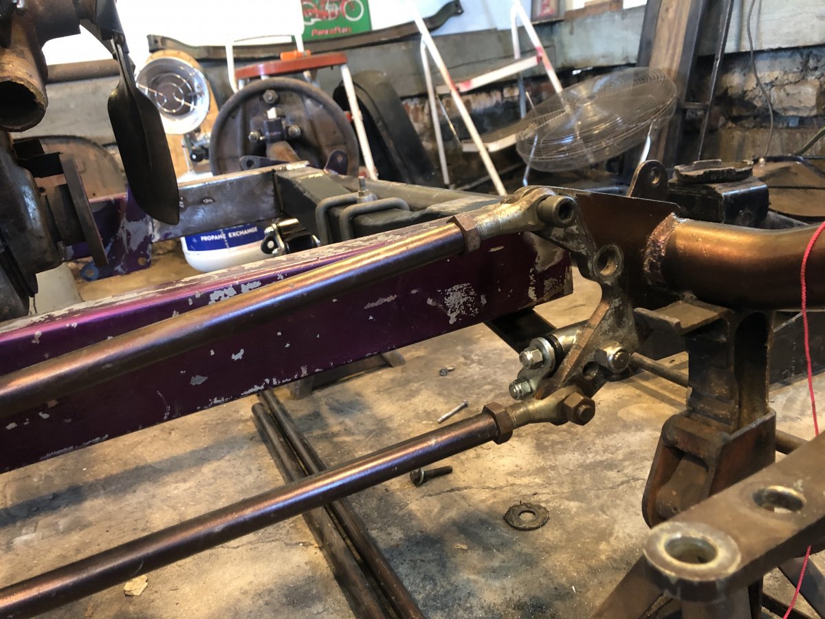

    After sourcing and refreshing the motor I started by hanging the rear end. I was going to use a four bar set up that came with the car but after a few mock ups it was obvious I should find a set of hair pins. A nice fellow I know from IG offered up a pair and I set to work installing them. Model A rear cross member was repurposed from a different build.
    Then I tried a couple different front end configurations but i was never happy with the "front forward" look that most dead men perches create. I wanted a nice tight wheel base and no excessive spaces between the firewall, motor, radiator and wheels. Honestly they can look great either way but that's what I wanted for this car.

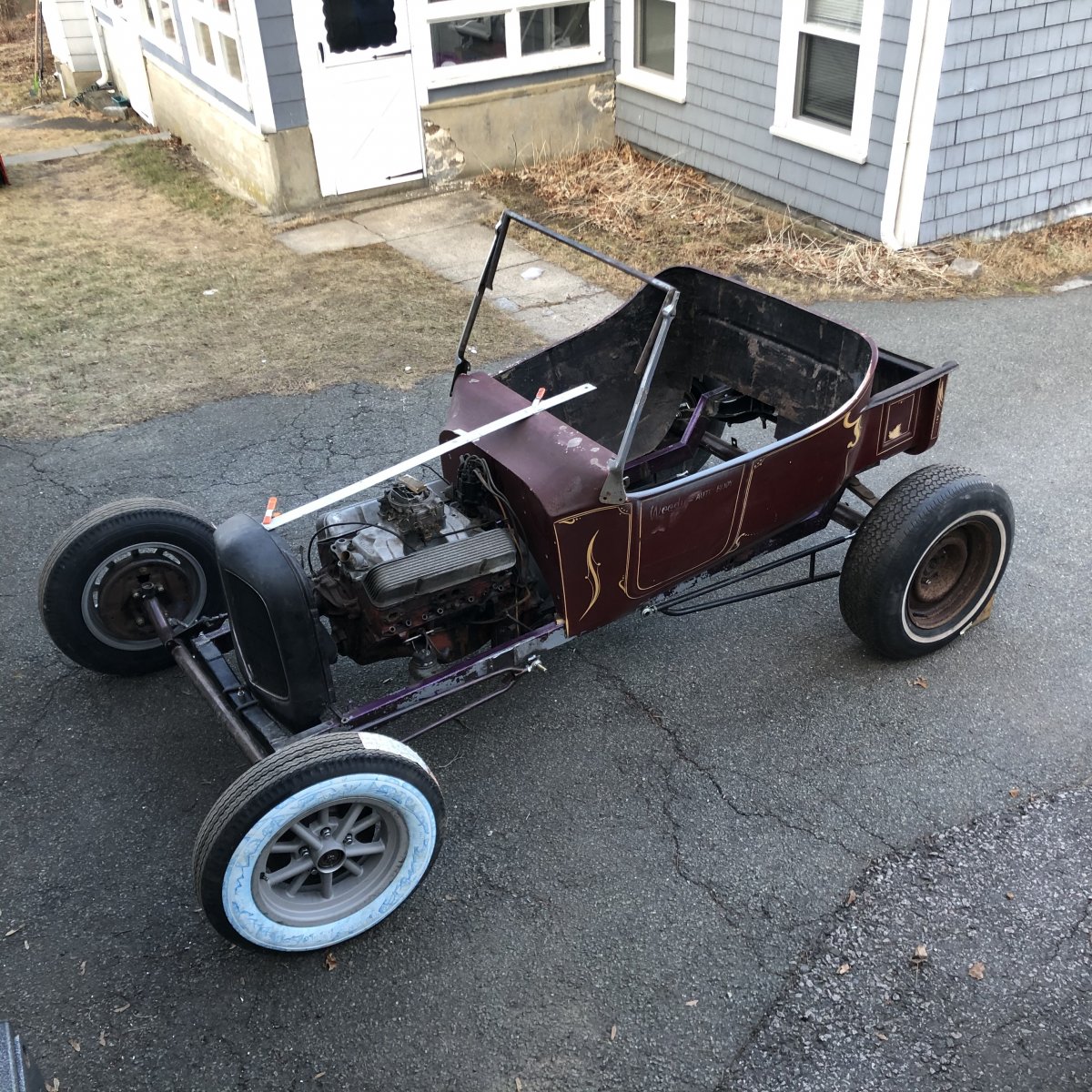

    Here's how it looked at that point. You can see in the second picture I had cut off the flat plate originally used as a front spring perch and tacked on a more traditional suicide mount.

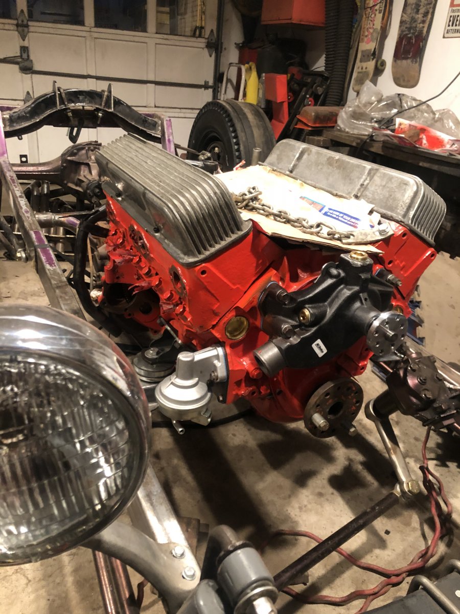

    And here's what the little 283 looked like in the car after a freshening up. You can just see the repurposed F1 motor mounts in the last shot.

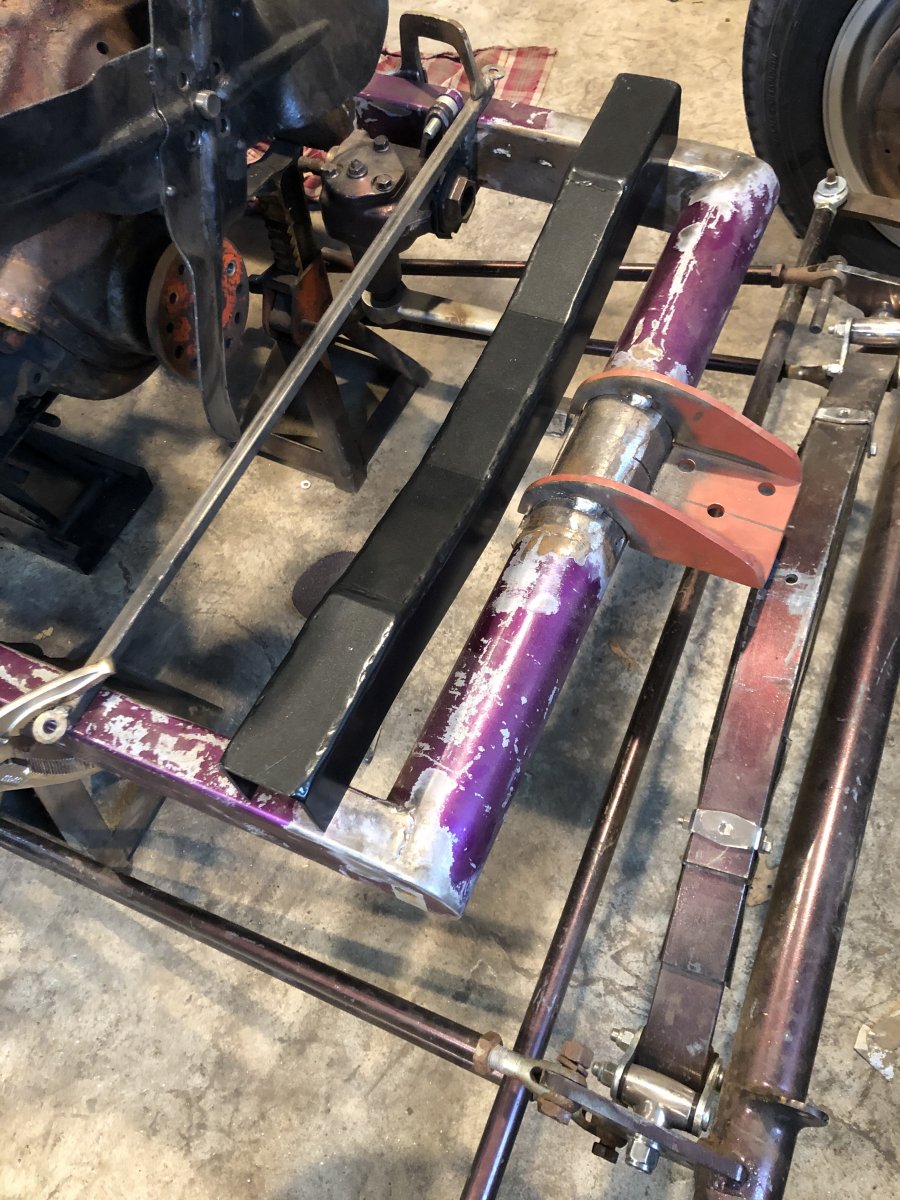

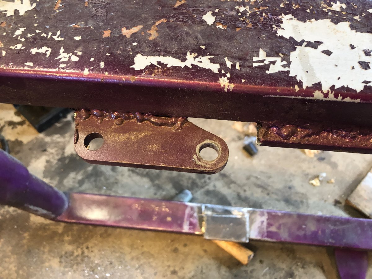

  11. Might I suggest you move the steering box forward so the arm is closer to parallel to the axle. :)
    dirt t, Lil'Alb, Vic Walter and 5 others like this.

    Thanks, yes. This was how it was welded in. I've already modified it so everything is more parallel. @rustydusty is this the kind of thing you had to fix too?

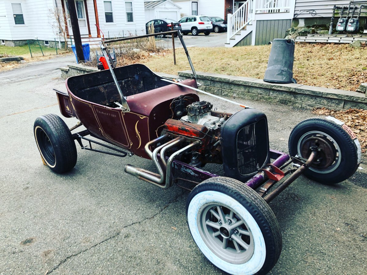

    It was at this the point where I decided to install a Model A Cross member instead of the dead man's perch. I figured it would pull the wheelbase in enough for my liking. I had already cut off and replaced every other mount on the frame so why not cut off the front end too? D5C80726-5309-466B-81FF-8E738C5C4259.jpeg B8FCA573-2A53-4E01-9AA7-39EBB575BBB5.jpeg 34DFD0DB-6506-4AD3-A666-410A91390AD4.jpeg
    You can see the difference this made in these photos. It eliminated the stretched out front end and gives it a much tighter wheelbase. It also shows the twelve spoke mags I decided to go with in the front.
