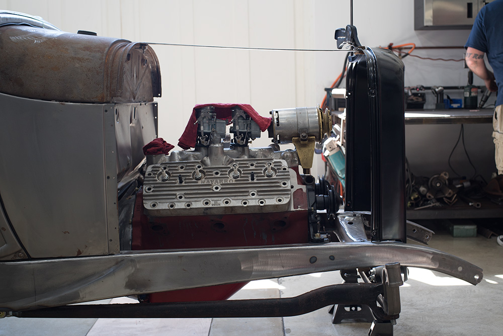

Nice build, I like the use of 46-48 wish bones. Can't find any dust, but it look like you caught a poltergeist in the third shot.

Do most big bore engines start with an 8ba block? And it looks like spark plug holes are offset? Is that due to bore? What a great shop! I think the new reality of "shops" is that they don't employ 25 people but instead serve their niche and turn out less cars but more quality. There are so many people building cars it's like they could have a match.com site for pairing you up with a builder that suites you best like Mr. Keith Tardel!

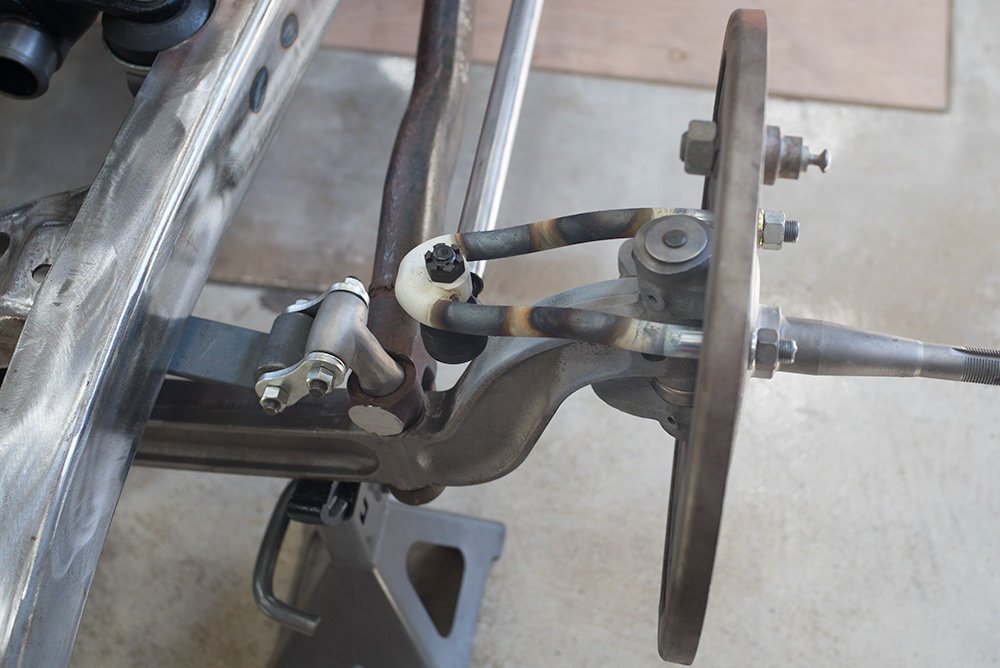

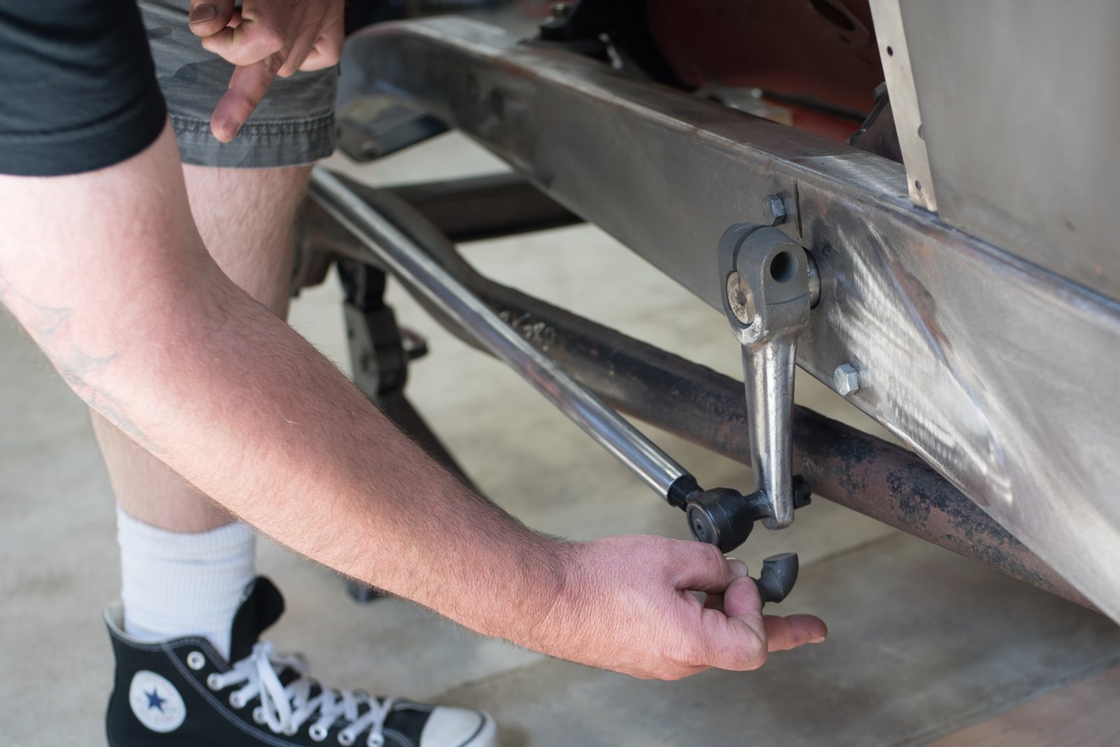

Today was a disaster in the shop. Keith's new sandblaster showed up and while he was busy assembling it, I decided to tackle the steering geometry. It all came crashing to a halt when Keith put his damned arm straight through the glass of the new blaster. He's an absolute bull in a china closet... I swear. Or maybe those roles were reversed a bit. In any case, here's what got done: Randy had some cherry rear Lincoln backing plates. Of course, they had the hole for the emergency brake. Keith welded them up and made fronts out of em. Once done, he pissed away some time by mocking up the deuce shell and getting an idea of placement: And then, he moved on to steering geometry. The F100 pitman arm was cut loose of its unecessaries and a tapered hole was drilled: Of course, that lead to all of the dropping of the arms on the backing plate end of the deal: And that's really about all that got done today.... Assembling and breaking Sandblasters can take up a good part of your afternoon in a hurry - even if you are a pro (at breaking shit). Anyway, this is really the first update post to this build and I'm wondering if I'm glossing over the specifics too much. I think I probably am... It will take me sometime to figure out the balance of covering the build vs. actually working, but I'll get there.
