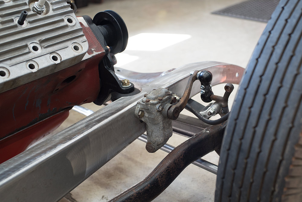

    In the pitman arm pic looks like brother Keith is sending brother Ryan a little message for outing him on the blaster disaster......................just sayin'.............;)

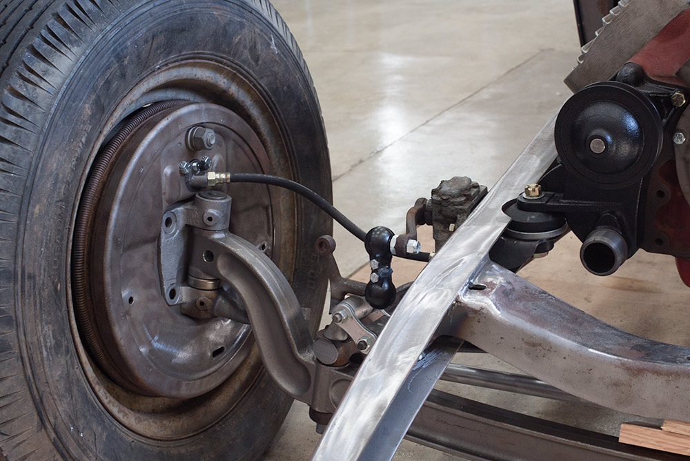

    have to question last photo in entry 25 - should check "ackerman principal". Also previous picture seems to have drag link at angle may increase "bump steer".

    The photos are not of a job completed, but of a process... Tardel paid his dues building ch***is's and his cars have the records at bonneville to prove that.

    Ya, I thought that might be the answer - but look at angle ( lack of ) on driver side tie rod arm. which it appears from the heated arm was just set. Just learning...

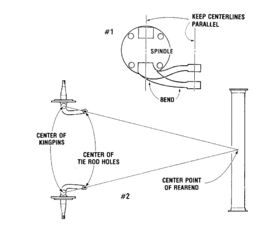

    Ackerman is far from being a precise science, or if you prefer, an accurate geometric angle. It is recommended that you have some Ackerman to prevent excessive tire scrub during low speed corner maneuvering. GM has not used Ackerman for several decades, and their cars exhibit tire scrub during parking lot maneuvers (I do not consider this to be desirable).
    The extrapolated lines of the dropped steering arms on the roadster in my avatar intersect somewhat behind the center of the rear axle (simply because the spindle ***emblies came from a donor car with a longer wheelbase than the roadster).

    agree ackerman important in low speed turns & not Bonneville. Watched a nice model t pull from lot in sharp right hand turn push driver side tire almost sideways - while driver struggled to turn wheel. I stepped away for fear he was going to push tire off the rim. People build cars like they see at shows only to find it not work on the street. One inch of front suspension travel is another show thing that not work on the street - and that without bump stop. Same thing with steering box placement and steep drag link angles - creates bump steer when hit a bump. Drove one that loved to dart to side after a bump. Many rods use parts from cars not perfect fit for the rod. Part of the build to make it better; or live with the results. Have to build to intended use. Drive it or push from enclosed trailer to show field.

    Wishbone to frame attachment establishes kingpin caster angle, not Ackerman. Drag link angle relative to wishbone angle is critical in avoiding built-in bump steer. New guys starting a build - can't stress this enough - do your homework on basic steering and suspension design before you pick up wrench or torch. Study other's good designs and other's bad designs, and ask lotsa questions. Over my 55 years of doing this stuff, I've encountered far too many unsafe modifications made in ignorance! And some of these appear on the front covers of several well-known car publications. No matter how much money is thrown into that car, how detailed it is, how pretty it is, how powerful it is, how much rubber is under it, etc., if it does not track properly while driving it, it will be no fun to drive, and see very little street time. Build it correctly from the git-go.

    For those that are better visually, there's this:

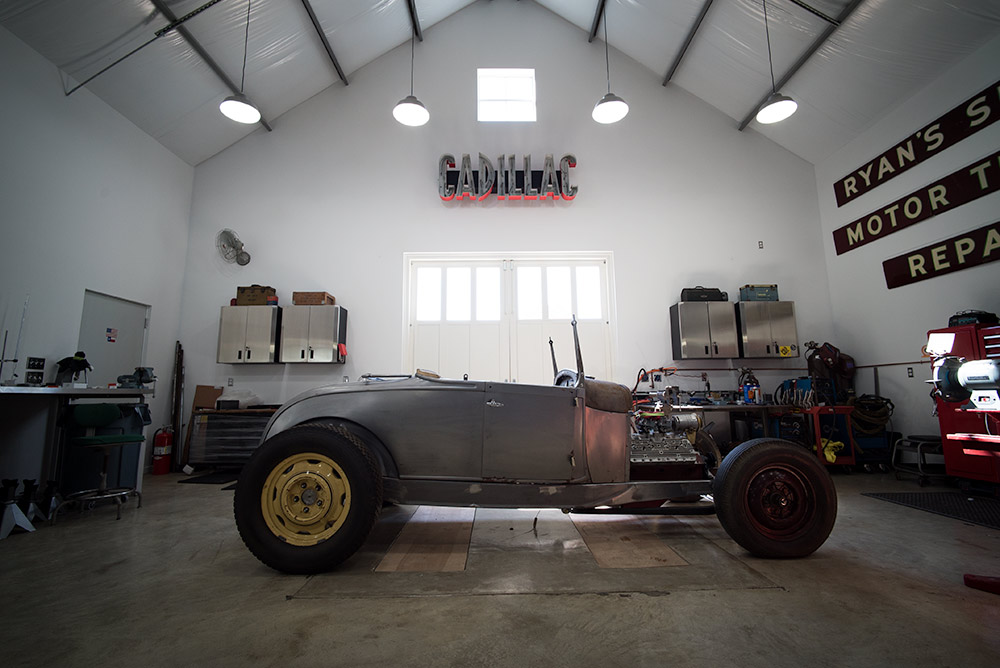

    Screw that guy with the funny name that came up with all that nonsense about angles and what not... Let's get to today's updates, shall we?
    Essentially, Keith ****oned up the steering and suspension mock up. Little things yet to do here and there, but they can all wait. This thing needed to be on all fours today.
    And one taken with a grossly wide angle lens that offends the proportions of the car, but shows off the space:

    what are the wooden panels in the floor?

    Holes where a lift is gonna go eventually... or maybe the entrance to an underground bunker. Preppy Prepper. Let your imagination decide.
