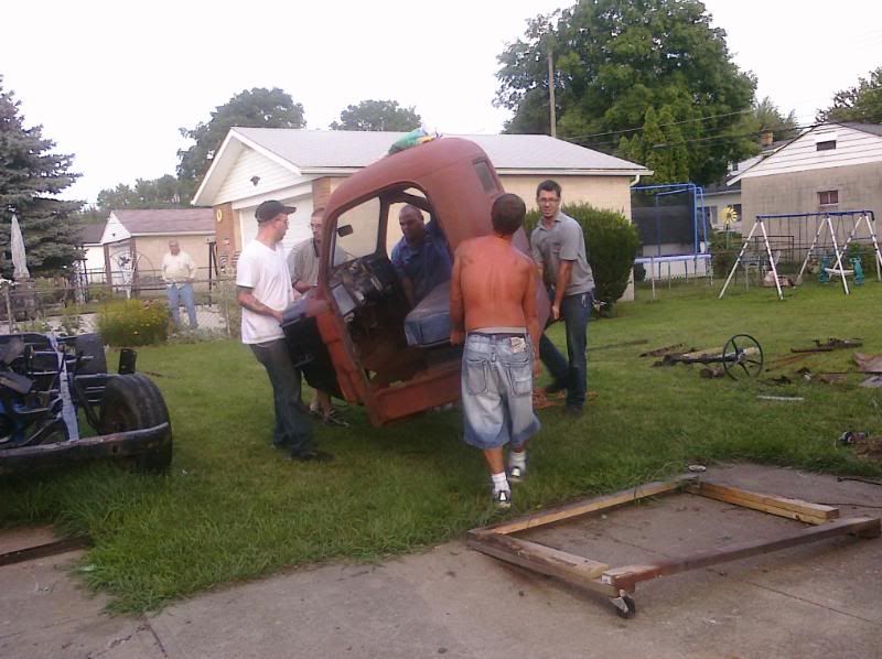

  5. NikkypDMC
    Joined: Apr 21, 2010
    Posts: 257
    NikkypDMC
    got the cab on! hopfull have the rest of the body on and intake/exhaust built soon!

  10. ironandsteele
    Joined: Apr 25, 2006
    Posts: 6,102
    ironandsteele
    i love that in that series of pictures you can see two different neighbors watching as you guys lugged that cab on the frame. hey-how bouts a hand?? ha.

  15. NikkypDMC
    Posts: 257
    NikkypDMC
    ha ha ha ha ! i know right!
    how dose the old saying go? " two men watchin' 1 man workin'? ha ha
