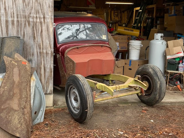

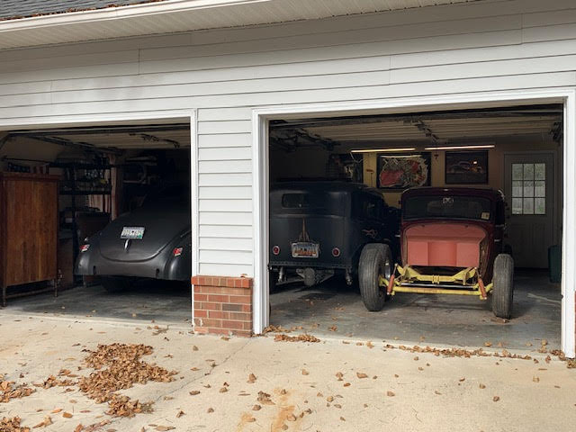

    Finally getting around to getting this pile in queue. I drug this 'ol girl out of a barn/garage in North Carolina a year or so ago.

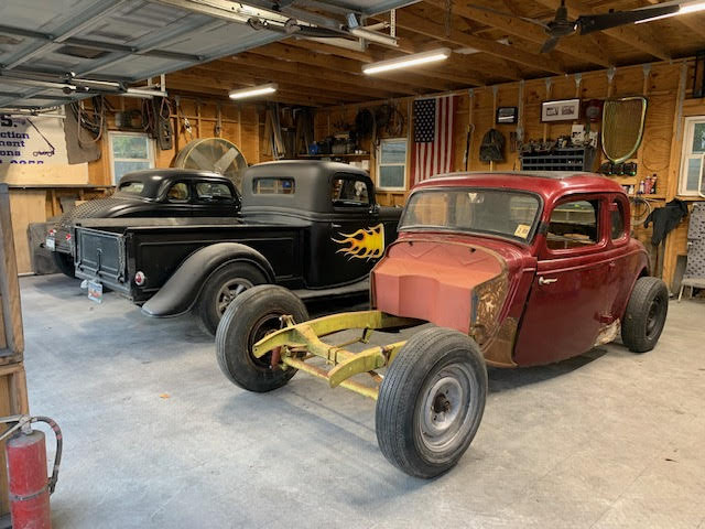

    The car has been squeezed into my garage and my Model A was not a fan.
    The fella I got it from rolled it in the garage, torched the floor out of it and realized that once you do that, the car is basically ****ed as the body is only held on by the roof.
    At least they installed some sweet 1/4 panels.
    Not sure why, the OG 1/4s were cherry.

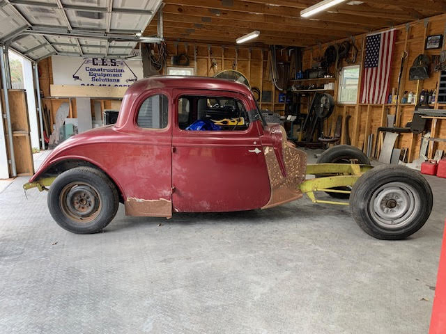

    About the dopiest profile you are ever gonna see.
    Here she is, her new home for the next two years or so. This little car is going to be a low budget driver with some sort of engine/transmission and rear end, but exactly what isn't nailed down yet. I'll let you know as soon as I know.
    See ya, -Abone.

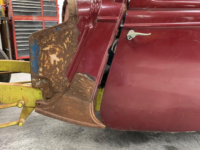

    So the goal is getting some structure in this floppy pile of ****, so off with the body.
    Didn't take long as the only thing holding it on were a pair of these screwed into the B-pillar wood and held onto the frame with gravity.
    The door gap tells you that the roof is the only thing holding it all together.
    Weld the doors in the hole and start squaring things up.
    Nothing structural at the cowl.

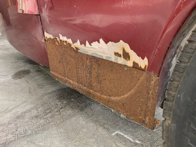

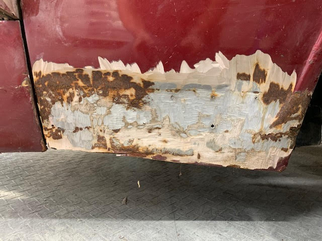

    Wheel wells fit right in there, but the whole back of the quarter was made of Bondo and hopes and dreams.
    Made some panels and beat out a bead.
    This 1/4 was hammered. bunch of big holes and stretched beyond my ability to repair.
    Still a bit of hammer and dolly work, but the structural part is good.
    Here's the whole thing tied together.
    Wheel well in, ****ty 1/4 next.
    Just how they did it back in the day. Rivets, roof flashing and Bondo.
    This was the easy side for sure. And just like that, the back half of the car is made of metal again.
