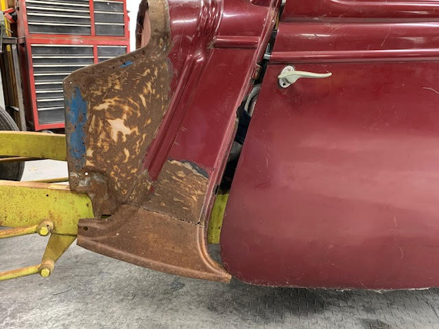

    Still in metalwork mode. Here is this weeks exciting episode.
    Rotten lower cowl.
    All back together including the subrail.
    The drivers side was multi-layered rusty ****.
    So, we talked earlier about where panels come form. Here are three different lower cowl panels from three different vendors. Can't swear they all come out of the same press, but it sure looks like the same dude writes on them.
    Drivers is pretty much the same as the p***engers, plus another pic of the world famous FlamedAbone U-Weld It Subrail Kit (tm).
    Somewhere along the line, somebody decided to street rod the hell out of the poor unsuspecting cowl vent.
    But wait...all might not be lost. Looks like the OG lid might be buried under there somewhere.
    Like all the other work on this poor little car, if you dig under the Bondo, you find very few welds.
    Holy ****, this part is pretty good.
    And the lid is OK too. Yea!!
    Next is the door bottoms and that will just about wrap up the structural body work.
    See ya next time.
    -Abone.
