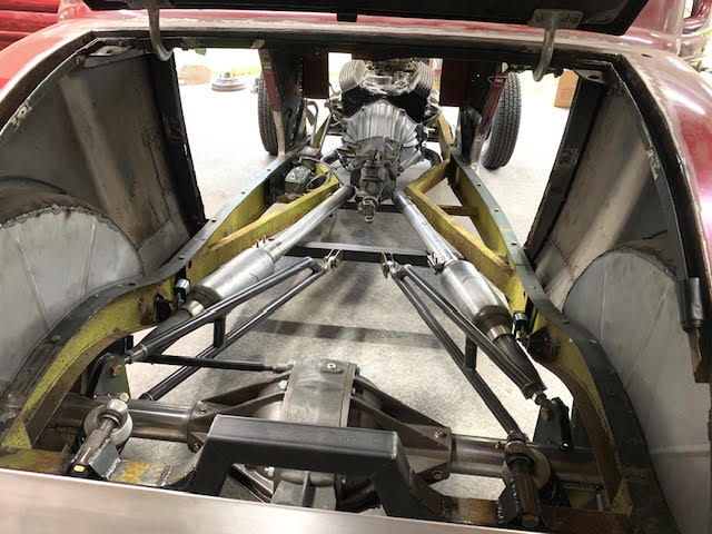

    Rear ladder bar kit.
    And there you go, the FlamedAbone US Military/rock crawler/monster truck style ladder bars. Good for about a 1000 horse more than the little small block makes.

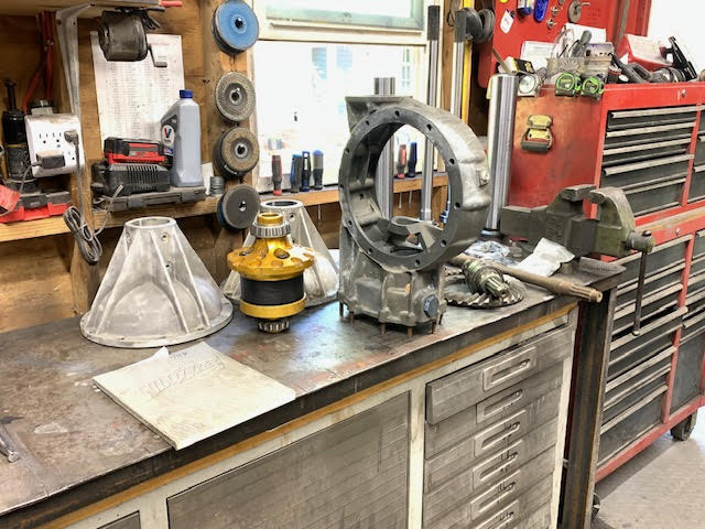

    Now, the fun part. Quick changes are super simple to set up.
    Start by chillin'
    And grillin'
    Slam the two together and drill the retaining bolts.
    Cook the center section and install the pinion and lower shaft.
    Start ***embling the guts
    Shim the whole ****eree to 12 thou.
    Do the shim dance until you get 4 to 6 thou of pinion back lash.
    Real Magnesium Color, Eddie?
    Nuttin but the best, Clark.
    All together
    The 8 inch and leaf springs gotta go.
    Better already.
    Monster truck ladder bars ready for action.

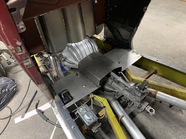

    I'm sure there is an exhaust kit for a '34 Ford with a Chevvie, but I'm a roll your own kind of guy.
    Work around some obstacles, but nothing major.
    Man, this sure was a lot of hard work. It was..... exhausting.....
    Now for the shin catcher.
    Adios, mofo.
    Carve it up until it looks like it is supposed to.
    A little more high and tight.
    Shows off the quickie a bit.
    Not sure of the origin of this fire wall, definitely some sort of re-pop as it has a BIG *** distributor notch.
    Some of it had to go to fit the little Chevvie motor.
    And there you have it and not a single in progress shot. And, I'm out of welding gas, so tacked is all you get. Use your imagination and pretend that it is fully welded and metal finished.
    Next up is floor boards.
    See ya, -Abone.

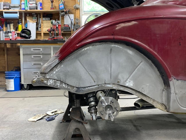

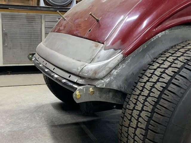

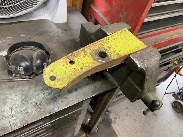

    That *** end came up really well. Nice job. @flamedabone did you cut that rear bar a few times to get the curve in it or bend it another way?
  14. flamedabone
    Joined: Aug 3, 2001
    Posts: 5,758
    flamedabone
    Yep, that is a cut and weld job.
    -Abone.

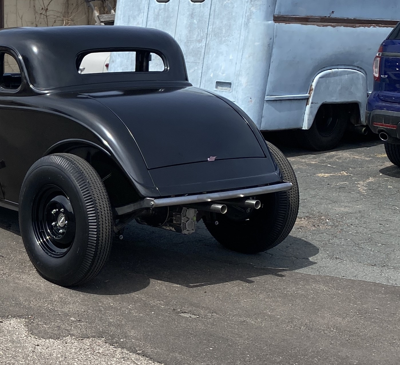

    My Pop's coupe has a similar rear treatment, but the flange is removed.

    Alchemy, your Pop's coupe is a bad mofo.
    -Abone.

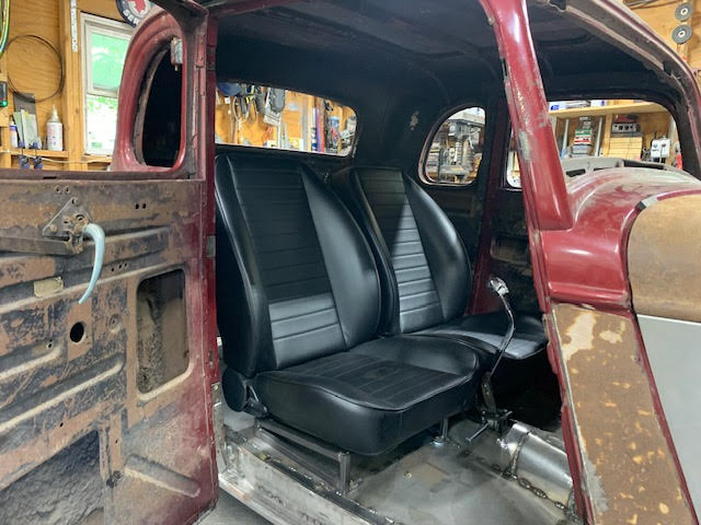

    Floors aren't very exciting, but you gotta do em. I like to start just forward of middle to give the toe boards and trans tunnel something to weld to.
    Then, I like to finish the whole project and forget to take any pictures.
    Once the floorboard is done, that ****er is a whole car.
    From the FlamedAbone, Primitive Yet Functionable Collection (tm), here are the seat mounts.
    And, a set of store bought buckets. Yea, I know I'm kind of a bench guy, but I thought I might switch it up a bit for this one.
    The little car is now mostly mocked up with all the sheet metal attached, so that means this is probably the last pic you will see of the stock roof. All you " don't chop it" guys should quit looking at this thread, because I'm fixin to whack this pile.
    See ya, -Abone.
