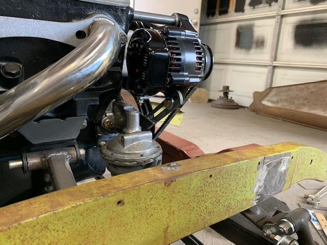

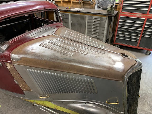

    The old alternator bracket was bugging the **** out of me. I got it down nice and low, but I was going to have to run an electric fuel pump, which I am not a huge fan. So, I built another set up that allows the stock pump and the alternator to co-exist.
    Up a bit higher than the old one but it misses the pump by a good bit.
    Fortunately, that ugly ******* is pretty much covered by the fender apron.

    Looks like that lower rad hose is going to be a lot happier.

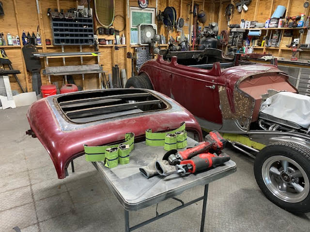

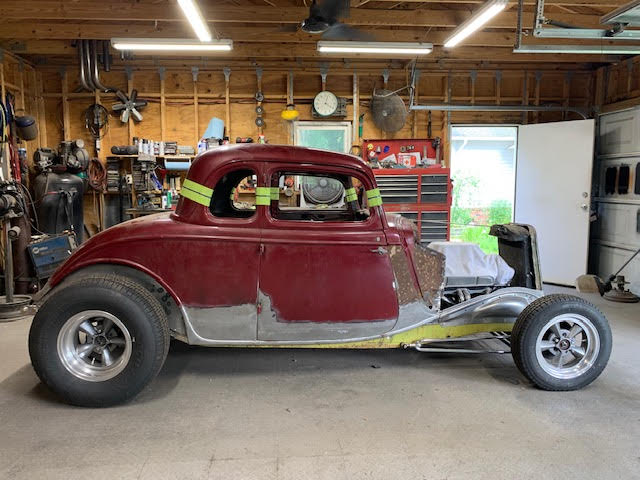

    This is fixin to be an *** load of pictures and all of the "don't chop it" guys should turn back now.

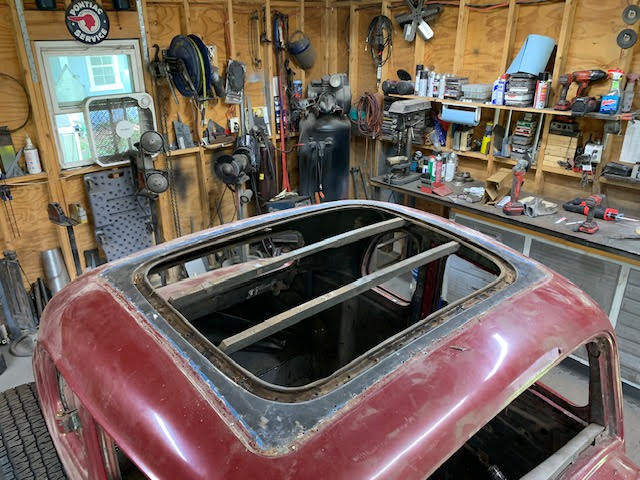

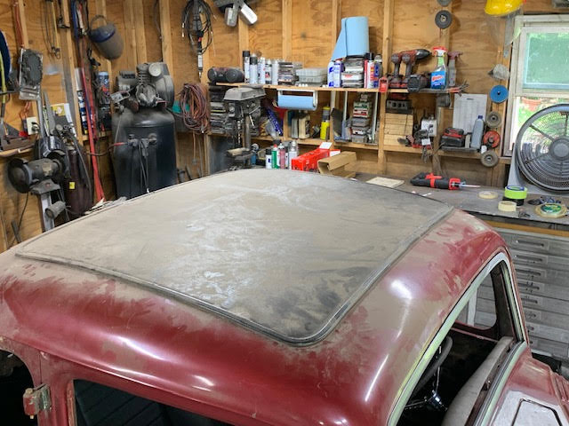

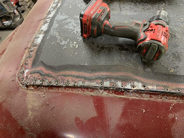

    Somewhere along the line, the roof got a fake soft top kit.
    Held on by 76, 843 rivets.
    Pretty decent roof opening underneath.
    Last chance...spoiler alert...

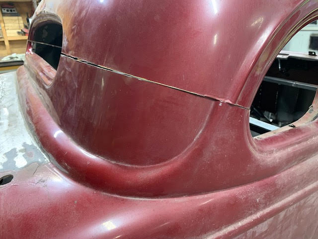

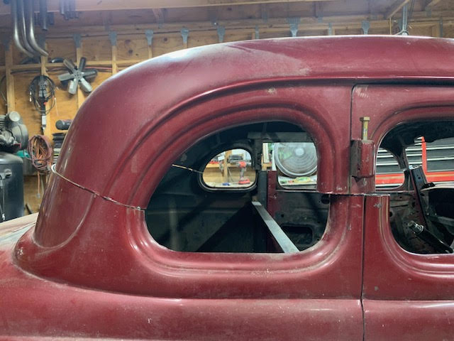

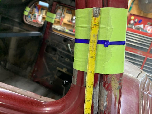

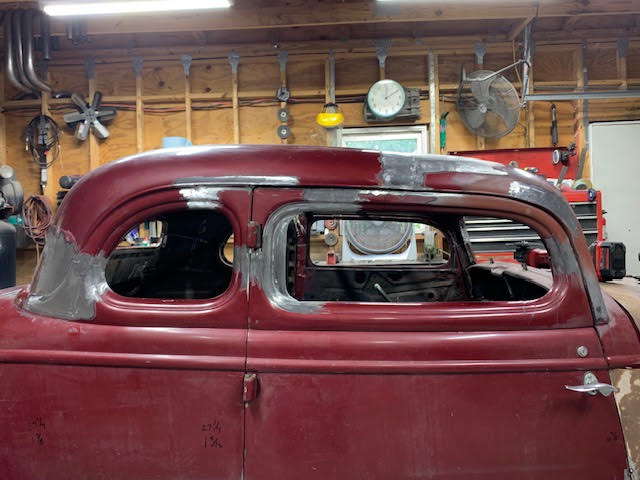

    Modern 2 inch tape doesn't measure 2 inches anymore, so you have toss in a little pinstripe tape or you might end up with a sissy chop rather than the 4 big ones.
    There are lots of different ways to cut a 34 and lots of fancy ways to do the rear window, but I'm a bit of a caveman, so there you go, right through the middle.
    Way better already.

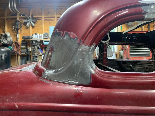

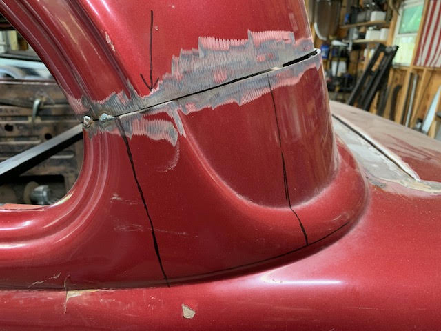

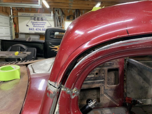

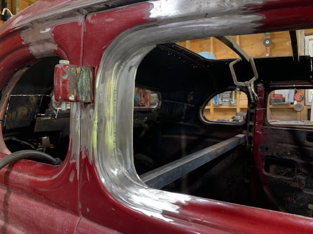

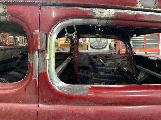

    There are a couple ways to do the quarter window and this is the point where you have to make a choice. For this chop, I lined up the very rearmost edge of the roof.
    That method, like all the rest has some consequences. Now your B pillar doesn't line up.
    But here is where the magic happens. Looks like a bold move, but it is actually pretty simple.
    See, that wasn't that bad after all.
    And that gets the rear section in its new forever home.

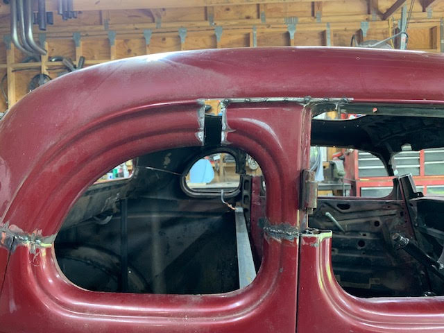

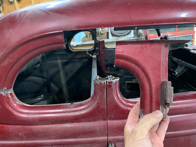

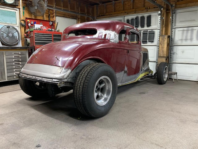

    Here is one I didn't see coming. The stock roof had a pretty big gap between the A pilar and the door top, but when I lined up the roof forward and the door backwards, it made it ever bigger. Yikes!
    Moved a chunk of the roof and added a bit to the leading edge of the door top and she's all better.

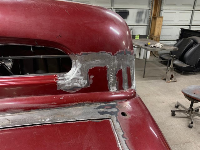

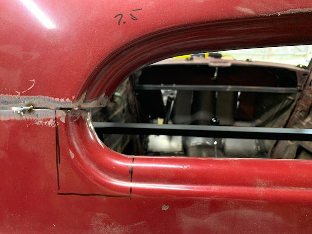

    This style of chop leaves the roof body line a bit goofy.
    Cut that ****er out and move it forward.

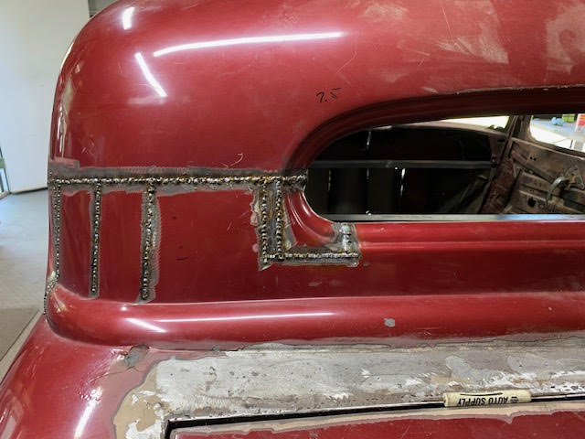

    The rear window gets a bit buck toothed.
    Same deal, cut out a skooch it over.

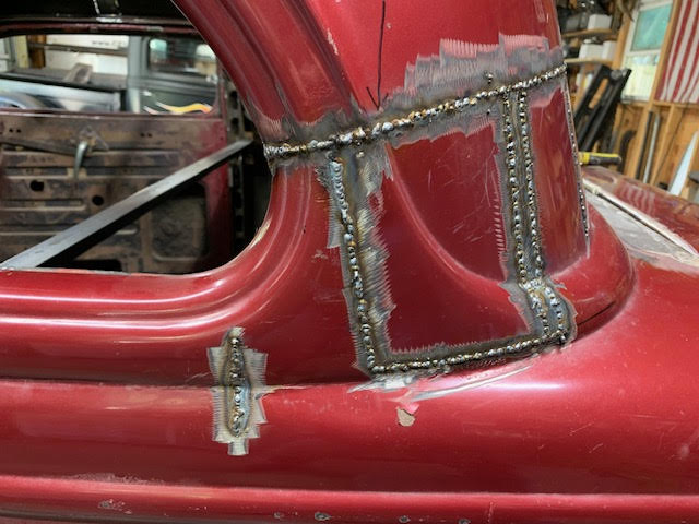

    Some of you sharp eyed HAMBers noticed the p***enger door was a '33.
    Now identifies as a '34.
    Tacks ground.

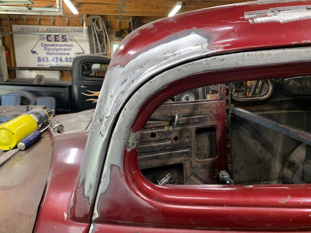

    Finished 1/4 window.

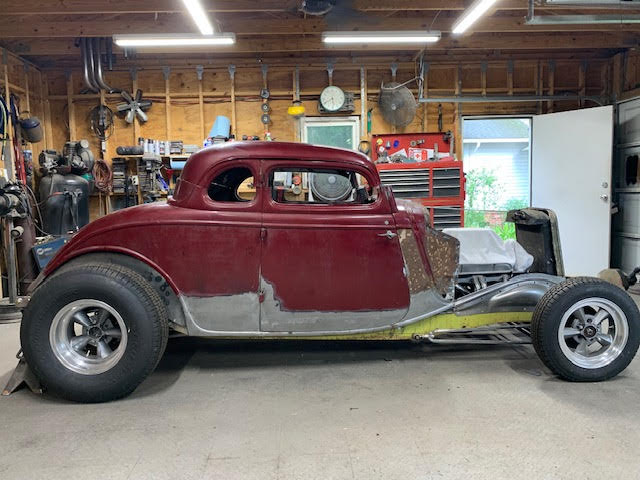

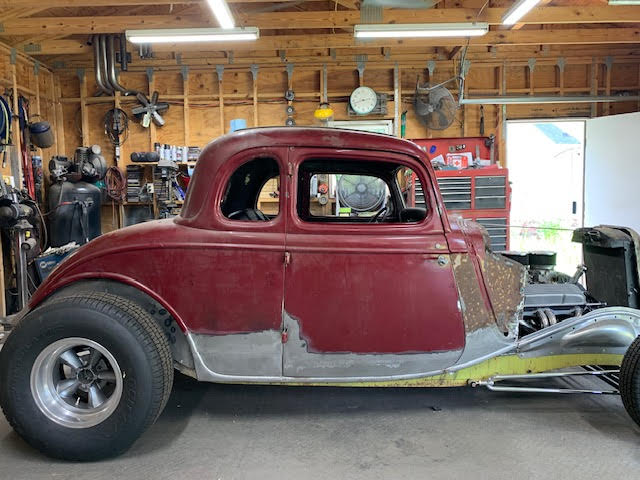

    Everything needs finish welding and a bit more metal work, but this is the general idea.
    Done for the day.

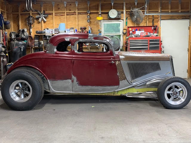

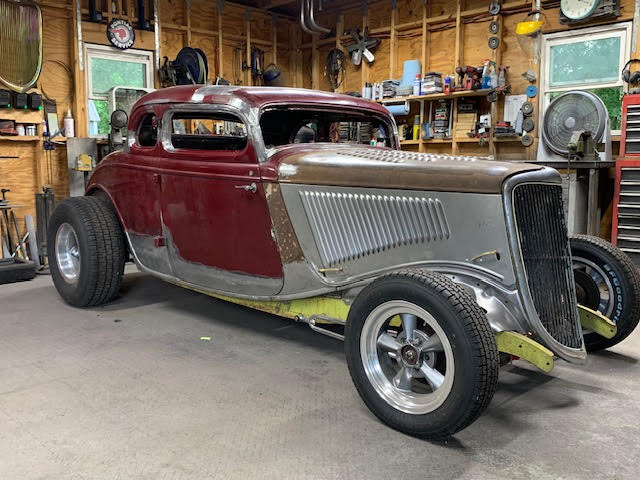

    3/4 front.
    Everybody has their own opinion on what a chop should look like, but this one ended up about right for what I was going for.

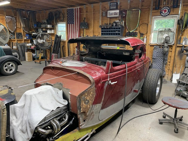

    The hero part of the chop gets done in a weekend and you stand back and think about how cool you are. But, there is another good three or four weekends of mindless tiny patch panels, meticulous welding, grinding and shaping. Some of it, like the roof skin and garnish moldings aren't too horrible, so here they are in all their mediocre glory.
    A 1995 Caprice gave its one and only roof to live on in something a bit cooler.
    Trim it just a tiny bit larger than the hole.
    Weld that ***** in there. Yea, I know the hard core traditionalists will accept nothing but an original roof, but I did that on the last one and will again on the next one. Just not this one.
    A kind HAMBer from Cleveland, Ohio came across with a nice new windshield frame.
    On to the pile of garnish moldings.
    The 1/4 window moldings are extras from my old '36 coupe, which are pretty close. I'm sure there is a '36 guy cursing my name right now. Real sorry.
    See? Fits right in there.
    I like to cut the door garnish at the corners.
    If you do it right, it leaves a pretty simple seam in case you are heading to the chrome shop with them.
    Don't forget the rear window.
    Same pile of moldings, all just 4 inches smaller.
    And here is today, all garnished up and a windshield that cranks out. Not sure what is next. Probably something.
    See ya, -Abone.
