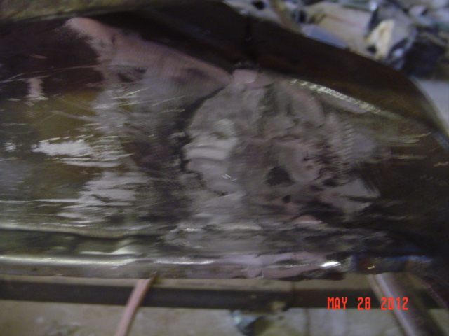

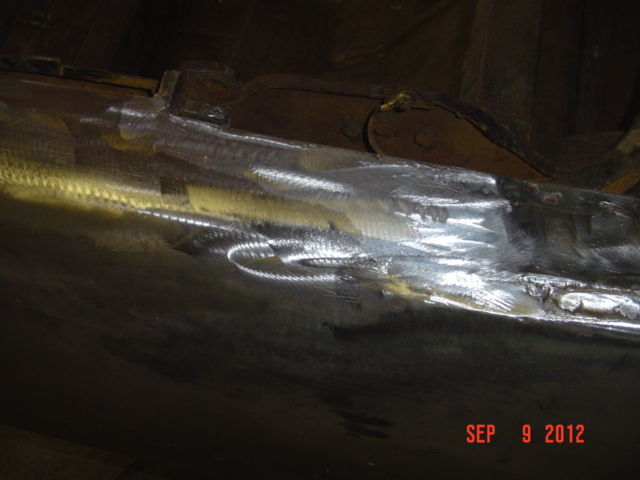

    I needed a small amout of filler where I had welded one of the patch pieces in, so I broke out the solder and paddles. Some folks like to use tallow, but I have always used motor oil or auto transmission fluid to keep the paddles from sticking. Here I applied the lead, and filed off the excess. While I had the supplies out, I re-soldered the seams where the factory would have.

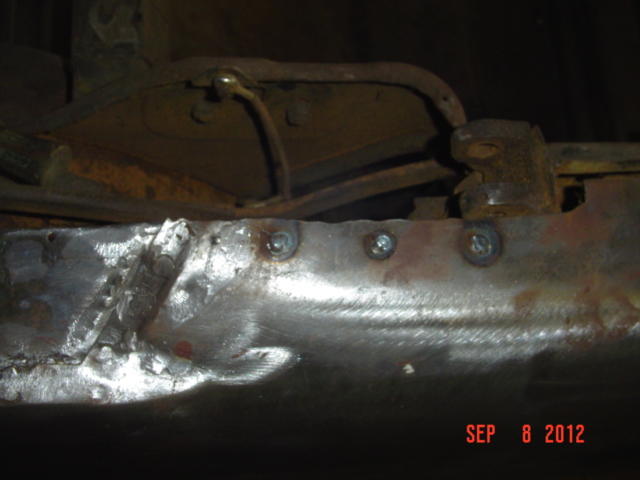

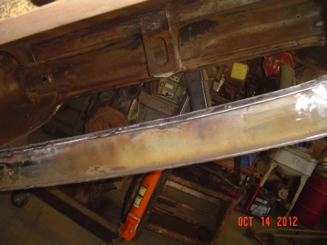

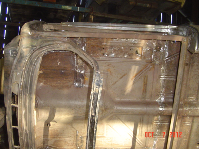

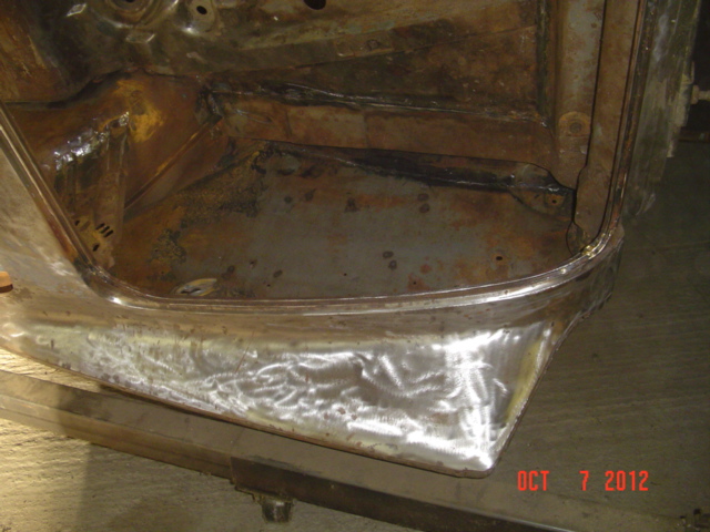

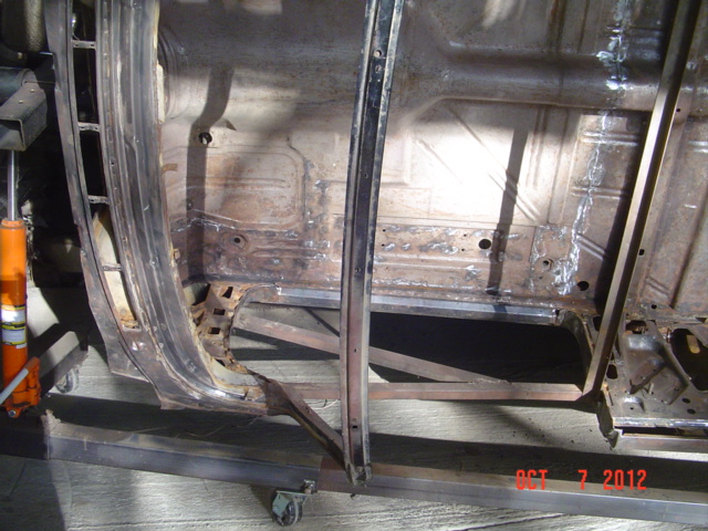

    More grinding and cleaning of welds continued on the bottom of the car, just about done with that part now. I probably have about 120 hours in that work alone in this project.
    Quarter panels are now quite straight, as the bare metal shows. I still have a lot to do on the top side of the car yet, I will sandblast the body when the metalwork is complete, and then get it in primer to work on the ch***is.

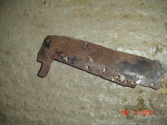

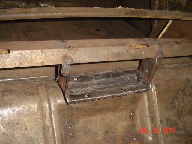

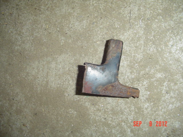

    Next step was to find or fabricate the convertible top motor mount. After searching for several years, I found any convertible in any salvage yard would only be sold complete, no parts. I even checked with some of my Swedish friends, and none had anything like it to spare.
    Oh well, I guess this isn't the first time I hit a roadblock. The piece I needed was rather an intricate stamped part, so I set about making a decent replacement. I thought about what I may need, and it turned out I had the supplies right here.
    This is the original Mopar part once separated from the car-

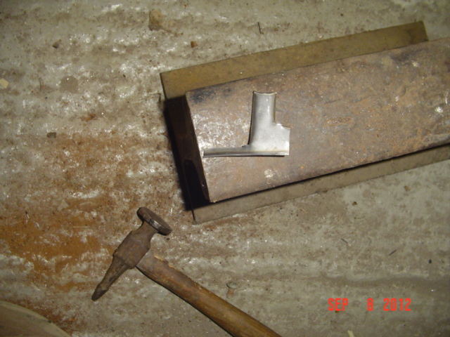

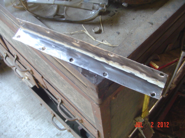

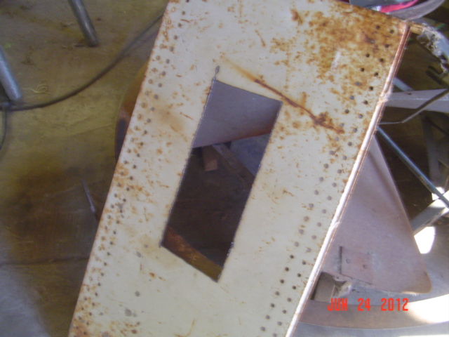

    I found an old store shelf in the junk bin that was the same gauge steel as the old base was. I made a few measurements, and cut a section out.
    Next, I used a small hand brake to make the 90 degree bends needed.
    For the center dipped section, I cut a section of an old steering column mast jacket from the s**** bin, heated and formed the ends on an anvil, and welded it into the previously cut shelf section. Another piece was cut for the rear moun, and the ***embly was reinstalled.

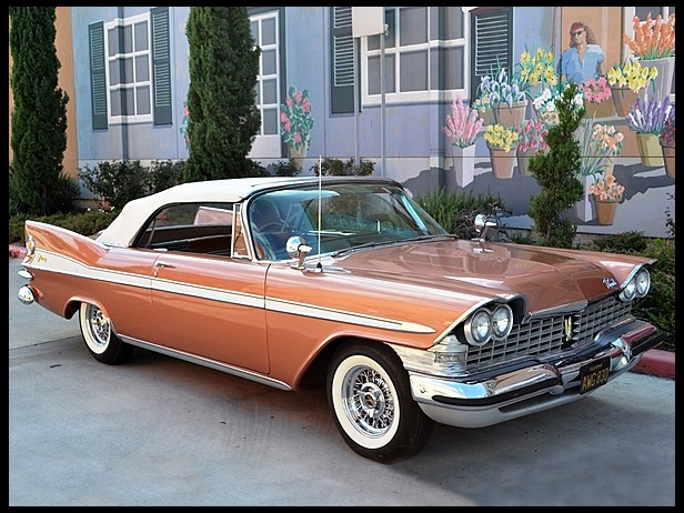

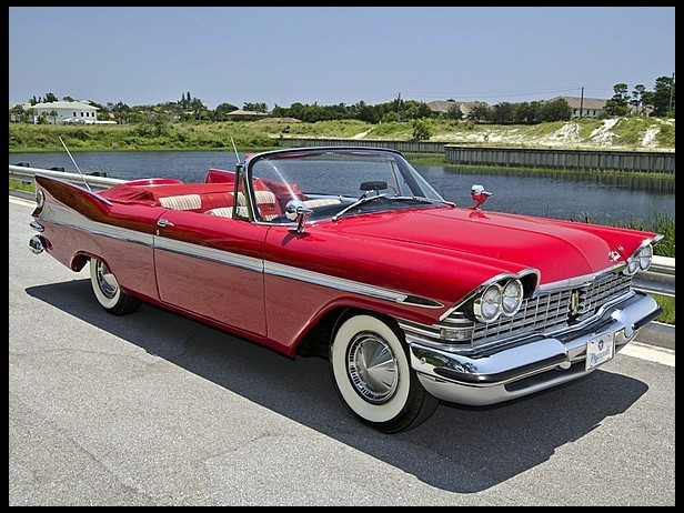

    Bob (The37Kid) -
    Here's an example that sold for $78.5K at auction last year:
    ... and an example that sold for $53K at auction last month:
    That said, why should it matter how rare or valuable a car is?
    Maybe it's just me ... but I'd like to think that most HAMBers (including you, big M, & myself) aren't in this hobby just to make $$$ on our project(s) ... but rather are a group of individuals that enjoy preserving Automotive history ... be it the restoration of a "Forward Look" Mopar, the re-creation of a historical racecar, the building of a traditional Hot Rod or Custom, etc., etc.

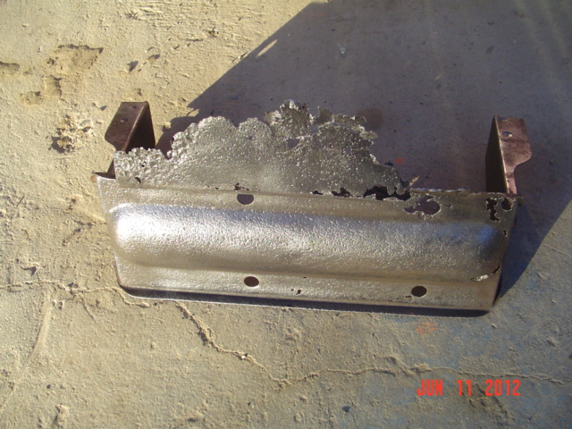

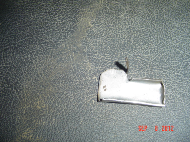

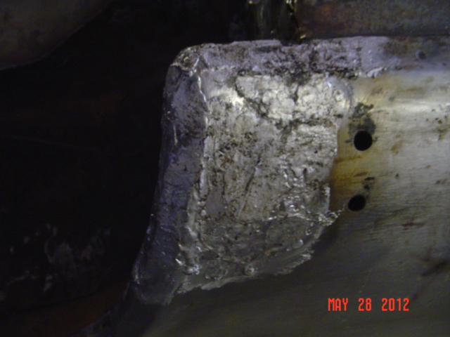

    Tidying up the convertible top well, I had saved the end caps that mounted over the main top rack pivot. The one was a bit far gone to use, so I fabricated another from a piece of 18 gauge steel. Next, I **** welded it on and ground the welds down.
  28. big M
    Joined: Mar 22, 2010
    Posts: 709
    big M

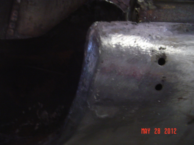

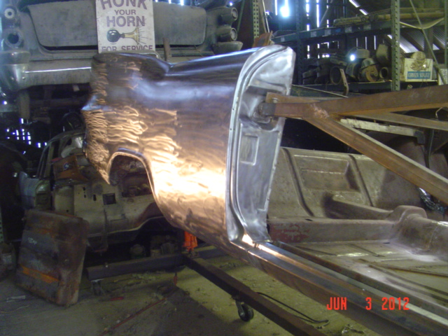

    I paddled the lead back into the factory seam, and used it to fill some small imperfections. After smoothing out the edges, I was ready to do the same to the opposite side. The original end cap turned out to be solid enough to use, so it was **** welded on, and the repair finished in the same manner as the first side.

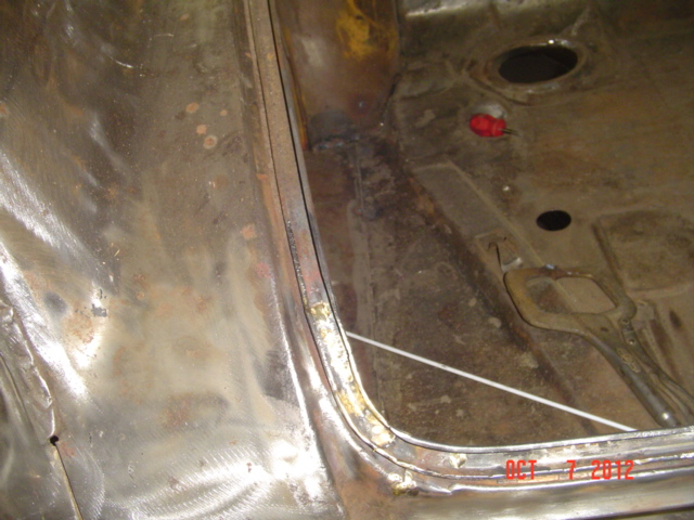

    I cleaned up some of the prior welds, then moved on to the trunk weatherstrip gutters. The seams had rust issues, and there was a section that was dog-eared from the rust. I decided rather than replacing these channels, to repair them instead. I used brazing rod to build the edges up and strengthen the weak spots, then cleaned them up using a carbide burr. I also removed the old remnants of seam sealer that had cracked and was coming loose.

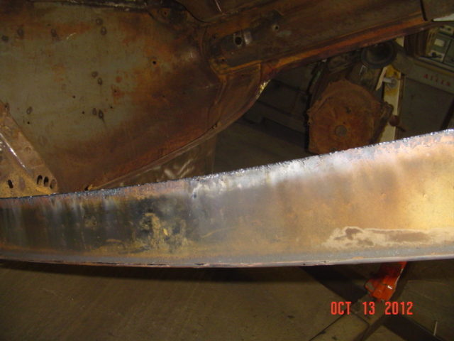

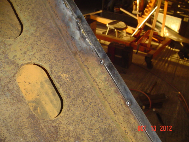

    The drain channel for the convertible top well was basically rusted away, a body pick revealed it was too far gone to repair. I had just brought a few '63 Chrysler 300 converts in the yard, but after checking, I found the curvature of their drain channels to be all wrong.
    I proceeded to find a sheet of 14 gauge steel, and cut a light arc out the width of the channel. Then I cut away the badly rusted original channel from the body. After cleaning up the edges of both areas, I cut another piece to make the side portion that would later be welded to the body. The side piece was welded to the arced lower piece, heating, and bending to form the same arc as I went along. There were a couple holes in the rear of the channel that needed repair, so this was done before welding the new lower channel into the body.
    I took time on this, after doing all the floor work, the last thing I would want is water draining into the p***enger compartment or trunk.
