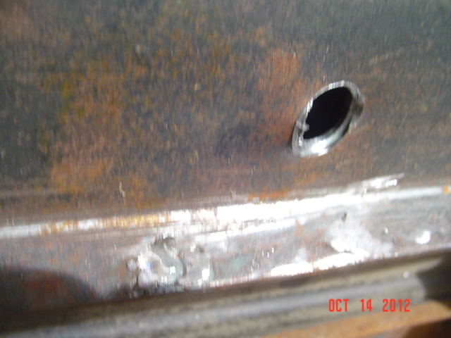

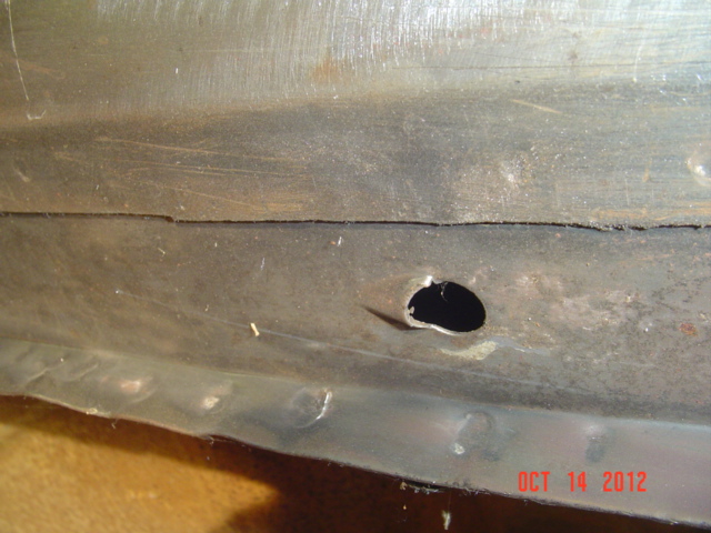

    I drilled the holes for the rocker molding clips in the new rocker panels after measuring them on another car, then I drilled he drain holes in the bottom of the rockers. These were swaged at the front to help draw dust and dirt out while going down the road.
    I made a tool for use with a slide hammer to replicate the factory swages.
    ---John

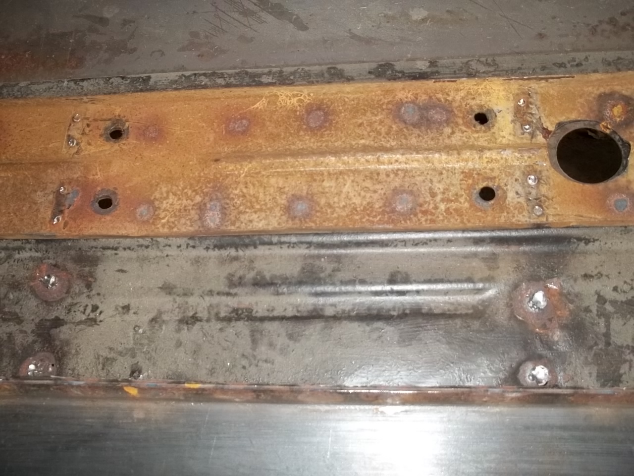

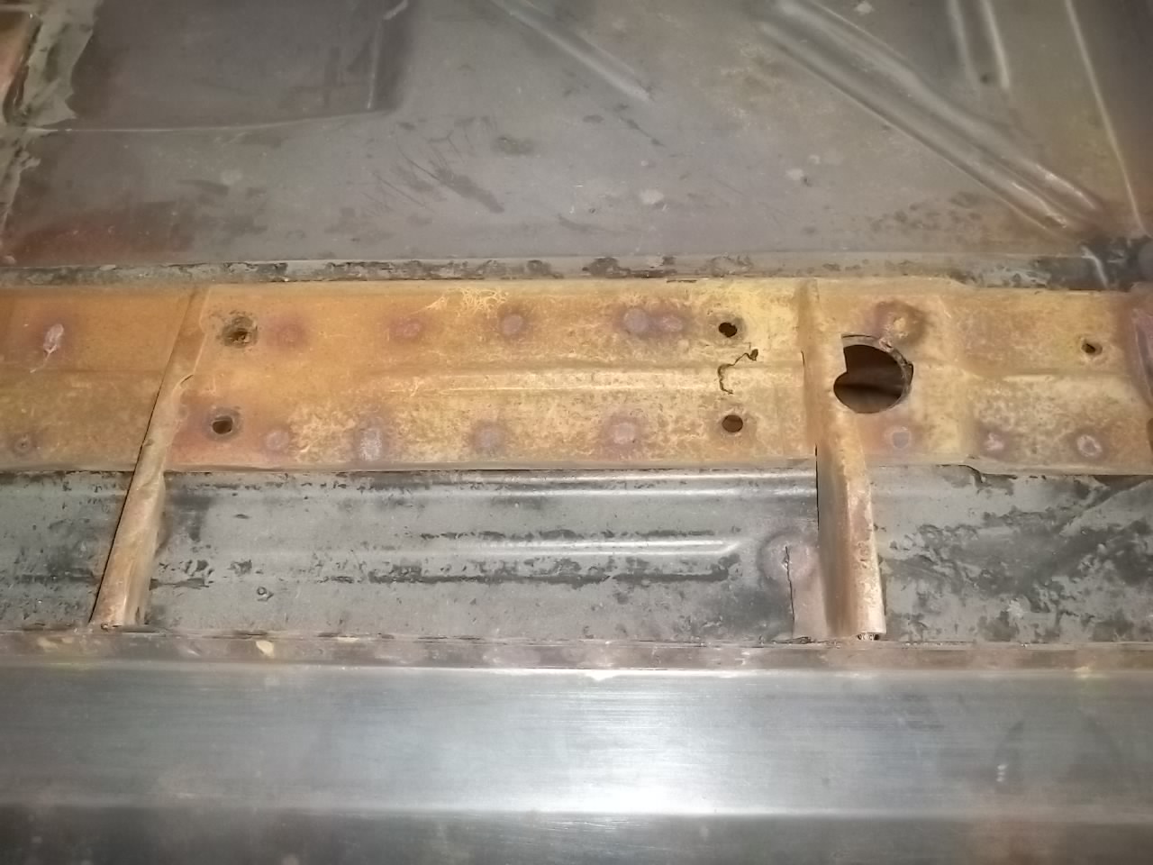

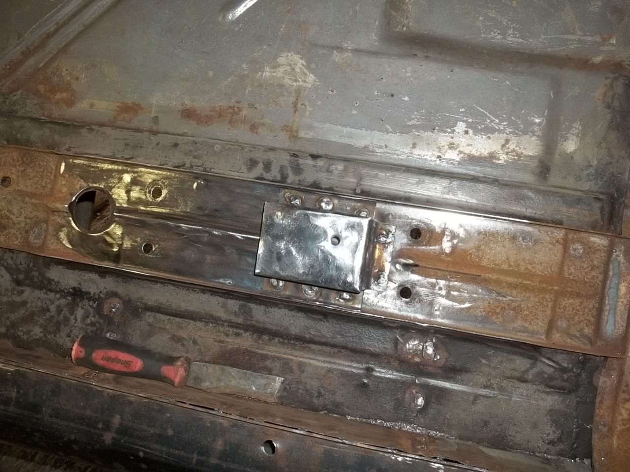

    '57-'59 Mopar convertibles all use a special body mount beneath the seat reinforcement, that replaces the outriggers used on closed cars. I made measurements from a factory mount on my unrestored '59 Desoto convertible, and proceeded to make them.
    These are 14 gauge, and have a threaded fixture for mounting to the body.
    After removing the outriggers, I installed the new mounts and welded them on.
    ---John

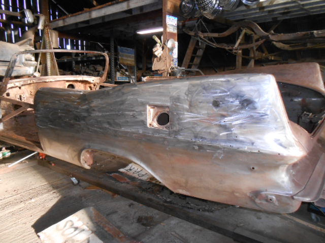

    When the right quarter panel was hit, it had buckled the seam on the rear deck, allowing rust to form beneath the solder on the seam, I melted the old solder out, repaired the metal beneath, and paddled new lead back in place. While I had the torch out, I tidied up a few more spots, and leaded the lower quarter. It needed very little.
    ---John

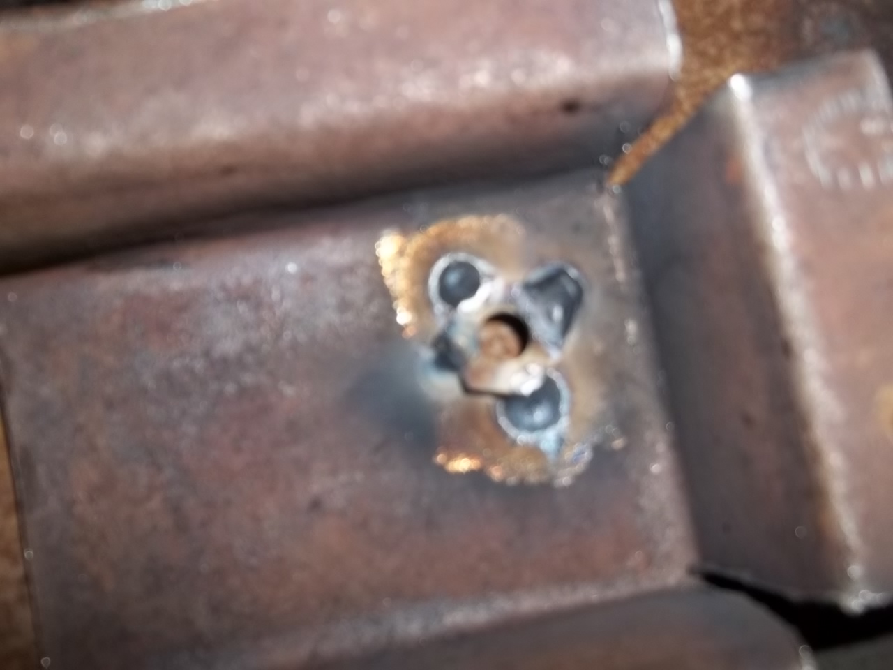

    Next was too weld up the trim holes that would not be used. The welds were then ground down and smoothed on both the outside and inside of the panels.
    The placement for the medallions mounting was tricky, as the mounting pins were offset on each.
    ---John

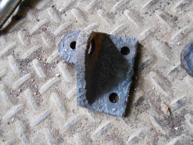

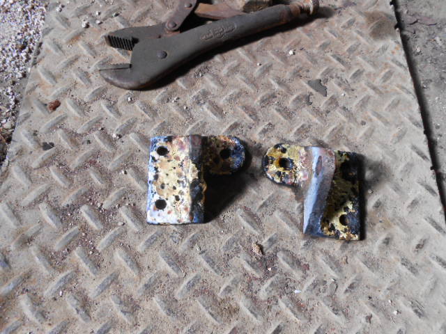

    I dug out the old convertible top lift cylinders, as they still had the floor mounts attached. Pretty badly deteriorated, but I could not find any suitable substitute. Heat had to be used to take them apart, pretty much was a blob of rust!
    I heated the two mounts cherry red, and applied brass to fill the major pits, and build them back up.
    After letting them cool, the excess was removed, and smoothed out. These will work fine now.
    ---John

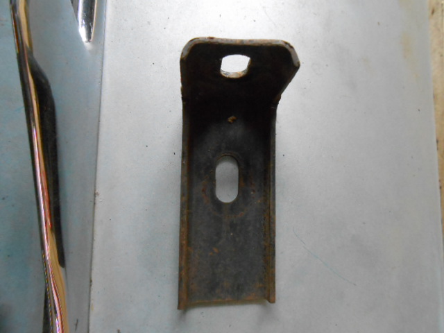

    There was enough left of the one lower support bracket that I was able to find a replacement- The corner dash braces on a '60 Thunderbird were the correct gauge and configuration, although they would need to be shortened.
    Next, I found some half-moon captive nuts similar to the original, and tacked them in place in the correct spots on the brackets, and welded them on the underside of the body. These function to support the pressure from the top lift cylinders, as the inner two bolts are supported by the inner rocker panels.
