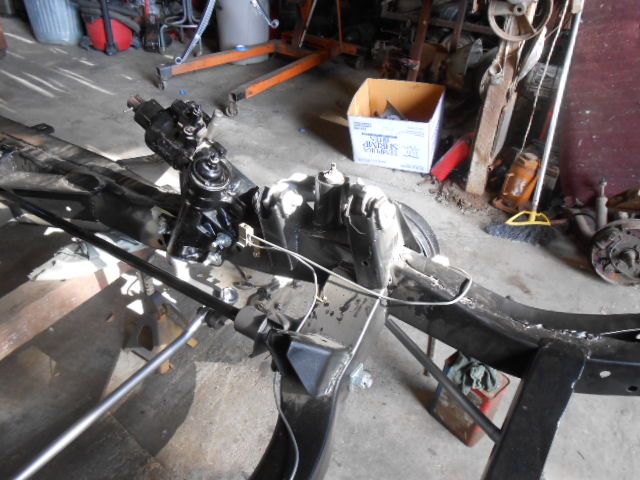

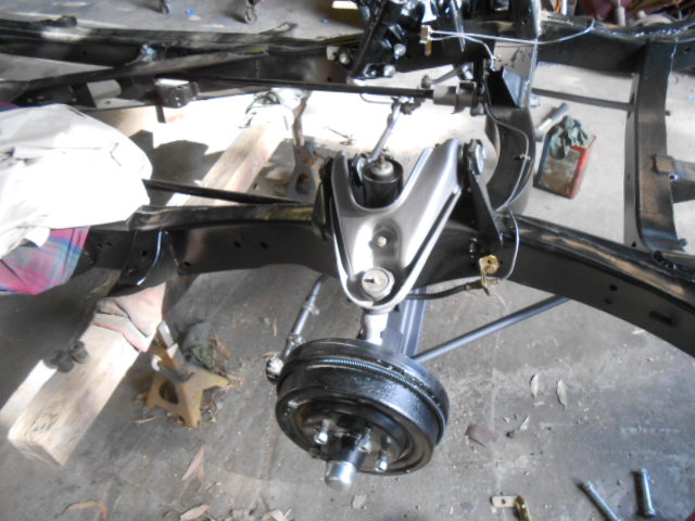

    big M
    I replaced the ball joints, bushings, and tie rods, and painted the suspension components. These cars had bare metal on the control arms, torsion bar ends, and steering linkage when they left the factory, so I used Metal Mask paint to replicate the look without the worry of rusting, and reassembled the front end. I had saved original hardware from two Furys I had parted out, and had the hardware zinc chromate plated.

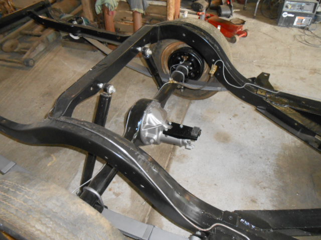

    big M

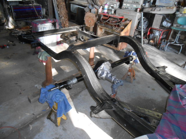

    I replaced the one rear axle that had the end damaged, then replaced the bearings and seals. The pinion to ring gear backlash was within tolerance, and the bearings were in good shape, so the chunk was painted and reinstalled.
    Next, I positioned the rear axle beneath the chassis on a jack, and installed the leaf springs, then lowered the axle and tightened it to the springs with the U-bolts.
    ---John

    big M

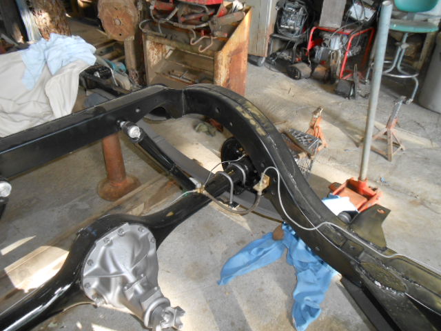

    I have to keep everything covered each night, as we have bats in the barn that will tend to crap on everything. They do keep the insect population to a minimum, so I let them be.
    I bent and fitted all the brake lines and fuel line, and mounted them to the frame using the replated clips and hardware. Installed the rear backing plates, brakes, and then the drums. I used some tires and wheels from a '52 Ford for temporary rollers, as they held air good.

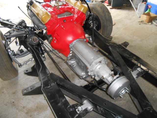

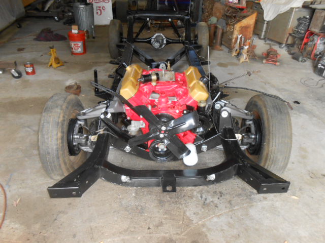

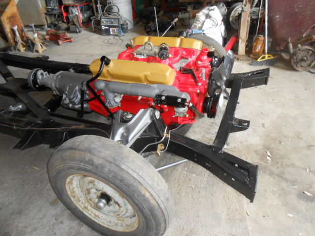

    big M

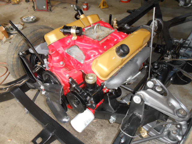

    A bit more progress, got the 361 Golden Commando mated to it's torqueflite trans, and installed in the chassis. Painted and installed a few bolt-on items as well. Last update for awhile, as I have another project that I need to complete first.
    ---John

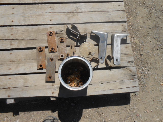

    While finishing up the bodywork on another car, I spent a few days gathering hardware from other cars in the yard. These I will have zinc plated, nearly 400 pieces.
    I cleaned the entire bunch in acid to remove any rust, then neutralized them with a baking soda solution. Any with undercoat or paint I had to wire wheel, as the plating would not work properly with foreign matter. Afterwards, I washed the entire lot in lacquer thinner to remove any oil or undercoat residue.
    One container will be yellow zinc [gold] and the other will be clear[silver]

    Got my hardware and body mounting pieces back from the plater, everything turned out good.
    ---John
