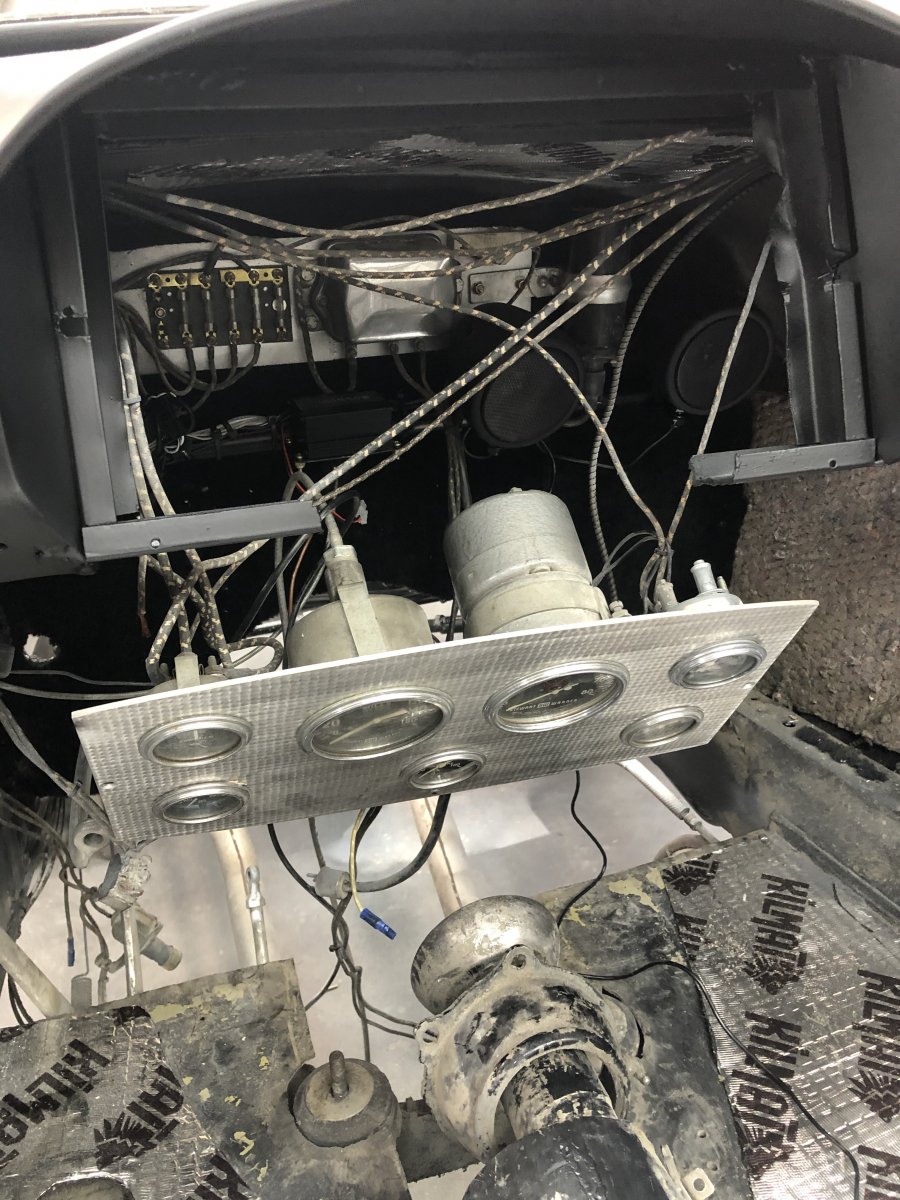

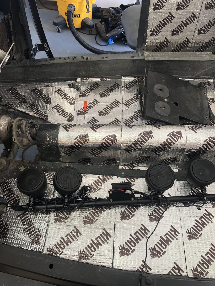

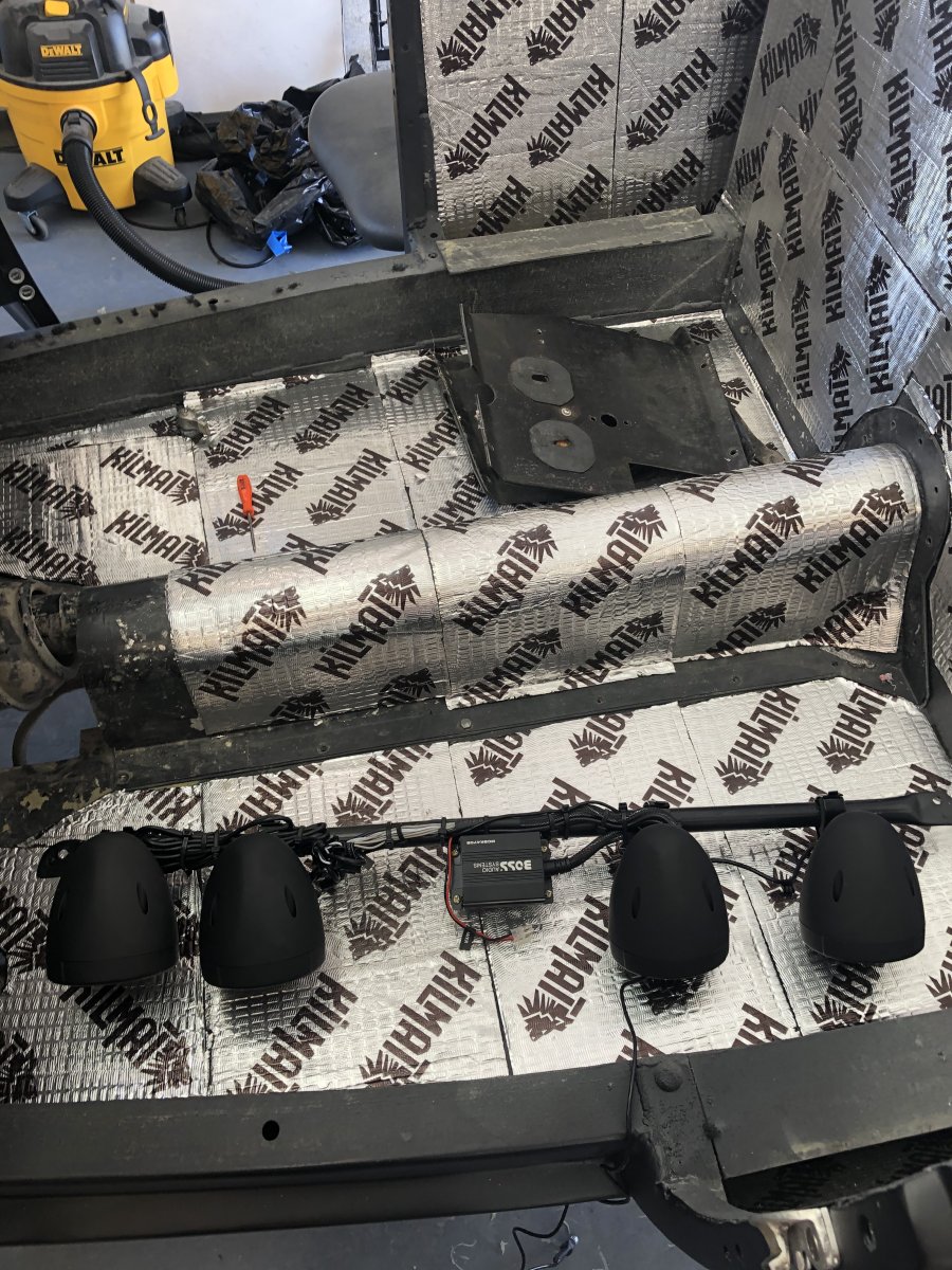

    Ok, today was a little non traditional. Mama has been wanting to add tunes to the car, but we didn’t want to hurt the vibe of the car.
    So, we built a modular system that can be removed with one plug and two bolts.
    Mama did some research and found a cheap motorcycle system on the web. We picked this system up for about $125.
    I bought a piece of 1” conduit, cut to length, flattened the two ends and popped a couple holes in it. I picked up the forward holes in the cowl. I welded up a small plate to mount the amp to.
    It looks like a hot mess, but I didn’t want any speakers to be seen. This thing is Bluetooth enabled, so we should be able to control it with the phone. I’m sure at 65 it will be worthless, but I think under that it should work be good.

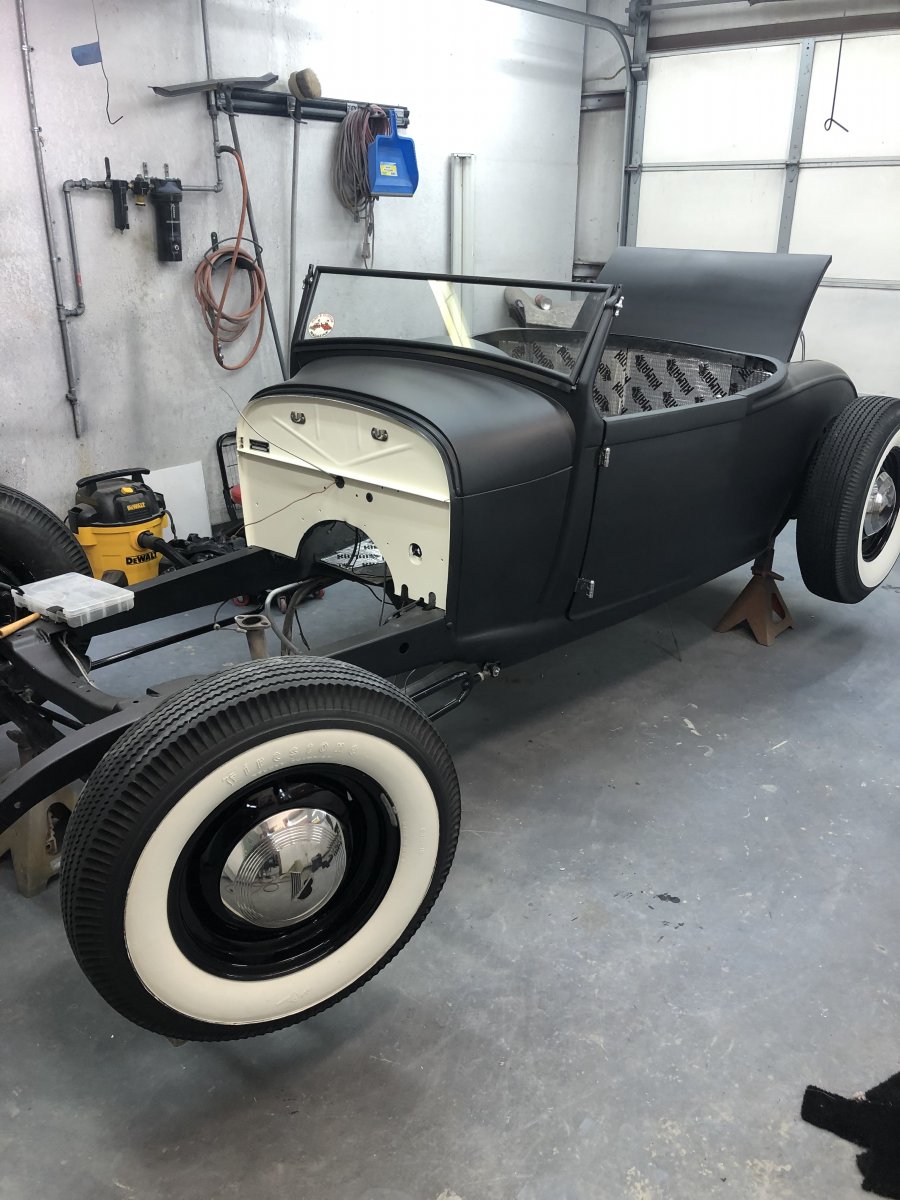

    Got tired of tripping over the wheels and tires, so I cleaned up the wheels and tires and put em back on. Starting to look like a car again.

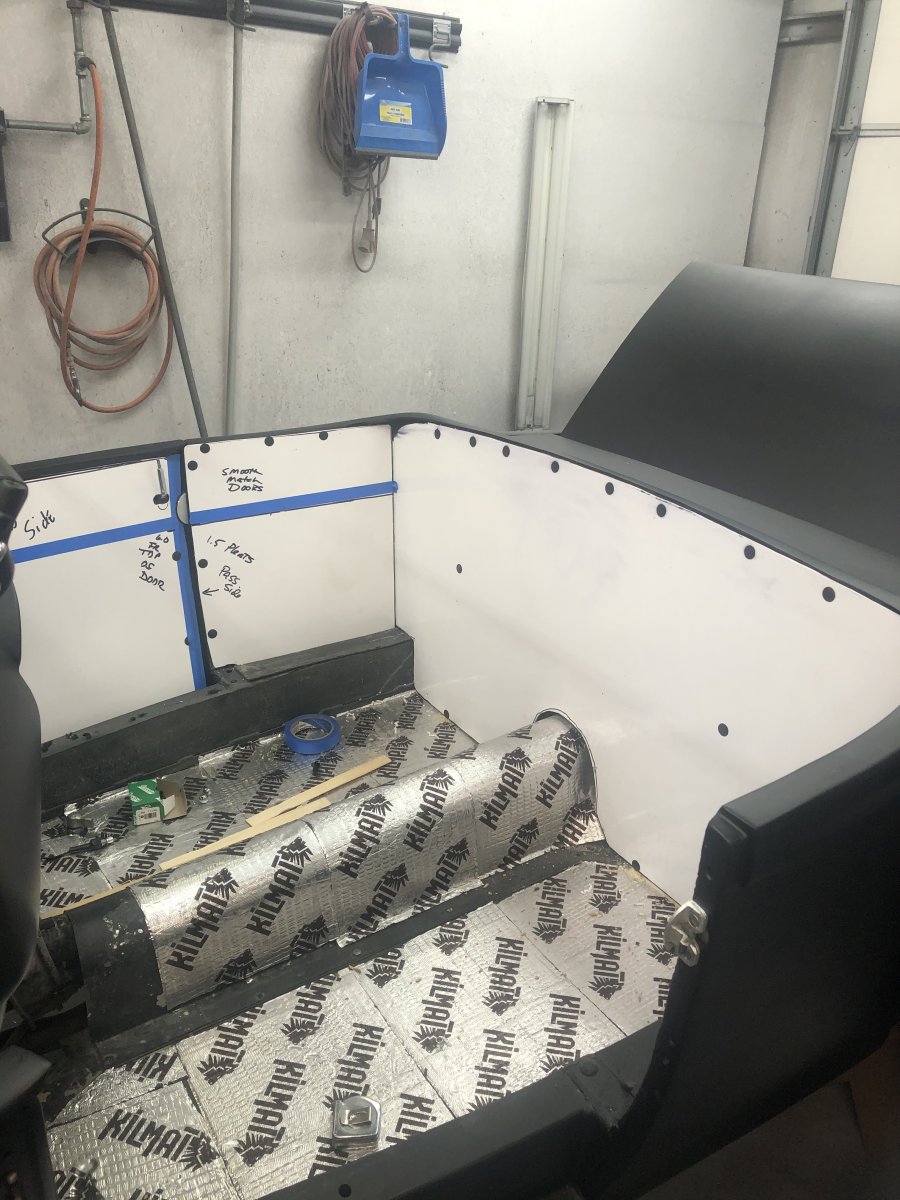

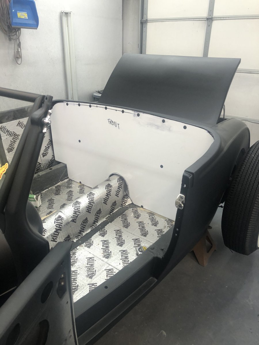

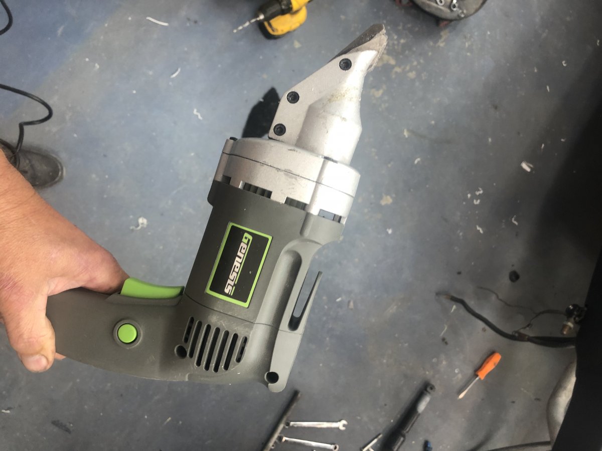

    Today was kind of a amateur upholstery day. I needed to build panels , so that the upholstery guy could get started. That way we can be gaining ground while mul***asking.
    These nifty little shears are a life saver. Maybe I can finish these up by the end of the day tomorrow. 5C543298-A972-4CF8-9A26-5C2B5C842659.jpeg 6316F237-8C3E-4828-9229-09CDE0D3EDBD.jpeg E99D17ED-4A1A-4C60-951F-3C946C404141.jpeg

    Those shears are great BUT watch out for the curlicues that they leave behind they can be QUITE SHARP. Ask me how I know. :confused:

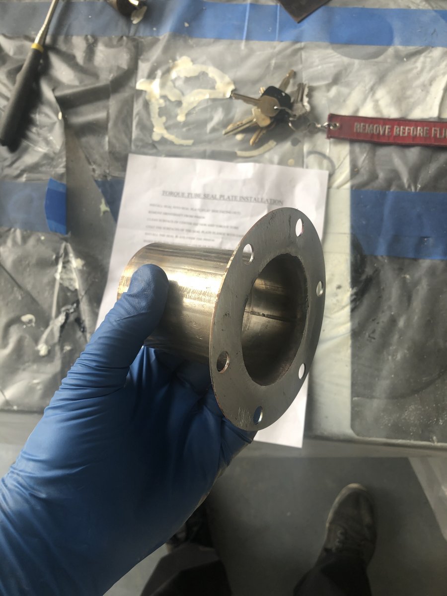

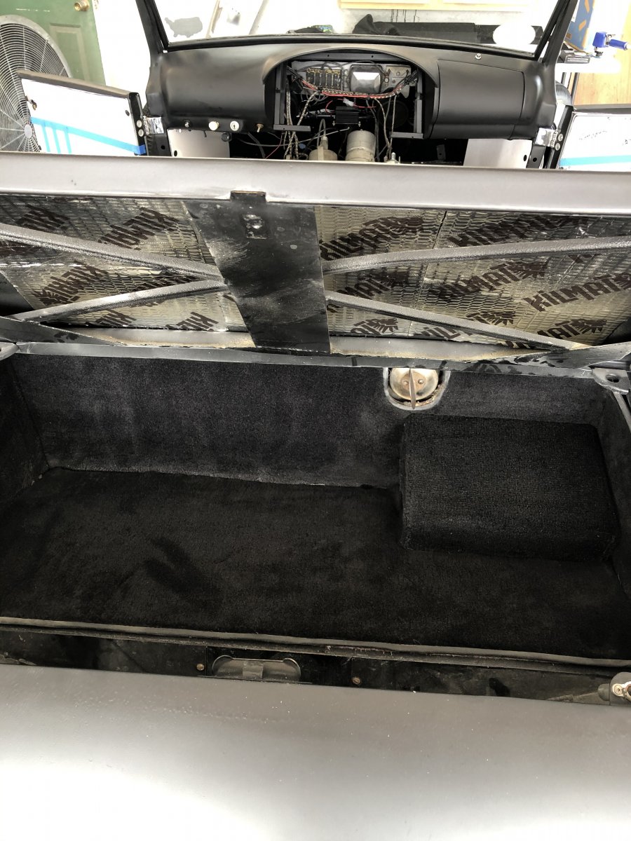

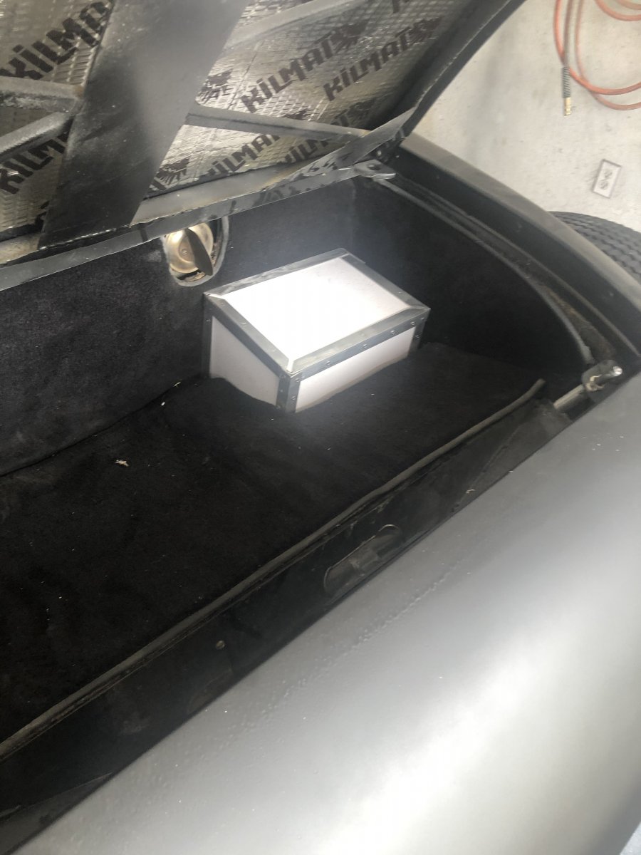

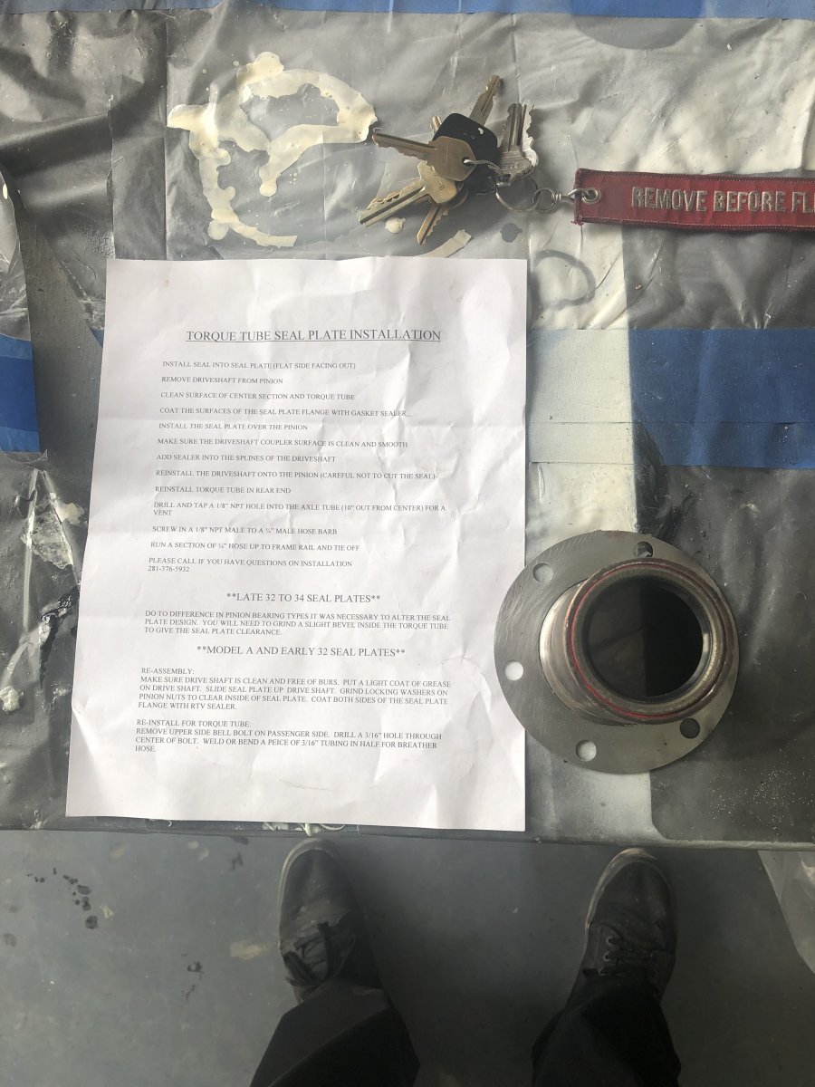

    Ok, today was fruitful albeit not really thread worthy. I made a battery box cover out of s**** ABS. The wife has been worries about the **** in the trunk shorting our against the posts. I took longer than we figured, but that’s the story of my life.
    Later we installed one of Danny Burrough’s torque tube seals. This is supposed to keep the oil from migrating out of the rear end into the ******. It’s a nice piece. That also took longer than I expected. F898753F-F067-4034-96E4-91C56F1B33BF.jpeg AC279EDB-6EAE-4435-AA89-54639C18C524.jpeg 1CE2C63A-7A7C-4923-9231-AF423839F75C.jpeg 7BD1662D-C497-40B8-8309-D4C442C58E5E.jpeg

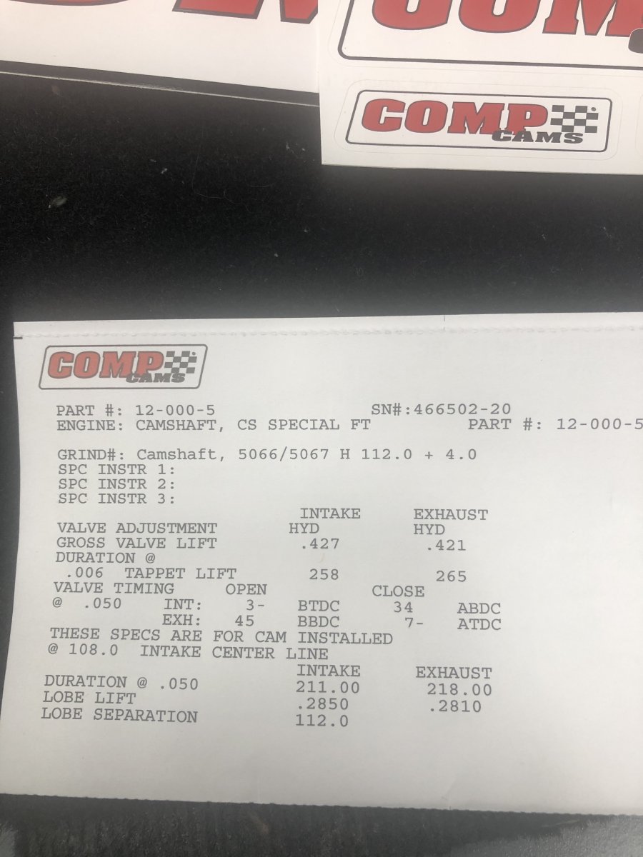

    A while back I was cruising through a parking lot and I overhead several different people comment “You can’t even hear it run”. Meant as a compliment, but it bothered me. This is a hot rod, not a restored grandma car! So, I decided it needed a cam swap. Something to give the little 265 some rumpity rump. I researched a lot of threads,websites and old magazine articles.
    I was looking for something along the lines of the Duntov 097, but I didn’t want a solid lifter cam.
    I settled on the Comp Cams Nostalgia grind. It’s a small can by today’s standards, but it is a nice grind that will allow me to keep the stock valve springs.
    I have been terrified of the whole flat lobe syndrome, so I bought the Comp Cams Snake oil lobe coating, ZDDP oil additive etc. Wish me luck. The good thing is it is a low seat pressure spring setup, so it should be fine. I hope...

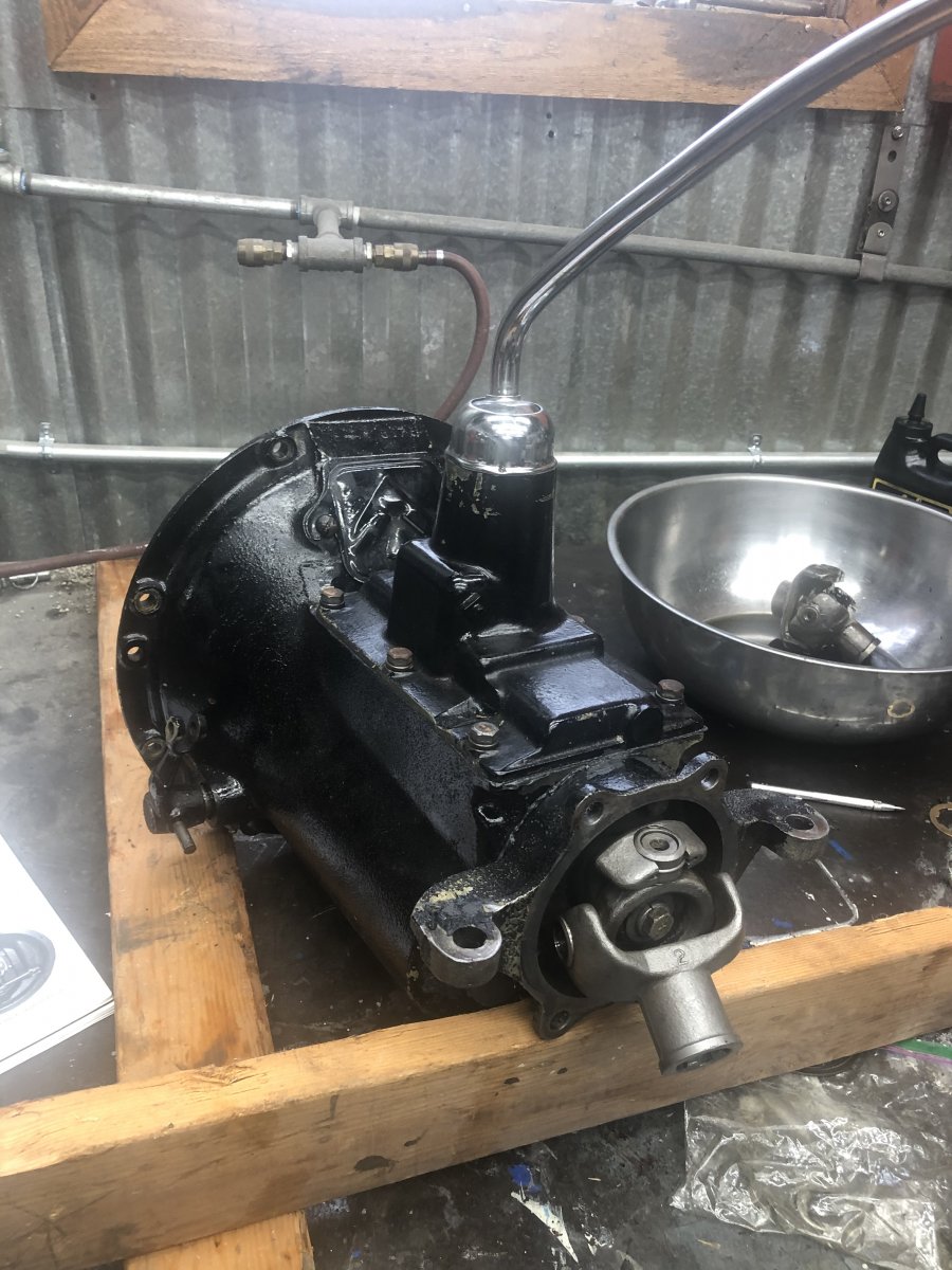

    Last Sunday afternoon, the wife and I embarked on our first 39 Ford ****** overhaul. After a lot of questions on the Hamb and to Mac Van Pelt, we finished it up. We converted it to the later style synchros. Feels much smoother on the bench. Hopefully, this will solve some of my leaks. 291A7F67-1A54-407E-AE79-83AF09B447AB.jpeg

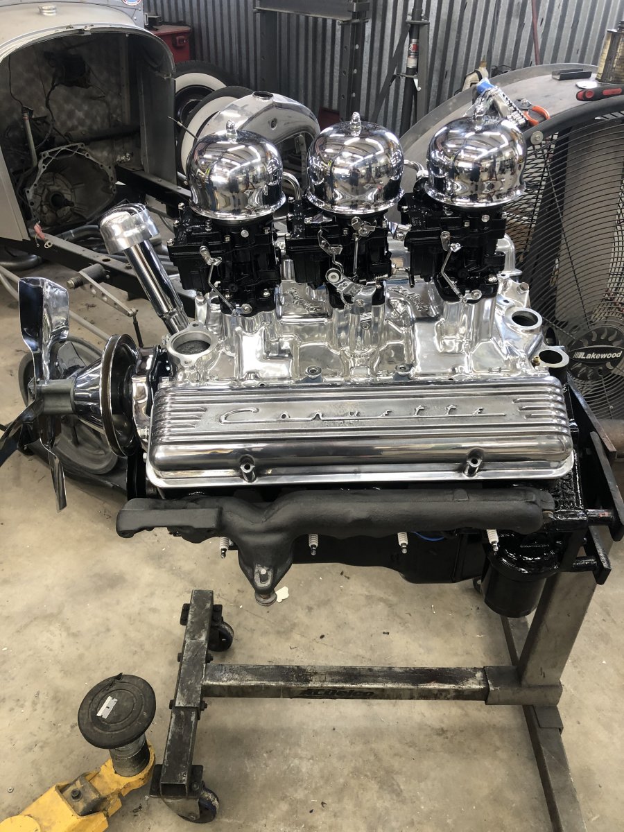

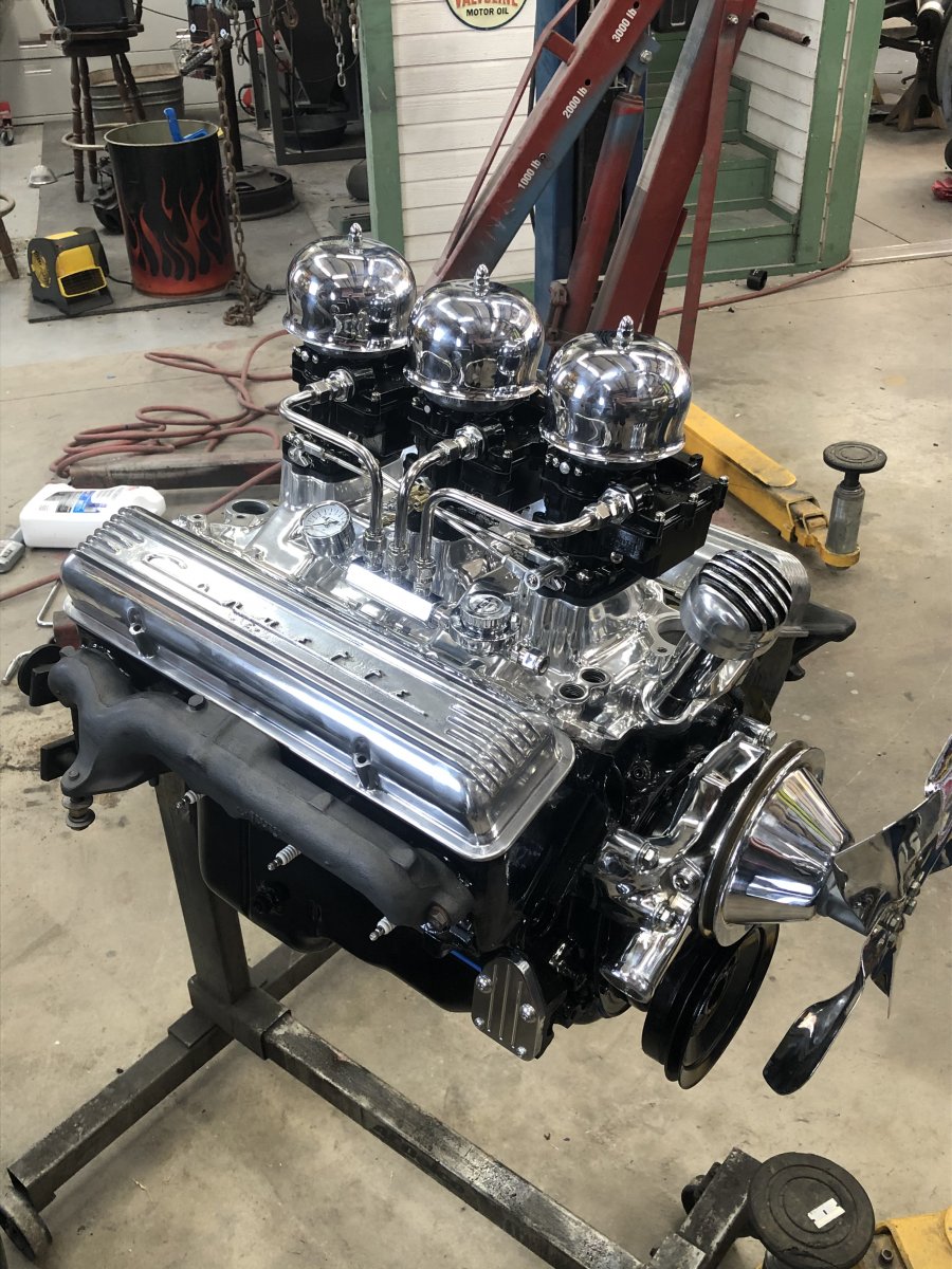

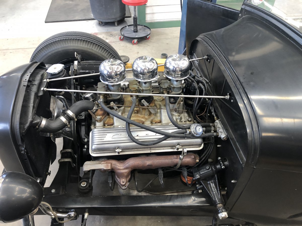

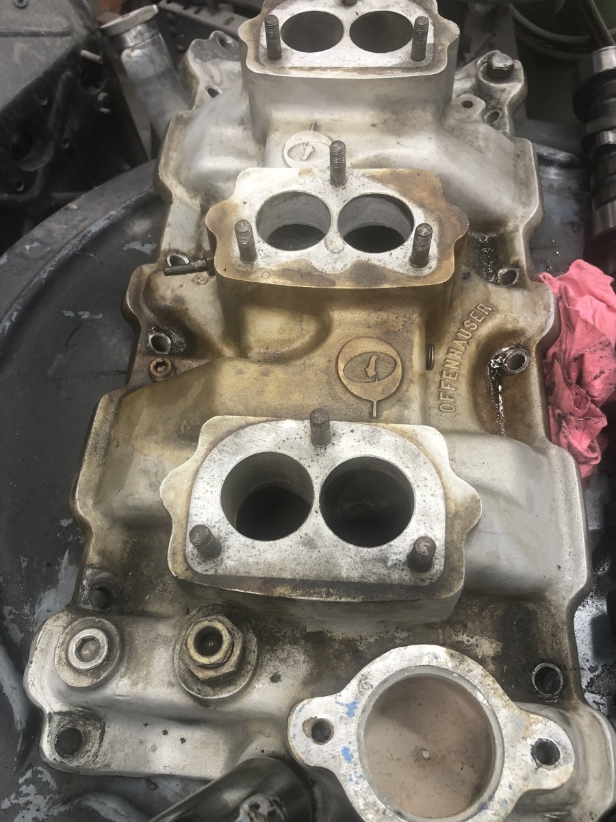

    A lot of you will scream and cry that I ruined it by removing the revered, holy Stromberg leakers and converting to Rochester 2G’s, but it will be ok, I promise. I have been building this setup in my head for 10 years. I bought the intake back about ten years ago and have been patiently waiting for my day in the sun. I used Tripower Carburetion out of Missouri. Nice guy. I wanted something that pops a bit, so I asked him to powder coat the bodies and chrome everything else.
    I am still waiting on my NOS, Cal Custom, staggered bolt valve covers to get back from the polisher/chromer. They will look pretty dang good.
