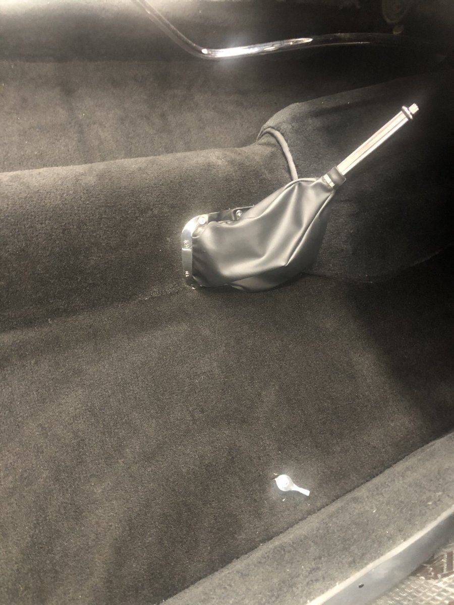

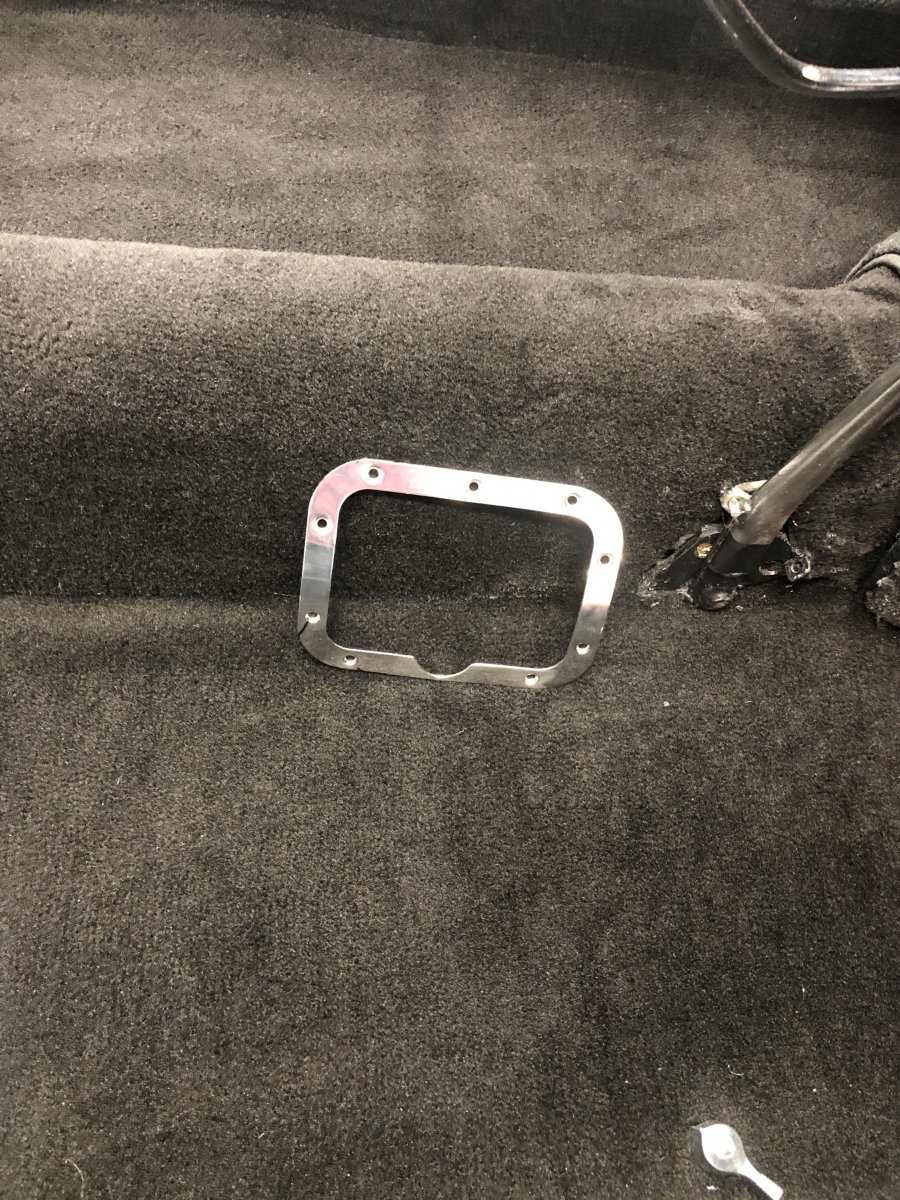

    So, the emergency brake has never had a boot or cover, so the wife decided to whip one out. I didn’t want to throw anything else into the mix for my upholstery guy.
    We ordered a stainless ring off of the old inter web....had to notch the bottom of the ring to clear the e brake.
    2CB78DAC-FC66-44A1-A173-DCF6A014B9D7.jpeg 24D7FC8E-A26D-43F4-86E4-31E7FA0B38EF.jpeg
    Turned out pretty decent.

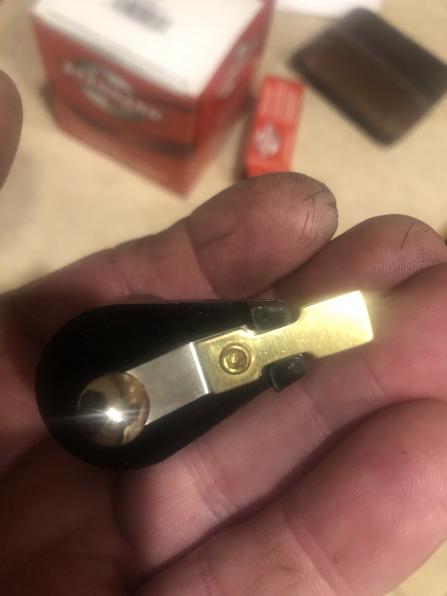

    Well, today didn’t go as planned.
    I primed everything up and tried to bust it off, but it was backfiring through the exhaust. I thought maybe a valve was too tight, so I ran the valves again. No bueno. Finally found this.
    I guess the cap is starting to deteriorate and allowed the cap to shift. I kept finding little pieces of black plastic in the cap. Didn’t think much about it.
    The rotor hits and then swivels, starts cross firing. I have a cap and rotor on order.

    Got the new rotor. Looks like the old rotor was missing the tab that holds the conductor. I will throw this in tomorrow and see if this solves my problem.
