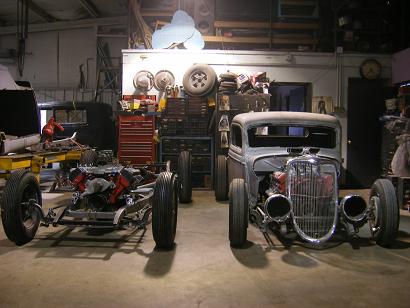

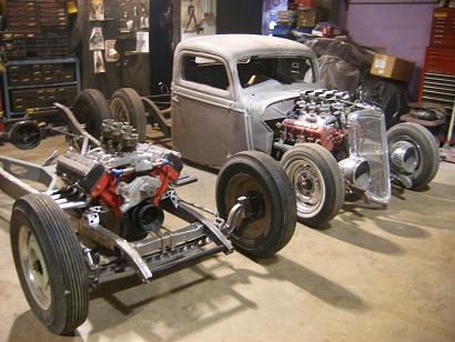

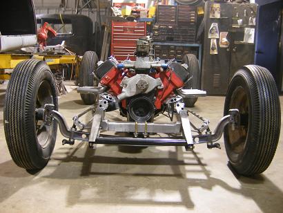

    Drag docs's sedan project hits the ground and gets it's engine.. check it out as well as the coolest truck in the world sitting next to it. hahaha enjoy drew

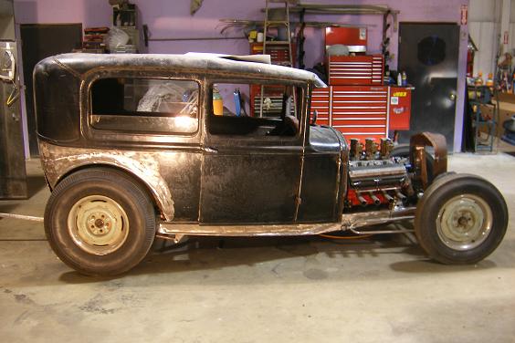

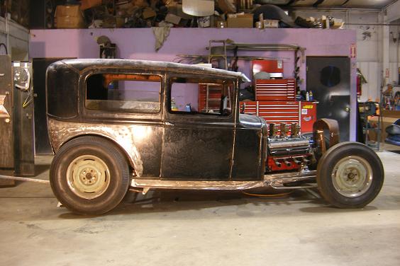

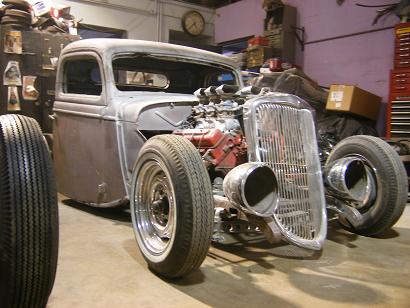

    body mock up pic..

    The center cross-member and rear suspension both look great. I was curious what size wheels and tires are on the Sedan and the truck. Thanks

    todds sedan is going to be cool glad you guys like it glad he likes it. rudy's truck was started 16 years ago before I could drive so he kinda stole my idea hahaha.. it was my first hot rod project abandoned a few times over that span of time. the tire size on todda are 16 x 4.5 600 and 750's and the trucks is 15x5 560 and the rears are 15x7 710's later dudes

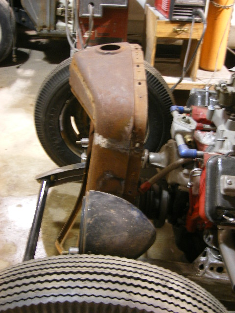

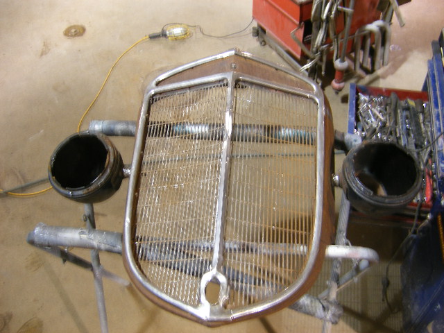

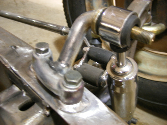

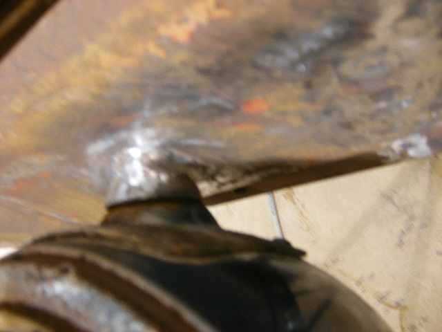

    here we go some more canal pics. The grille is international truck shortened 4 inches. model a headlight stands I used and glommed em to the shell and reinforced it on the back side. shock stands are f1's shortened up and twisted. firewall recessed to keep the wheelbase short. enjoy

    Okay, I see something exciting with the rear suspension that I've been waiting to see and hear about.... Triangulated 4-bar with a transverse spring!! Was thinking about doing this VERY thing with my Murray build! Would like to hear more on what the thinking was behind this. I know a parallel 4-link works well (Jimmy White has proved that). Thinking that the triangulated version would work just as well, if not better because it elliminated the need for a panhard bar. Fill me in, PLEASE!!

    Also... what are you going to run for a radiator behind that IH grille shell? Sucker is going to have to be short as hell! Very curious. I will be faced with the same dillemma, so I would like to hear what's up with that.

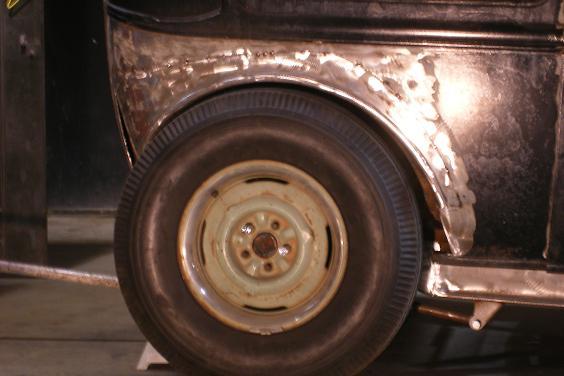

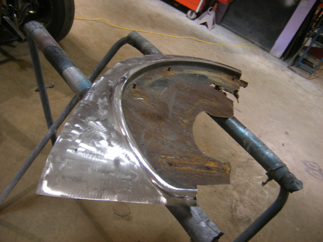

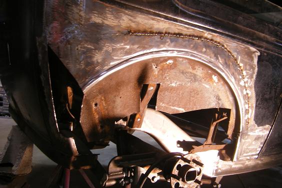

    cats outta the bag i am having a professional build my truck hahahaha. here are some wheel well section pics. watch your back in the 815!
