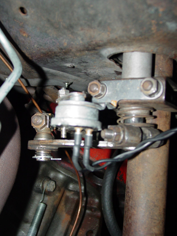

    I noticed the firewall cutout for the steering column is pretty generous.
    My steering column is about 1/4" off center away from the headers, giving 1/2" clearance at the closest shifter position.
    Maybe other body styles or earlier year dashes bring the steering column closer to the headers.
    The position of the steering column depends on the steering box that's mounted to the frame and the clamp mount on the dash.
