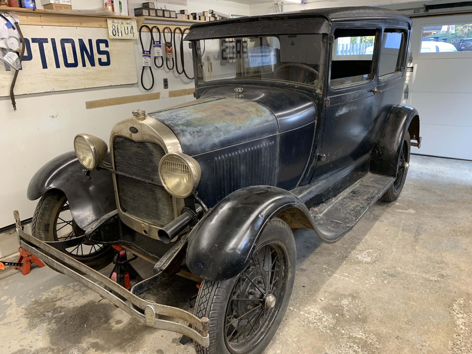

    Long time lurker after introducing myself many years ago so I should probably do it again. My name is Pete and I live east of Toronto and have spent most of my working career in the bicycle industry with a strong interest in old cars, cycling, building things with wood, volunteering, etc. I rebuilt a 1949 Meteor Club Coupe with my dad over a number of years and have been enjoying it ever since but never bought another car to work on until now.
    My goal is to be more involved with the Hamb community with my latest project as I am going to need the expertise and guidance from this group (which has already helped me immensely when searching for a Model A).
    It’s a 1928 Model A Tudor that I picked up from Saskatchewan a few months ago. I’m very pleased with the condition of the car considering I bought it based on some bad photos and good conversations with an old farmer. Has some fun as well trying to figure out how to pay him. And, had a great road trip with my dad flying out to Saskatoon, meeting the owner and then trailering the car over 2500 km home with a Uhaul truck and trailer. Ya, it cost a few bucks but we had a great time, saw some new places and met some really good people.
    It is a Canadian car that seems to be an early build as the parking brake is on the left side along with other components indicative of an early build. No doubt, I will have questions about the brakes, clutch, etc. as I get into the project. Plans are to turn it into a fenderless Forties style banger (if it lets me).
    So far, I have rebuilt the carb and the distributor (just to get it running). The wiring is pretty bad so I haven’t turned the key yet but hope to do so shortly. Compression is around 60 psi in each cylinder so I’m hoping the motor is fine.
    I finally got it into the garage this week after finding a nice winter home for my Meteor.
    I've got it up on jack stands so think I’ll drop the pan and see what’s happening there before I fiddle with the wiring and get it running.
    And that’s where I am today. Can’t wait to get some momentum on the project.

    I'm no Model A expert but I believe the left hand E brake handle means it is an early '28 model referred to Model A guys as an AR. Here is some info from over on the Barn.
    On the cars with the left hand emergency brake handle (very early 28 and early 28), pulling the handle back actuated the normal service brakes thereby actuating the brake shoes on all four wheels. These cars didn't have a seperate emergency brake band inside the rear drums.
    And IIRC some had red steering wheels but that might be total BS. Regardless great find.

    You have a nice original example of an early '28 and there are those that will cringe with anything beyond original
    It is your car...but if it was mine
    60 psi is very good compression for a stock banger
    I would get it running and drive it after things like a critical inspection of ch***is and steering...I usually perform this while doing a ch***is lube....I use a 'needle fitting' on my grease gun for the grease ******s on the car...
    Check the wiring real close...the Model A wiring is 'hot' ...energized all the time on the ignition and horn circuits.
    So that wiring needs to be in really good condition and not find its way to ground...
    Check and adjust the brakes....the Ebrake is your friend too
    Check wheel front bearings and grease
    Fluids
    The water pump will probably leak...there is actual water pump grease and packing for a stock pump. A leaking pump isn't a reason not to start the engine and take a short drive
    It is an easy job to convert the pump to a leakless pump with a stainless shaft...a must for a hopped up banger in my mind.
    I'd pull the gas line to the carb and run some gasoline thru it into a bucket to get an idea of the tank condition.
    The float on the carburetor is probably stuck but just put gas to it first and tap the body of the carb. It's a updraft so it will ljust flood the floor if it leaks
    If you pull the pan to check the bearings....the center main is impossible to pull without the side cover off the engine....and it gets the brunt of the abuse in a three main bearing engine...
    Your engine, if stock, has Ford babbit...which has lots of lead in it for an easy 'run in' that Ford did in its ***embly.
    In my opinion, is not a good candidate for a high compression head above 5.5 because of the babbit....
    Welcome to the world of bangers....they are fun but the most money you can spend to go slow....next to a T....
    Go have fun.... driving it stock and then formulate the direction you will take from there...

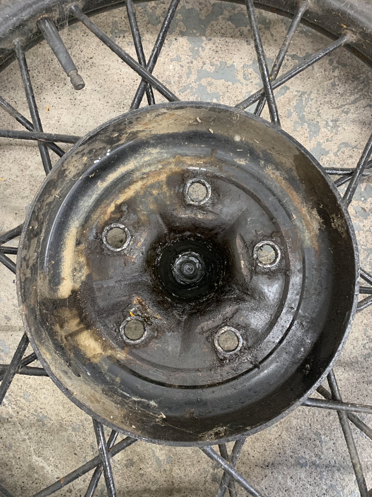

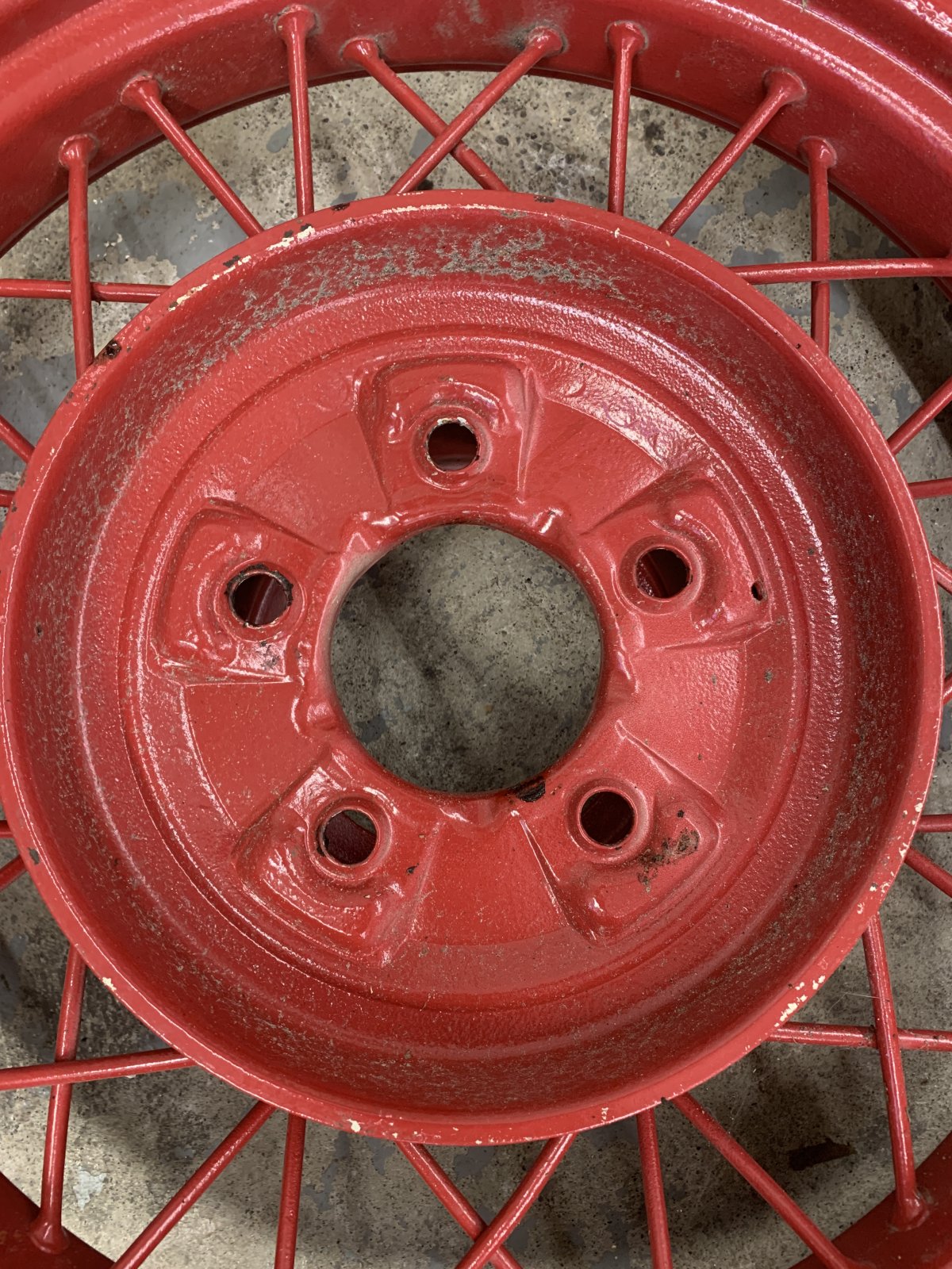

    Wondering if I have got myself into a bit of a pickle here!
    Been doing some reading on this thread and elsewhere on wheels and brakes. I haven't removed the hubs to look at the brakes and I don't have a hub puller for the rears yet. I would rather buy used or borrow one locally than spend a couple hundred dollars and wait a few weeks for it.
    But, is there information somewhere that tells me how different these "early 28" brakes are compared to later brakes? If I need any components are they the same other than the lack of a seperate parking brake mechanism? How different is this brake system? Having trouble finding more info on this.
    Also, I want to get smaller diameter wheels. I currently have a set of 18" wheels from a '32 Ford that I am debating using. I like the tall skinny look and plan on lowering the car only a couple of inches and not chopping it so proportionally it should look fine? I dunno, looking for input here before I spend money on tires.
    In my research on wheels I have seem comments that "early 28" hubs and wheels are different and you cannot use a later rim on these hubs? One note said something about reading Service Bulletin #328." Anyone have a copy of this bulletin? The back side of the '32 rims seems very similar to the '28 rim although there are some subtle differences. The '32 rim is red, the early '28 is black. They seem to mount fine. Looking for input here as well.
    I did not know this was an "early 28" car until I saw it in person! Thanks in advance for help on this.

  23. Fortunateson
    Joined: Apr 30, 2012
    Posts: 5,832
    Fortunateson
    PM me if you’d like to upgrade to the ‘32 brakes...

    You might check over on the Model A section of the Ford Barn.

    If you swap out to cast drums on the rear with the 32 brakes up front it fixes the problem for you if there was one, I have never had any issue swapping out early ford wheels for early ford wheels. The 32 18s will be killer and the hot ticket, some folks like the 16s for the availability of tires and the wider wheel etc. I'm running 17s and 18s on my latest 34 sedan with some rubber rake. My coupe that I posted had 17s up front and 16s in the rear. The 34 I have now I went the Excelsior route(1/3 the price), they are cheaper for sure and seem to be round and balanced out well. The firestones are cool, but higherthangiraffe*****prices takes the affordability out of them. 700-18 out back will be killer look and gets you some rubber gear swap action. 16s were more traditional as tires during and after the war were limited in sizes for sure. The early stuff was harder to get as 16s kinda became more standard sizes before the war.

  27. You can build a nice hub puller for very little. Do a little digging using the search and you should find a couple examples. I'll see what I can dig up.
    Here
    TECH - lo-buck early Ford hub / drum puller | Page 2 | The H.A.M.B. (jalopyjournal.com)
    And another from my pal Jay.
    Hydraulic Hub Puller from s****s! | The H.A.M.B. (jalopyjournal.com)
