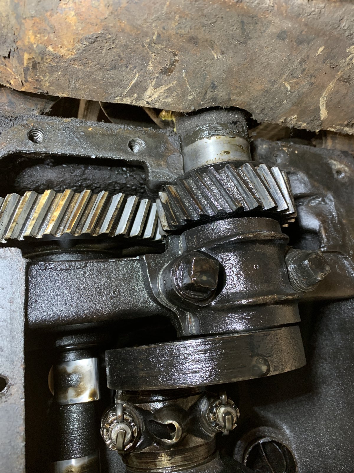

    Not much to report but did clean up the oil pan and get everything back together yesterday. Took a few photos of the cam while I was under the car. Somewhat worried about the lobes but I might install a new cam anyways. Just want to hear it run which is the next step on my list along with creating a hub puller (thanks @Tman).

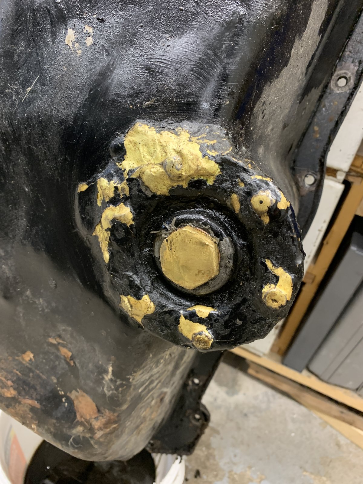

    Probably that pan had water sit in it for years (maybe just a half inch under a pan full of oil) causing rust holes, which were patched with braze:

    Hi Beanscoot - Thanks for the info. I've also discovered that this is an early '28 pan with a seperate cleanout (and for access to the oil pump). I have a later style pan that I will replace it with.

    I wouldn't hesitate to use the brazed up pan, and it actually is kind of appealing with that old old repair.

    Someone just decided to stop a common drip source on a permanent basis.....
    Your cam looks typical. The A has very low spring pressure so it wears little. Dry starts from sitting for weeks at a time probably do the most damage.

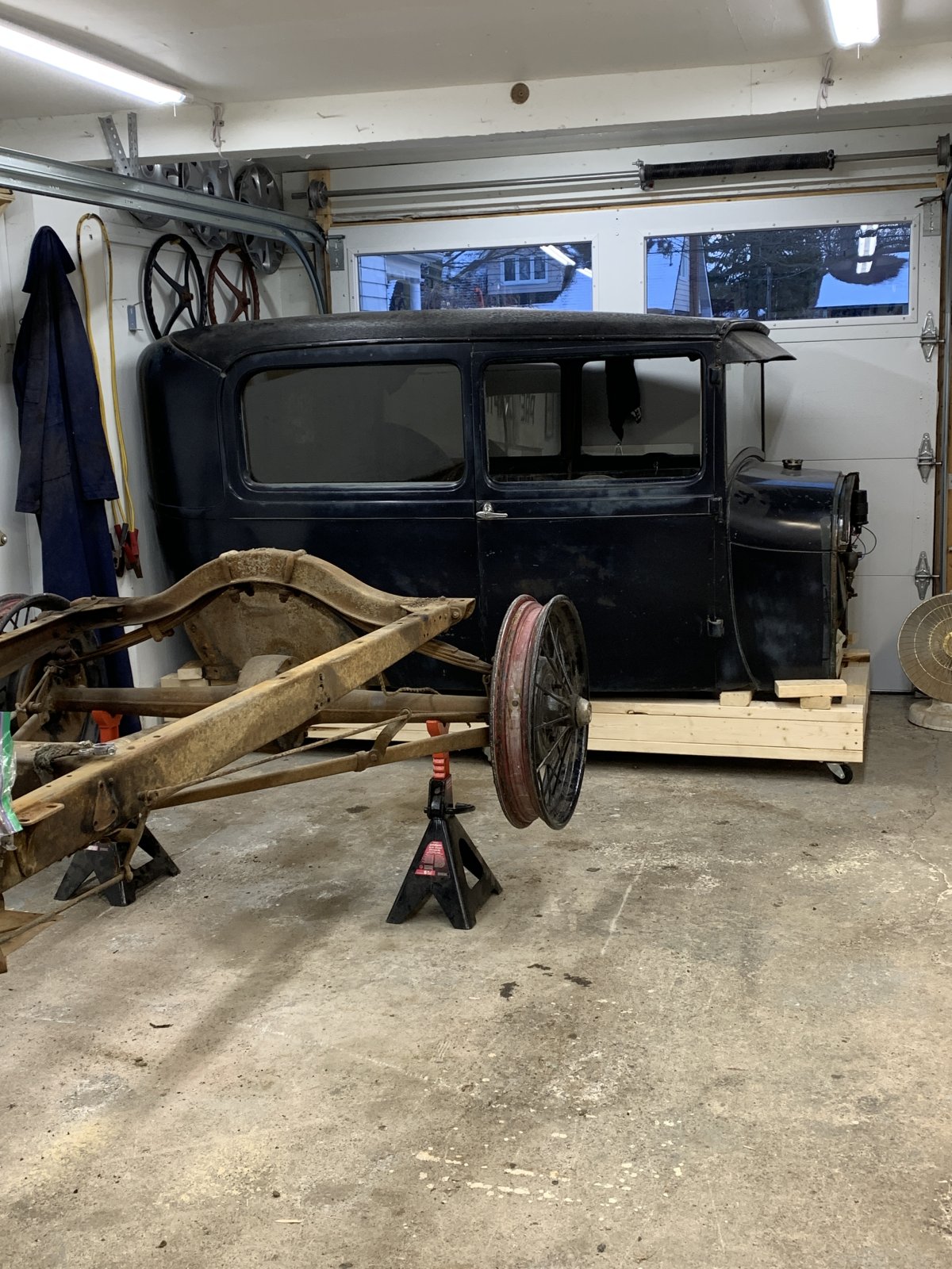

    Finally separated the body from the ch***is yesterday with the help of my dad, a bunch of 2x4s, some jackstands, a variety of jacks and a few slices of apple pie. I was quite nervous when we started pulling the ch***is out but everything worked according to plan (mostly). Looking forward to working on the ch***is!

    Good work getting that body off. It’s amazing what you can do with some timber and a jack
