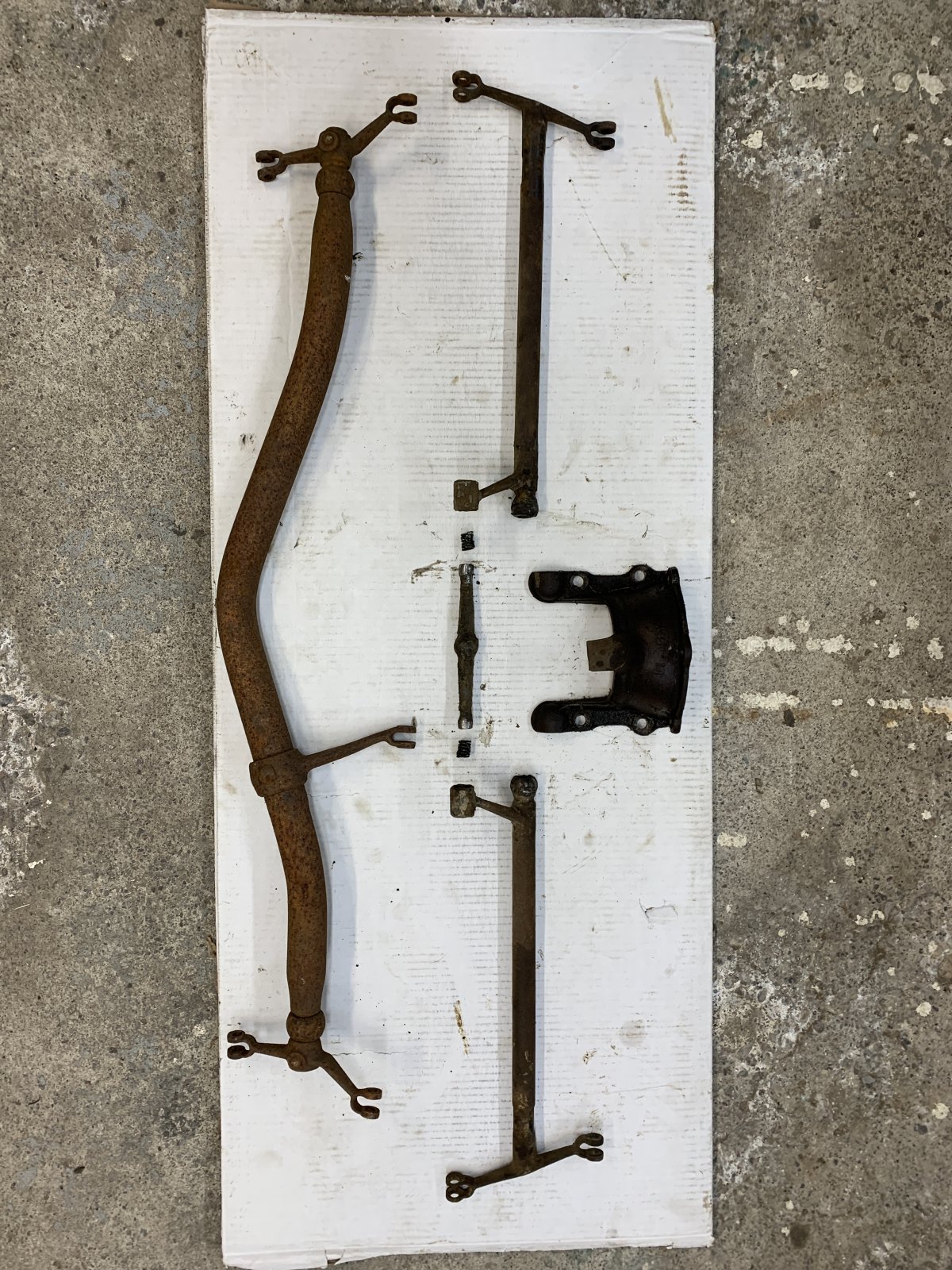

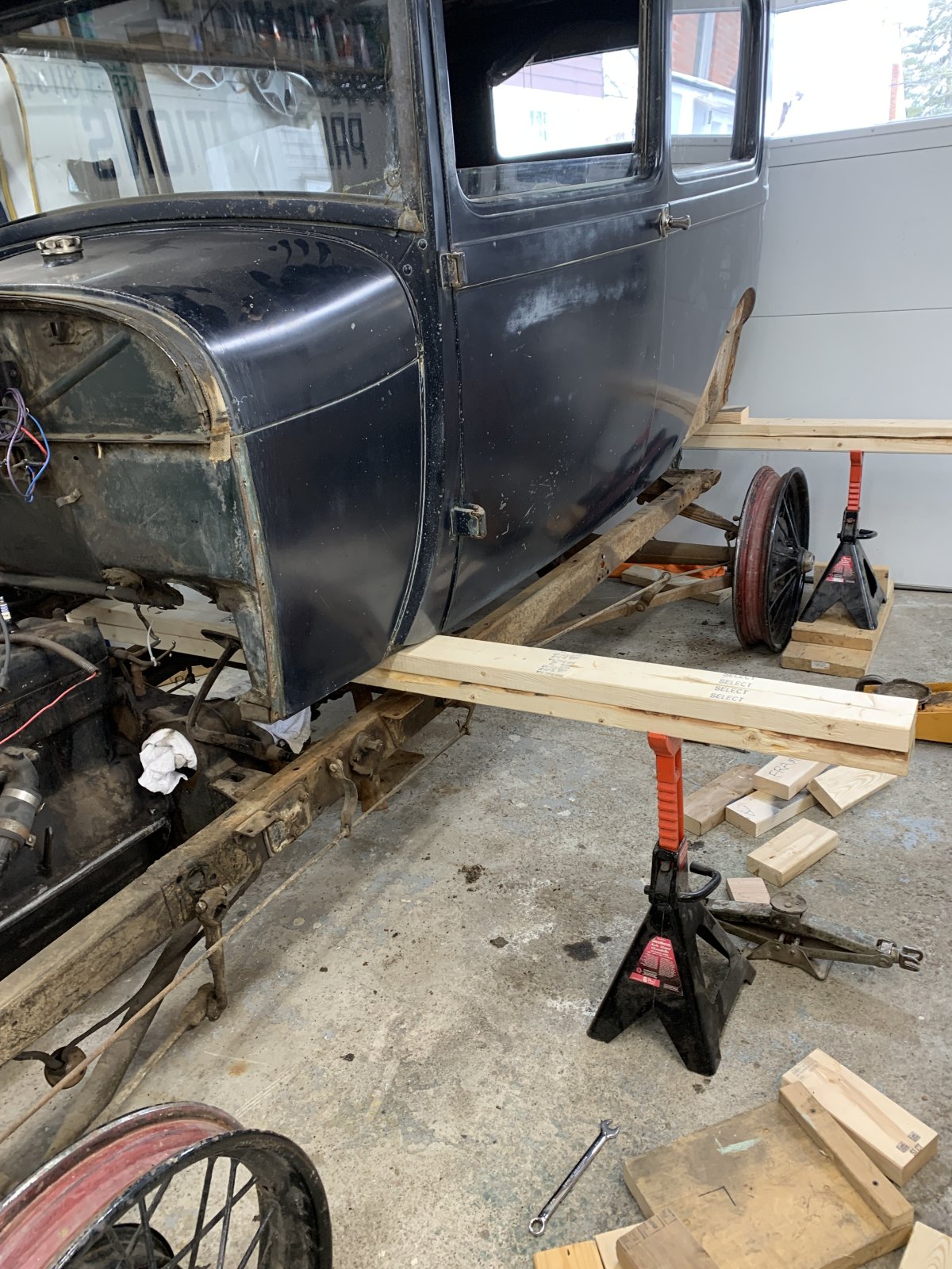

    Spent some time today working on removing the brake components.
    I am replacing the "early" multi-piece cross shaft (shown on the right in first photo) with the "later" style (shown on the left in first photo). Also, note the clamshell design that supports the early 3 piece cross shaft.
    The thinking for now is to update the entire "early" brake system with the "later" style mechanical service brake system AND have the left side (second photo) parking brake lever operate all 4 wheels when pulled (just like it does now). I want to keep the lever in this position (because it's rare and cool) and I won't have a separate parking brake system like the later cars.

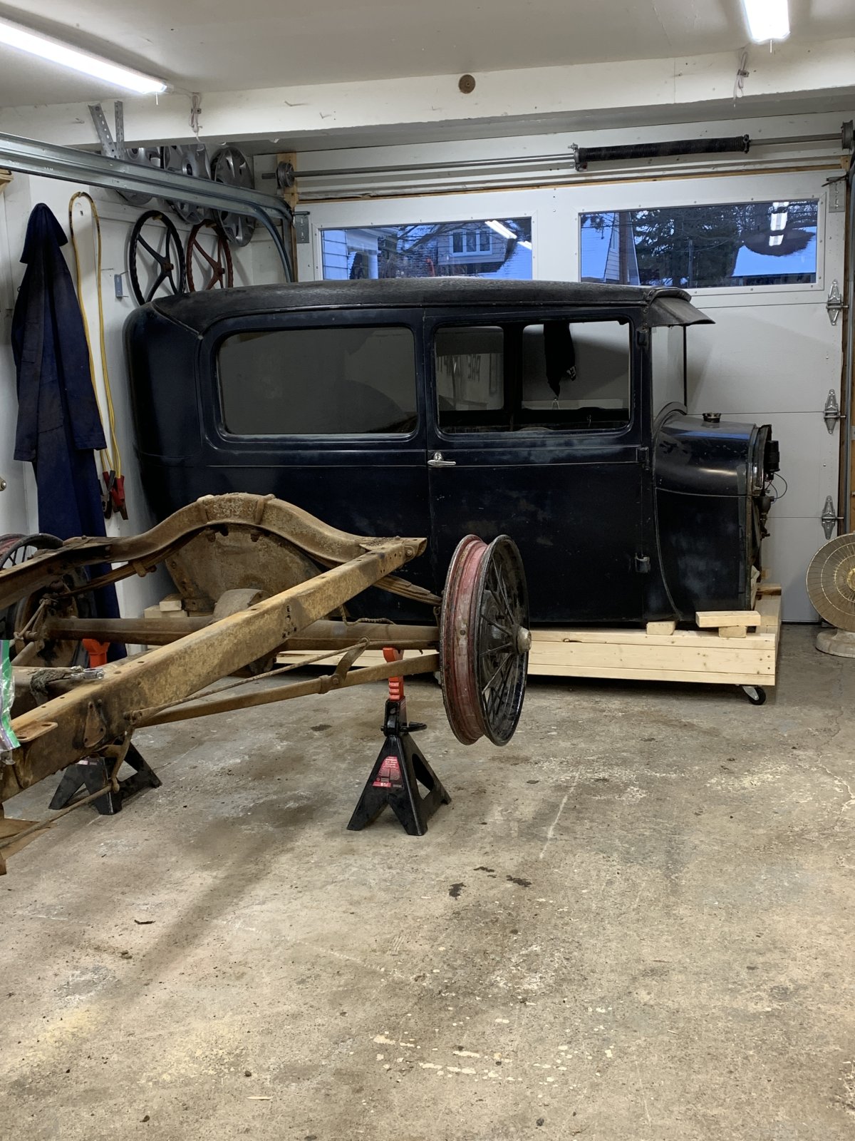

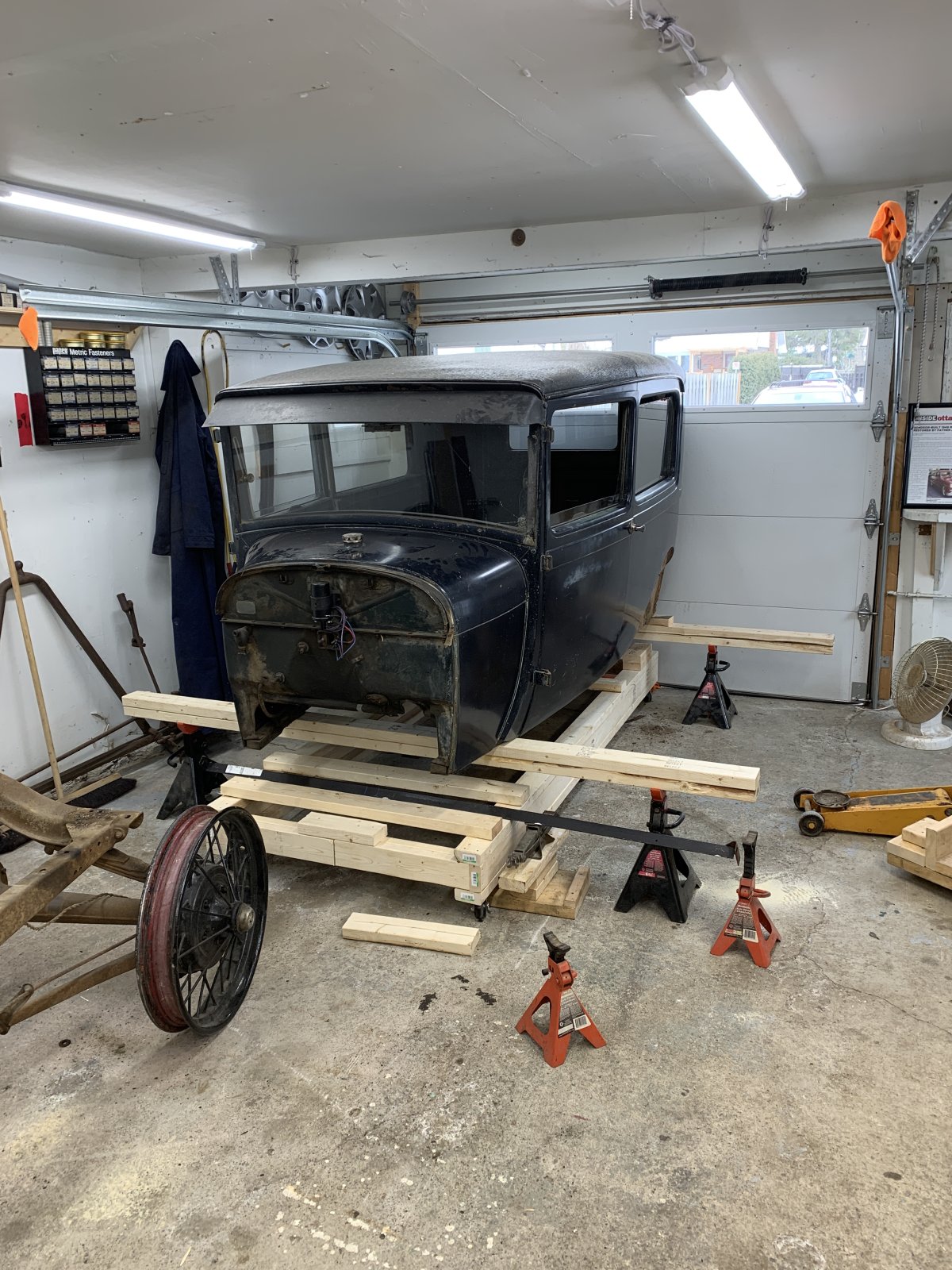

    I have decided to completely tear down my car to the frame. I've given myself until the Spring of 2025 to havc this banger on the road so I may as well do it top to bottom and front to back and really get to know the car.
    Today, when I removed the rad, I noticed that the front crossmember is cracked in multiple places and has had a repair at some point. Looks like I'll be replacing it!
    Can anyone recommend the best source for a new crossmember? I don't want any more drop so I'll be replacing it with a stock crossmember.

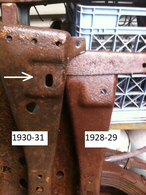

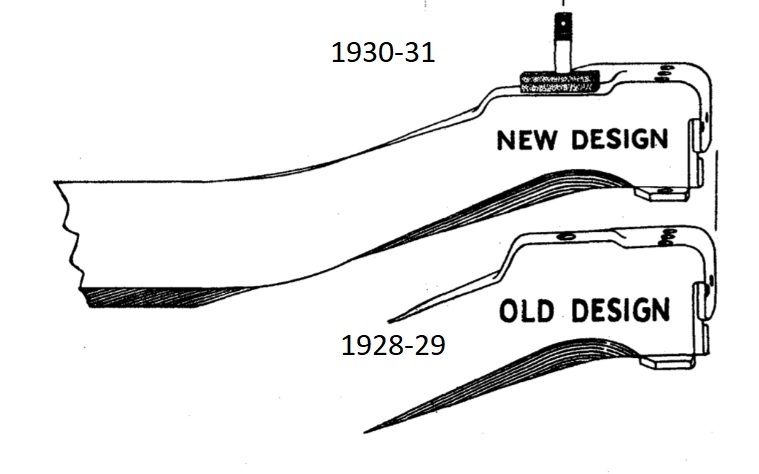

    Just a heads up with regard to the replacement crossmember - it is the 1930-31 version which has several differences, but the main one that affects anything is that the mounting area for the radiator is recessed/lowered when compared to the 1928-29 version. You may need to shim between the crossmember and the earlier radiator mounting brackets for everything to line up correctly, especially if you plan on running a hood.

  15. meteorpete
    Joined: Aug 17, 2007
    Posts: 58
    meteorpete
    This is good information! Thanks for letting me know.

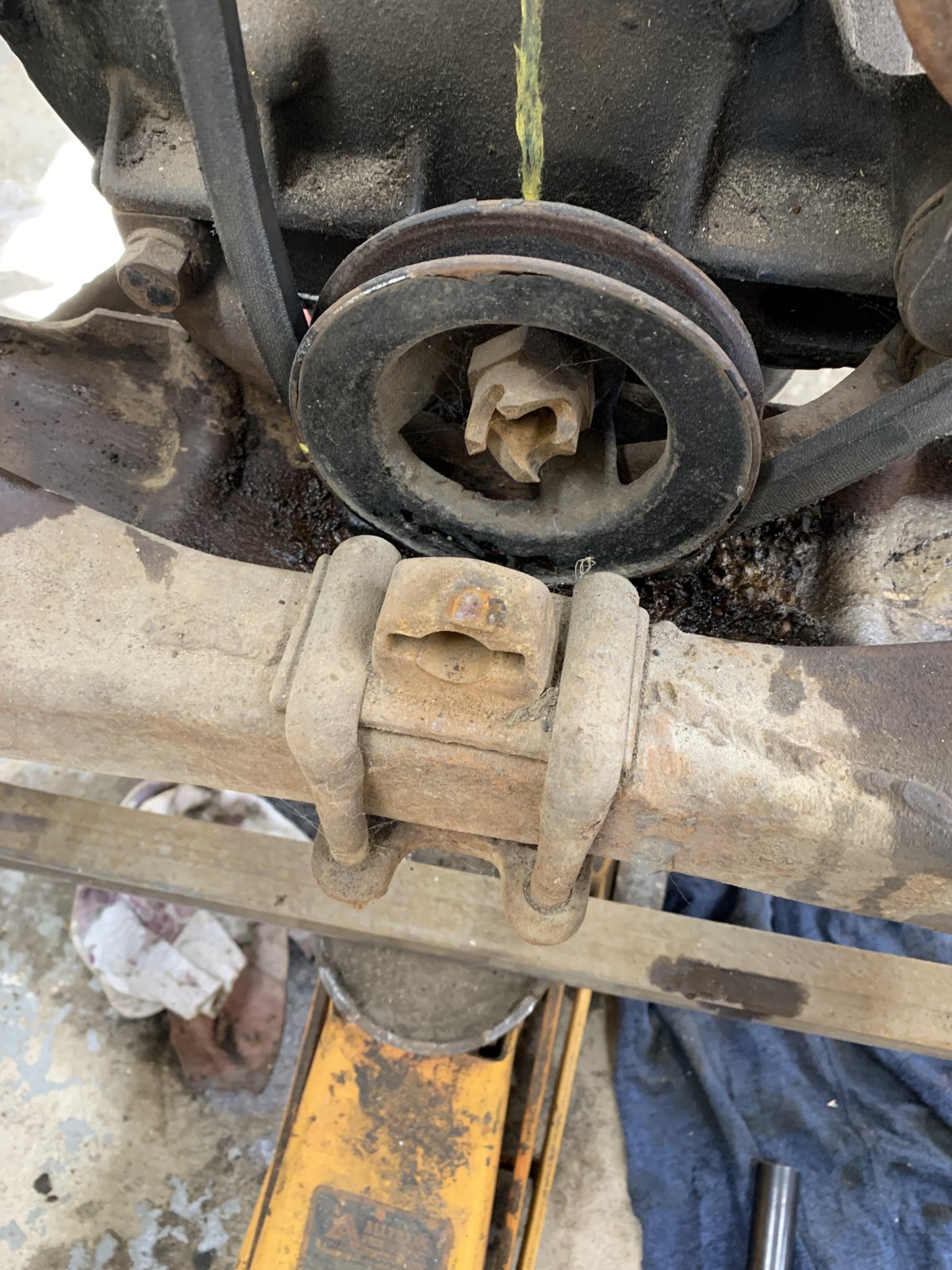

    Looks like I have some cracks in my p***enger side rear motor mount which I'm not sure what to do about.

    However, it seems the 30/31 crossmember that I installed may not be as tall as the 28/29 crossmember because the castle nuts on the square u-bolts threaded well past the cotter pin holes on the bolts. I will look at this further tomorrow. Comments welcome if I am missing something here.

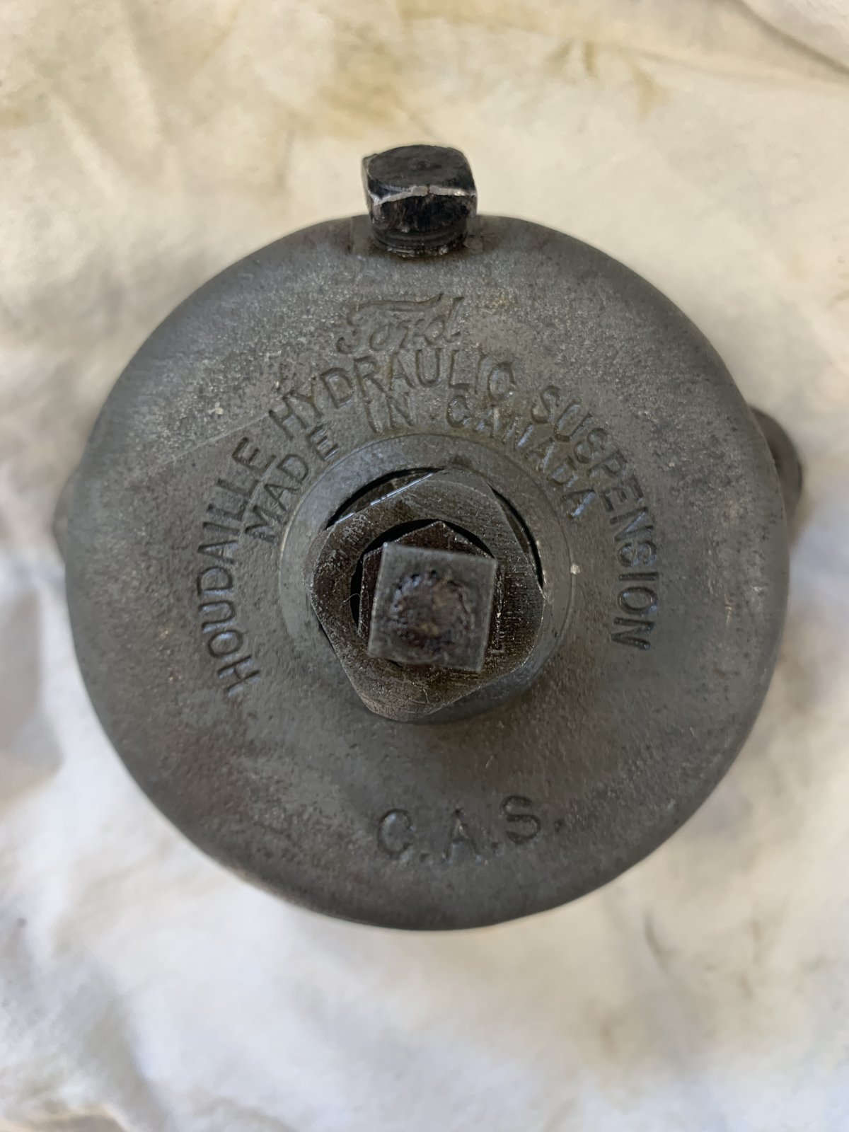

    Long overdue update. The front end is now basically complete. I had to get new perches and replacement spindles w new balls. I also added some hardware to the crossmember/frame rails just to be safe. I'm super pumped with how it is looking.
    Now I am working on cleaning and re***embling the Houdaille shocks. I've placed a few sets in the BBQ to cook for a few hours and then diss***emble. IMG_2406.JPG
    This image shows a shock on the left dis***embled after the BBQ. The shock on the right after cleaning in the ultrasonic cleaner. I used an ultrasonic cleaning solution for the first couple of hours and then a citric acid solution for the next couple of hours.
    The first one that I cleaned in the ultrasonic cleaner and re***embled seems to be working fine!

  26. Beanscoot
    Joined: May 14, 2008
    Posts: 3,681
    Beanscoot
    Neat! Did they make the Houdailles in both Canada and the US?
  27. wuga
    Joined: Sep 21, 2008
    Posts: 727
    wuga
    Houdailles, although of French origin, came to America at the start of the 20th century. They were first made in New York city but soon made the transition to Buffalo where they were made for a long time. They were supplied for both the US and Canadian Ford plants, but were never manufactured in Canada.
