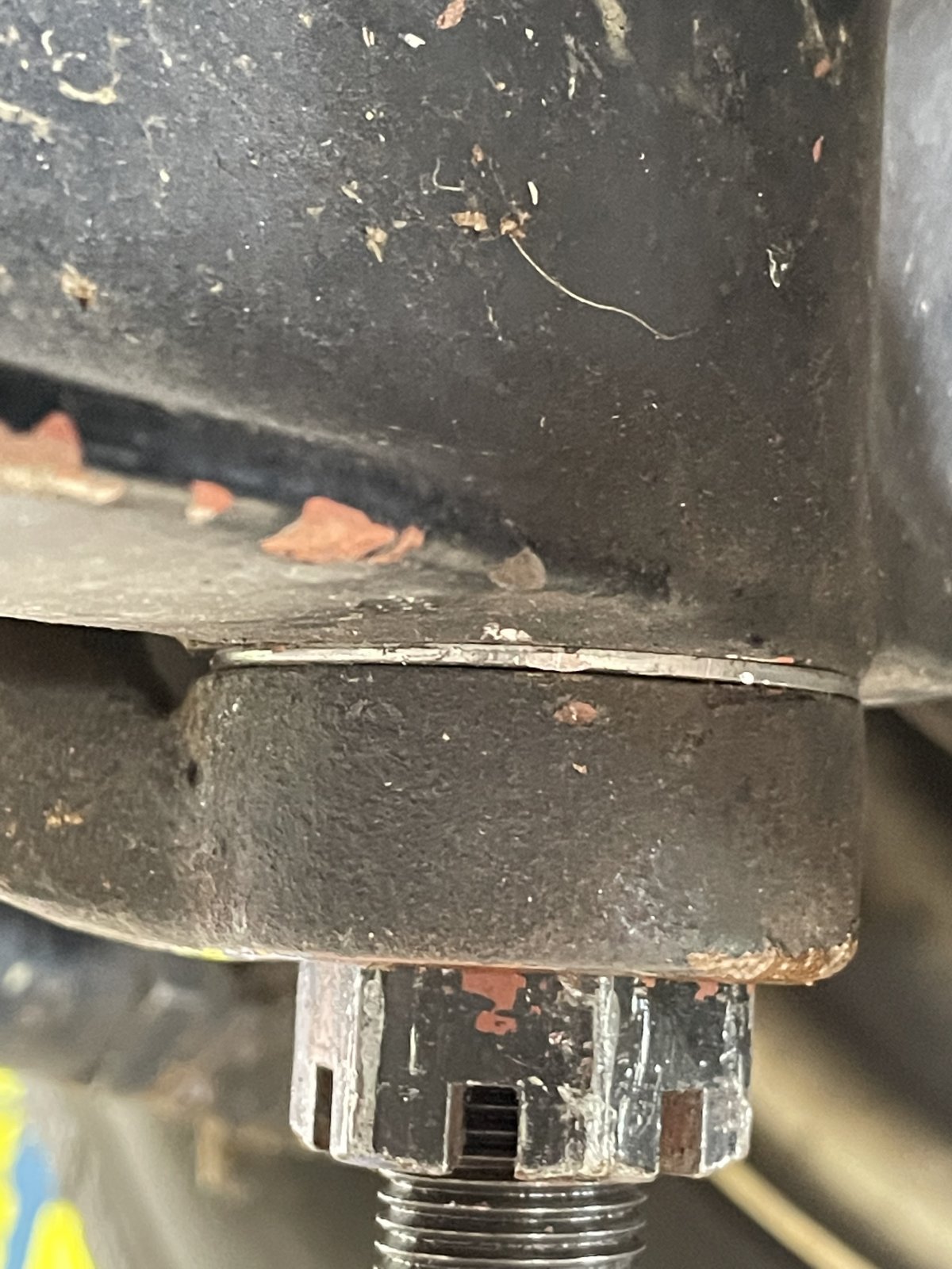

    Another thought: I just pulled my spindles off my sedan to do a brake change. They had been on there for 10,000 miles, with fresh kingpins back then. I found a few specks of br*** from the bushings had stuck to the kingpin, and caused s****ed ridges in the bushings. On the sides where pressure of the spindle sat from weight on the wheels. I had greased them every year, about every thousand miles. But I didn't jack up each wheel to take the pressure off as I greased. I will be doing that from now on.
    Maybe the OPs needle bearing kingpins won't have this problem.

    Its usually the top taper tha gets worn. I've put a large washer under the perch pin and that would tighten it up . JMO
