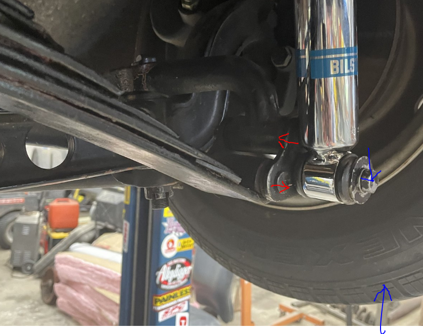

    It is "shackle wobble" Your photo [I attached ] shows the shackle angle as near vertical when the suspension is hanging
    When it is on the ground and loaded, the arc of the spring lengthens and the shackles are even more vertical.
    Either shorten the spring or add a panhard bar .
    With a cross steer you need the shackles almost horizontal
    This is because one side arcs downwards with suspension compression and the other side stays horizontal [stabilizing the axle laterally]

  5. Mimilan
    Joined: Jun 13, 2019
    Posts: 1,232
    Mimilan
    @Roothawg
    Also the shackle shock mounts are making it worse [actually triggering shackle wobble]
    In this photo the force and resistance is the blue arrows [the shock is creating a pivot through resistance]
    The shackle pivots "or cantilevers" around this shock mount creating lateral movement [red arrows]
    The shock needs to be mounted on either the upper or lower pivot [depending on available travel]
    Stogy and dana barlow like this.
  6. Roothawg
    Joined: Mar 14, 2001
    Posts: 25,794
    Roothawg
    Thanks. I can’t believe a Chassis company would design something like this. Ugh. I’m a suspension novice but I trust that when I buy something from a reputable chassis company, you hope they have it figured out.

  10. Mimilan
    Posts: 1,232
    Mimilan
    They are only a component manufacturer!! And rely on you being the Chassis manufacturer.
    That is how the "kick the can down the road" [liability wise]
    They make them to fit [thats all] You purchased them as it was a solution to shock placement .
    Yes. and preferable have the shock mount on the Axle / upper side if possible.
    Keep your longer spring because your ride height is already set where you want it.
    And add a Panhard bar which is preferable with cross steer

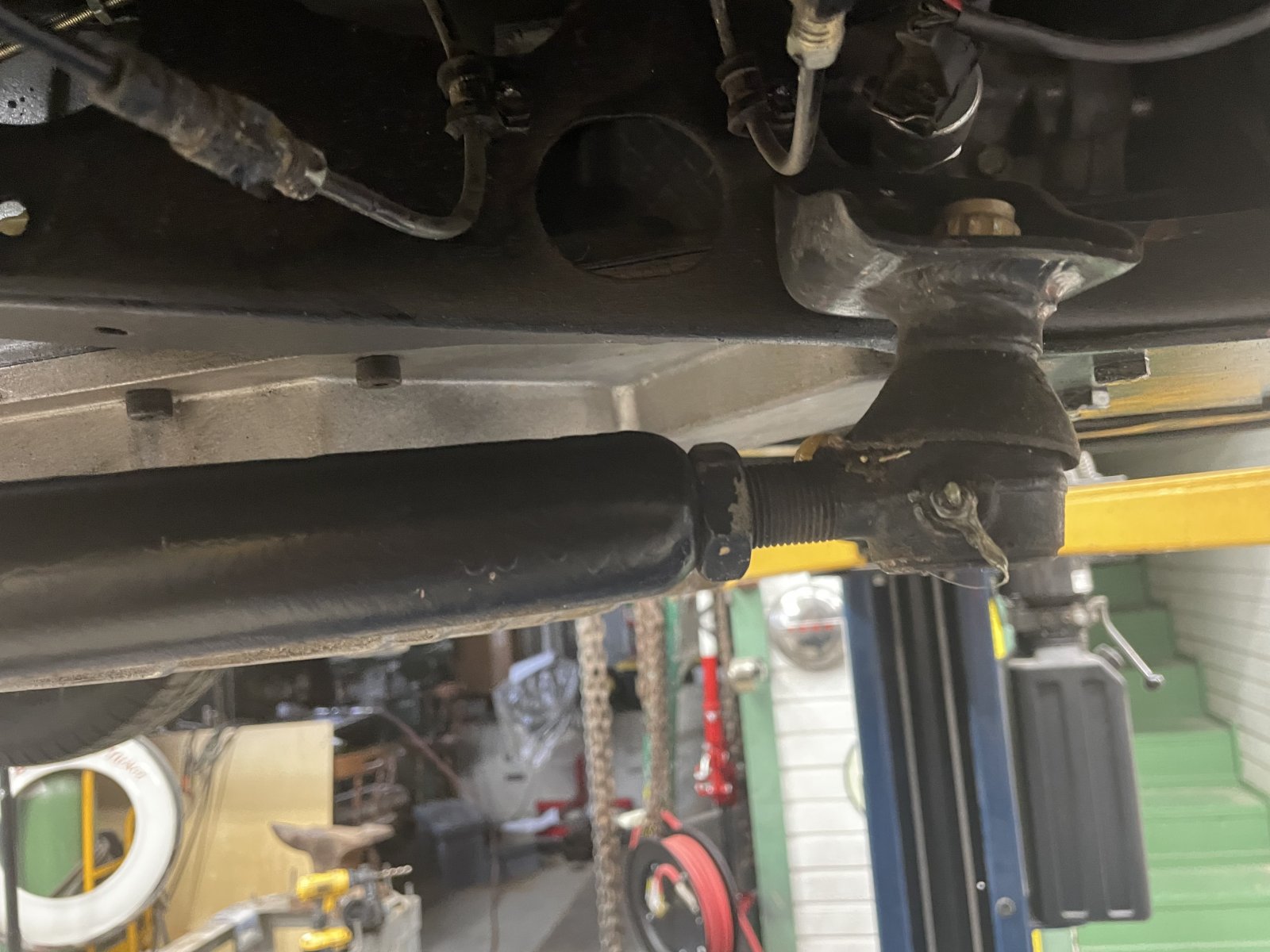

  16. alchemy
    Joined: Sep 27, 2002
    Posts: 22,281
    alchemy
    Adding a panhard bar would be the best answer. Also getting some wheels with less offset would help too. I bet after the panhard is installed, the long spring and vertical shackles will not be a problem.
    If you have enough room in between the "speed holes" that somebody drilled in that poor axle, you could easily install a bung to take one end of the panhard. Or attach a couple tabs to the inside of the wishbone. Then a simple hanging bracket down from the frame rail to mount the other end. Super easy to do with the truck up on the lift like that.
    While you are under there, check something out for me. Back the jamb nut off the rod end on the wishbone, and see if you can wiggle the threaded end. It doesn't look like you have a lot of threads into the tube. Hopefully that spot isn't a loose point.
    Stogy, bchctybob and olscrounger like this.
  17. Roothawg
    Posts: 25,794
    Roothawg
    Will do. I was thinking of moving the rod end deeper in the bones and moving the bracket up and forward a bit.
    Stogy and bchctybob like this.
