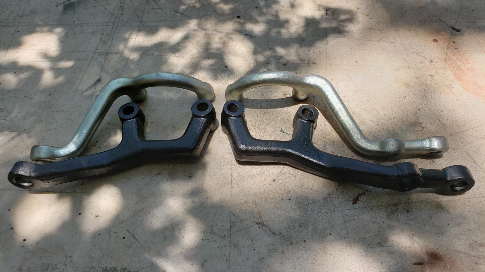

    I just finished working a wobble out of my newest build, a '31 roadster on '32 rails and can add just one more thing to this post: don't overlook the obvious...and don't ***ume anything. As was stated in Garpo's post, two or three small faults can combine into one big wobble.
    One other thing I learned on my own car was that the common aftermarket dropped steering arms can play a big part in causing this problem. There is a huge amount of leverage created by the deep drop, enough to cause the thin-ish arms to flex slightly, and as mentioned before it just doesn't take much.
    In the process of doing mine I switched to the Ch***is Engineering style dropped steering arms which are much beefier and make the drop in two shorter stages rather than one long one. Pete & Jakes carries these and I highly recommend them.
    Kevin Ardinger, Stogy and Roothawg like this.
  22. Roothawg
    Joined: Mar 14, 2001
    Posts: 26,042
    Roothawg
    I'm trying to remember what arm I used. I think it may be the CE arm.
