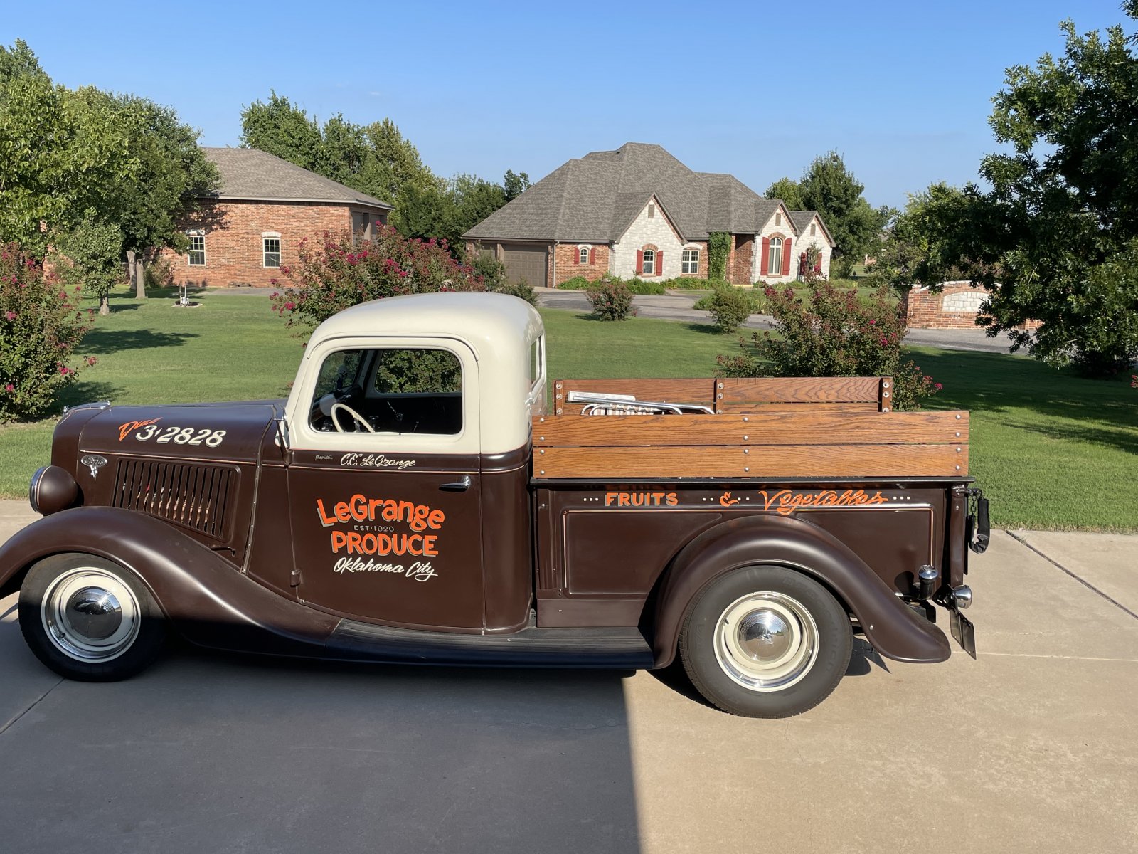

    Well, I am happy to say that the death wobble is gone. It was a combination of things, but the last thing I did was to mount up a new tires on the wheels I had up in the attic.
    We have a winner!
    I believe @Mr48chev was the first to call it. Therefore, he wins a massage from @Tman.
    This was very frustrating and laborious.
    It drives a smooth as a gravy sammich now.
    The only problem I have left is self induced. I ordered the wrong wheels. I ordered a set of Wheel Vintique smoothies, the rest are Wheel Vintique early oem vented style. The freaking hubcaps won’t fit!
    Oh well, I’ll see if I can find something that will work.
