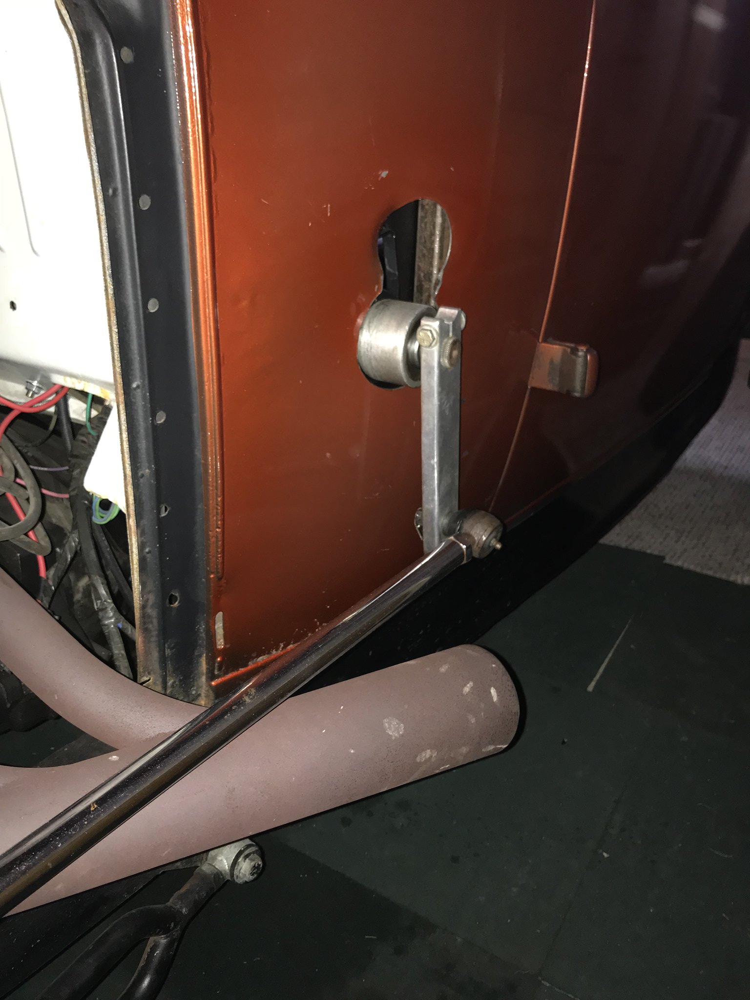

    The first stage of work has been completed down at a good friend Kelvin's place, Flying A Speedshop, here in the UK. This focused mainly on getting the steering sorted as it was very heavy with the 8:1 sprint box.
    We took cues from the rolling bones cars and remounted the box further down in the cowl whilst fabricating a raised steering hoop at the spindle so that the drag link is now parallel. This in turn meant Kelvin had to adjust the headers down to clear it. Along with this he also fitted up some new seats and did some remedial welding to the rear shock mounts and crossmember.
    I picked it up and had my first real drive of it a couple of weeks ago where I took it to the VHRA Vintage Nationals which is a little like the Antique Nationals you have over there. An all traditional hot rod drag event.
    In all I drove over 200 miles there and back with no real issues and ran a best of 13.7secs which surprised me. The motor is under carbed with the 3 94's and I left the trans in D for my runs. I have a 3 Rochester on an Eelco manifold set up to go on and will probably put a shift kit in the trans so that time should come down some. That was on crossplys too.
    The steering is much improved and I actally quite like the fast ratio but in honesty it is still heavy through the turns and suffers a little bump steer so I'm a little undecided if it will stay. I may try a 2:1 ratio steering quickener mounted backwards to see if it helps steering effort or maybe look at another box like a reversed late 70's F150. Dare I say it but the word 'vega' has been mentioned too!
    Anyway here are a few pictures of where I'm at with it. Next up is a roof insert, bonnet top and windows.

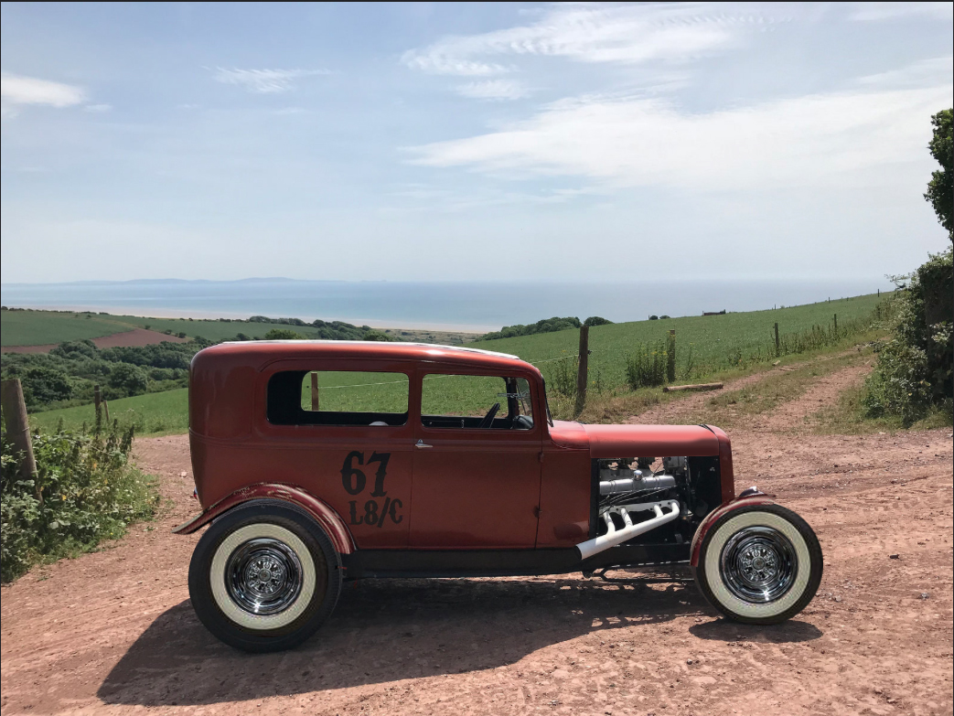

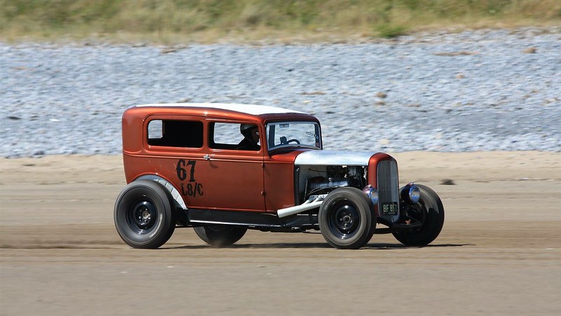

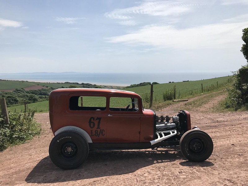

    Next stop was the Beaters reliability run that again saw the car run like a champ. As it was on Kelvins doorstep I left the car with him to carry on with the other work we had planned. A roof insert and bonnet top were needed along with the mounting of a slim ally fuel tank that will sit up against the rear panel and allow the fitting of a rear seat. Insert and hood were completed as well as a blister covering the hole from the repositioned steering box and the tank has its holes and ***ociated brackets ready for me to mount when I get chance.
    I picked it up just before Pendine, gave it a check over, and set off for darkest Wales. Oh I also painted the headers and rear wheel wells white to match the insert vinyl covering and to continue my slightly 60's theme.
    Again the car performed faultlessly and also got me into the 100mph club! I was quietly confident given the performance on the strip but man is that sand a great leveller! It never seemed an issue in the truck but having over twice the horsepower on that surface was a totally different experience.
    Still loads to do on it and some issues to sort but I can't be too unhappy with the start we have had! I think we are beginning to bond.
    Pictures courtesy of Gary Denham, Tony Bruce and myself.
