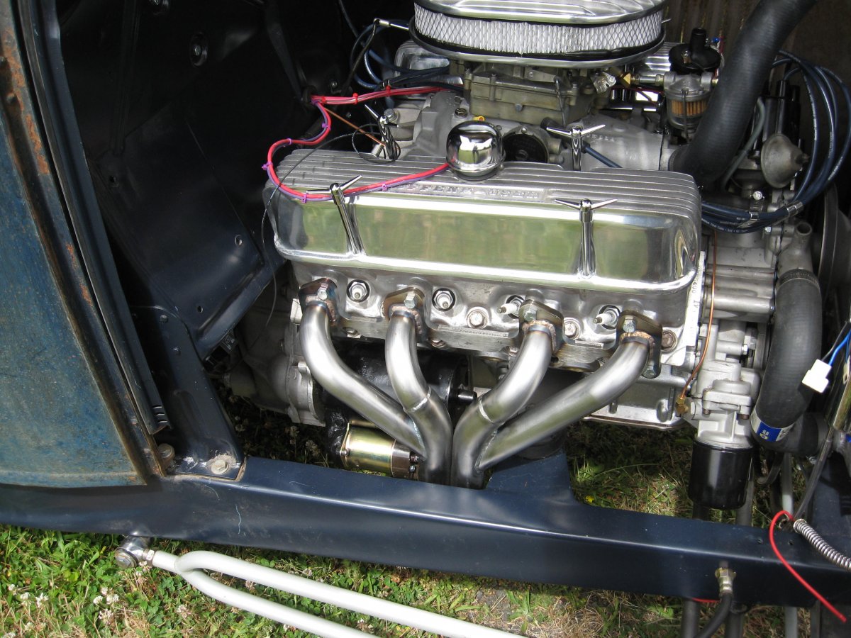

  2. Marty Strode
    Joined: Apr 28, 2011
    Posts: 9,707
    Marty Strode
    One nice feature about the 215 Buick, the front of the pan is only 1" deep, for the first seven inches. The distributor is up front, for added convenience. I have one for a Simca/Topolino project. IMG_7994.JPG

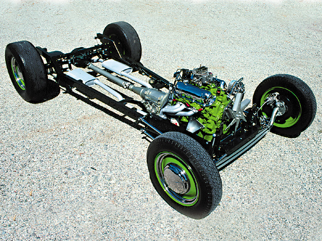

  29. Beanscoot
    Joined: May 14, 2008
    Posts: 3,681
    Beanscoot
  30. BamaMav
    Joined: Jun 19, 2011
    Posts: 6,969
    BamaMav
    from Berry, AL
    That is the same engine family as what is in the wrecked Ranger I have. It’s a German Ford design, started out around a 2.8 IIRC and eventually wound up being a 4.0. That pic shows how narrow they are, great for an early frame and be able to run a full hood.
    And that side view is what I have dancing in my head....simple, and fun....
