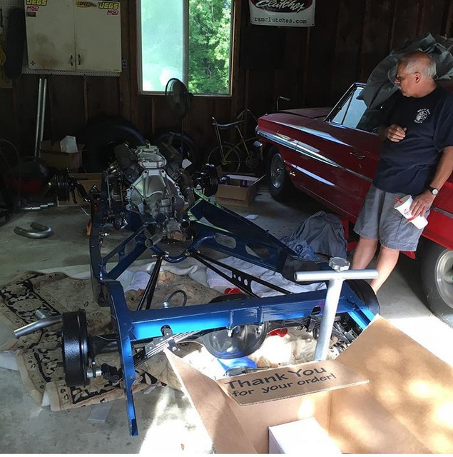

    This after dad and I finished the ch***is.
    Figuring out engine mount location. The RUFF 3 window gl*** body's first meeting with the ch***is.

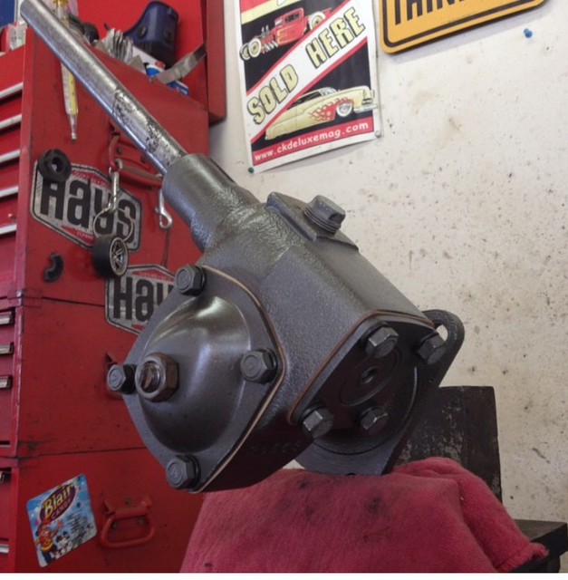

    Rebuilt my steering box. Surprisingly pretty easy and straight forward.

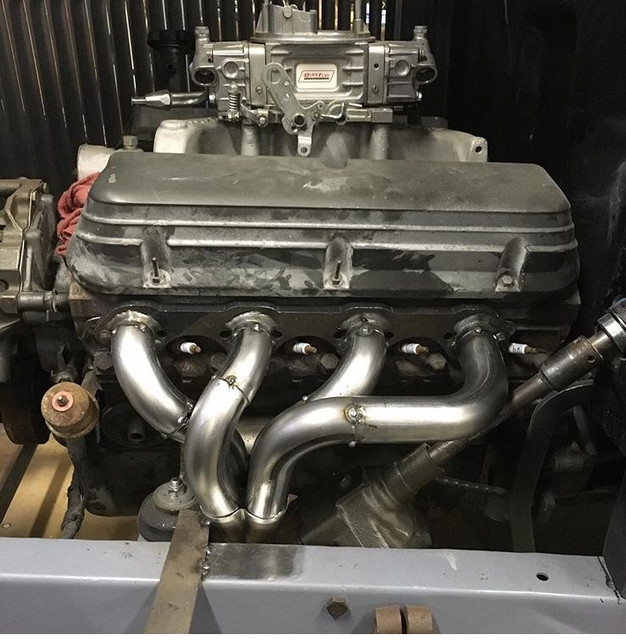

    Built my first header for the driver side. It was tight clearing the steering box and motor mount.

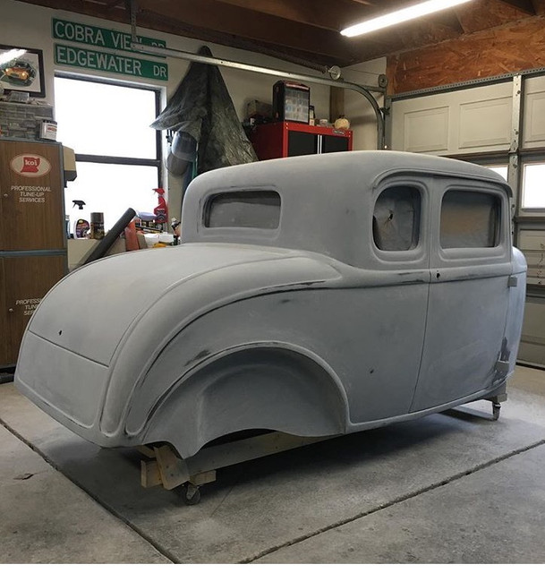

    This is my first time ever blocking a entire car.

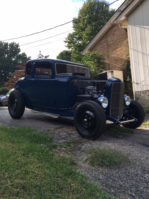

    She is wired and fired. All lights and turn signals work. Called my gl*** guy he is coming next week. I am waiting until Friday when I have my son to take it on its maiden voyage around the neighborhood. Going to make sure it makes it around the block then tie up all wiring neatly.

    Well it backed up the driveway under it's own power today. Loading it up tomorrow and taking it for an alignment. Should be cruising all weekend.

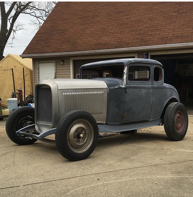

    Changed it up a bit.
