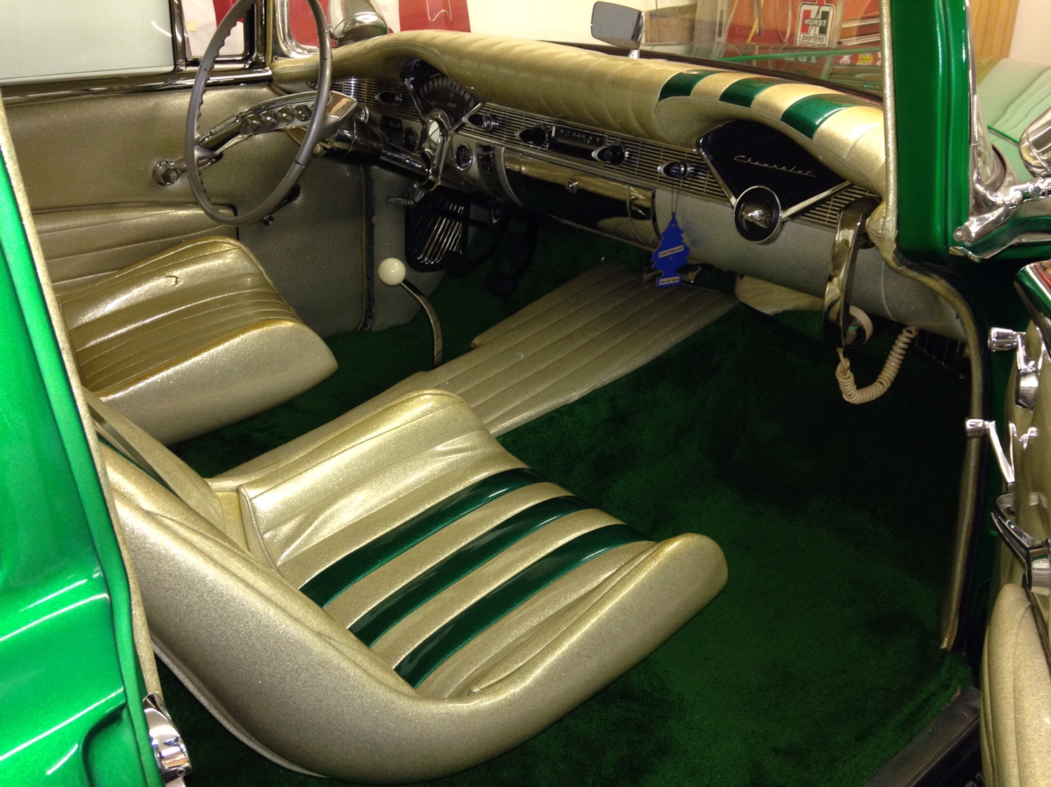

    Here's a motivational/inspirational piece my good friend @straykatkustoms did for me.
    Paint color will be a fuchsia, something similar to the first version of the Forcasta.
    I have the Starbird book and have spent some time studying it and the magazine coverage of Darryl's cars. I noticed that on the early cars the interiors were almost always white. I asked Darryl about that and he said the reason was so that the details would show up better in the black and white magazine photos. So, I want the interior white, maybe with some color inserts like above. I do have seats that I want to use, actually vintage chairs. They are Chromcraft "Sculpta" chairs just like these:
    I picture them with white backs and edges and colored inserts. By the way @stanlow69 will be doing the interior.

  24. Sancho
    Joined: Apr 24, 2001
    Posts: 5,036
    Sancho
    Thanks, @williebill
    I should also mention that when I sent stanlow69 a photo of the seats he came up with the brilliant idea of using the aluminum bases as corner stanchions (we intend to show this car in the Custom Hall at the GNRS).
  25. drdave

  28. Sancho
    Posts: 5,036
    Sancho
    Yeah, Chromcraft made several styles too. The Sculpta chairs are quite pricey.
    The first time I found a set of Chromcraft chairs, they weren't the Sculpta's and were considerably smaller.
    @stanlow69 was worried that they'd be tiny inside the car. He was right.
    The first set I bought had already been used in a car and had no bases but they were this style:
    After I found out the first set was too small, I found the Sculpta's online. I was a little worried about the price.... Once again it was my wife who said "Get them. That's what you wanted to begin with and you tried to use cheaper ones and that didn't work."
    God bless her. I am a lucky man!
