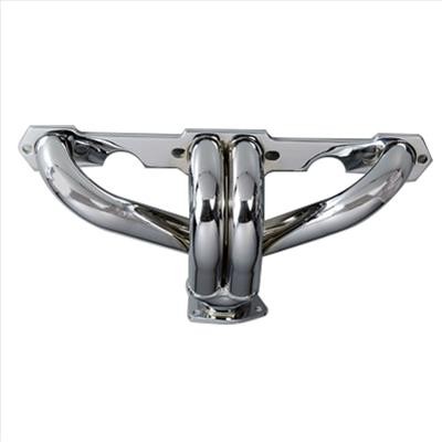

  17. HOTRODPRIMER
    Joined: Jan 3, 2003
    Posts: 64,583
    HOTRODPRIMER
    This is the style header I installed years ago, of course after 3 decades the chrome ain't too pretty but we all know chrome don't get you home. :D HRP
