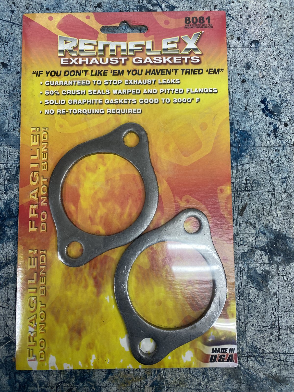

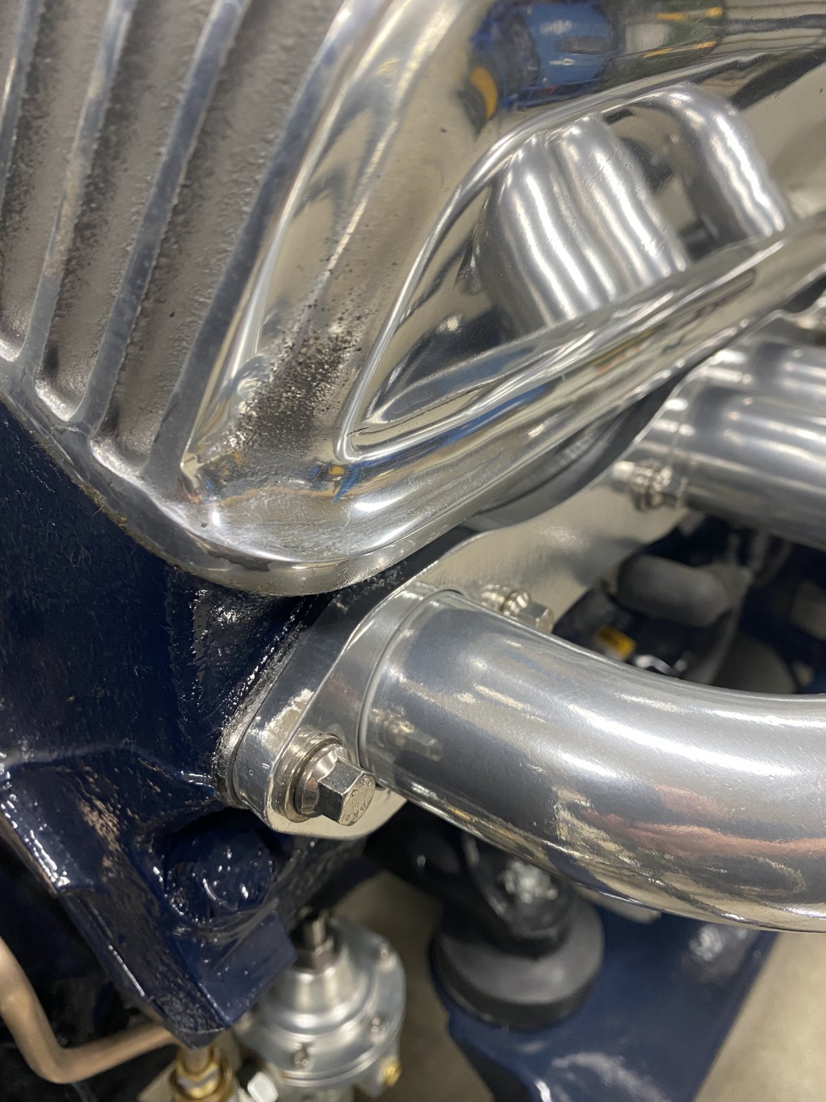

    They have a great many collector gaskets Danny and if they don’t have exactly what you need you can do what I did and send them a pattern for your collector gasket and they will make them for you.
    My collector flanges are custom 2 bolt flanges that I built myself so obviously there were no gaskets available for them.
    I sent them a paper pattern, they made them and they also assigned them a part number so that I could order others in the future which I have done when I took the headers off last winter.
    So, collector gaskets are easy Danny. :cool:
    My own personal collector gaskets with the part number.
    As far as reusing them goes I don’t worry about that it’s cheap enough to replace them, I was more concerned with reliable sealing than reuse.
    When I took my headers off the Remflex gaskets had to be scraped off the heads as they came apart when removing the headers as you would expect from a high temperature graphite gasket however they don’t fall apart or burn out or leak in service.

    As many others posted; remflex are great! I swapped my leaky copper header gaskets out with remflex & have had no issues with them.
  8. I used to make my own copper gaskets, one port type since it was hard to find a large piece of "scrap" at work. I'd stack them up, held down to the milling table and crank them out. I used .050 electrolytic copper.
  9. Jeff Norwell
    Joined: Aug 20, 2003
    Posts: 15,175
    Jeff Norwell
    MODERATOR
    Remflex.... just the Best.

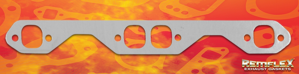

    I've never had good results, or long lasting sealing using the typical header gaskets. Even the thick ones never lasted as they just didn't seem to stay tight, and are too soft.
    Years ago I bought a pair of fenderwell headers for my build, and they came with the factory style "cheap" shiny metallic looking gaskets. I thought at the time they were a poor gasket supplied because they were cheap to make. But I put them on during cam breakin, and figured I'd replace them later.
    They've been on the engine over 8 years now, and all I've done was check the bolts once they'd been heated up a couple times. They've never leaked, and I use this style on all my engines with headers now with the same results.
  11. Larry, are they available for vortex heads?

  24. Gaskets arrived late yesterday and I am happy to report that after replacing them and initial firing the engine there is no longer a annoying TICK, TICK, TICK but I did hear a new Loud RATTLE which I was able to diagnose just by walking behind the old beater, the passenger side chrome tail pipe extension was loose, put my foot on it and the rattle went away, grabbed a screwdriver and the a couple of turns and the rattle was gone, whew! I'm happy that was a simple fix. HRP

  27. The non ticking kind you suggested. :D HRP
