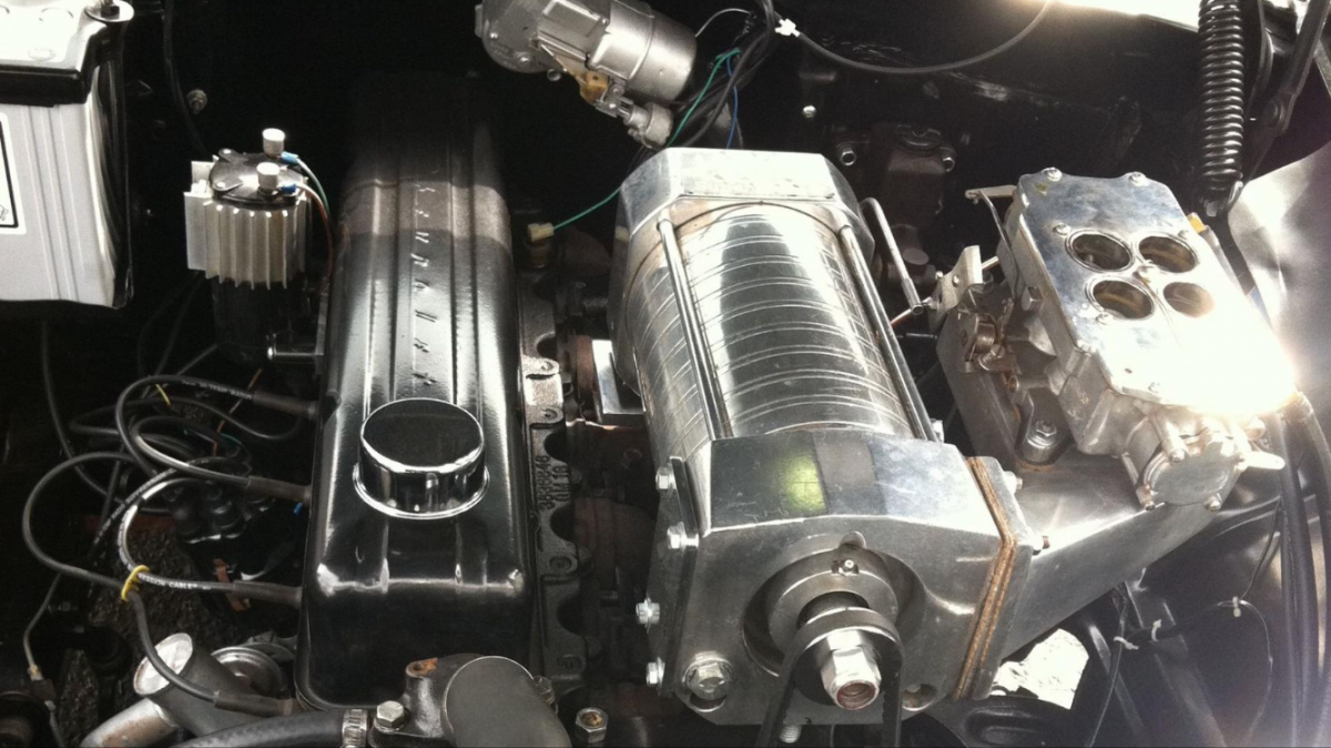

    Here is a Latham on a friends 56 BelAir 6 cylinder. Thing about Lathams is they don't start boosting until they reach 30,000 RPM's. Got to have the big *** crankshaft pulley and the little pulley on the Latham.

    @brandon B, that is an interesting modification to the Autolite 4100 on your friends engine. The choke horn was eliminated by machining a new top for the carb, and it looks like tubing was added to direct the air flow into the venturies.
    The other thing I notice is the ny-loc nut on the blower pulley shaft. The shaft looks to be real short and I think a half crown nut would have been a better choice.

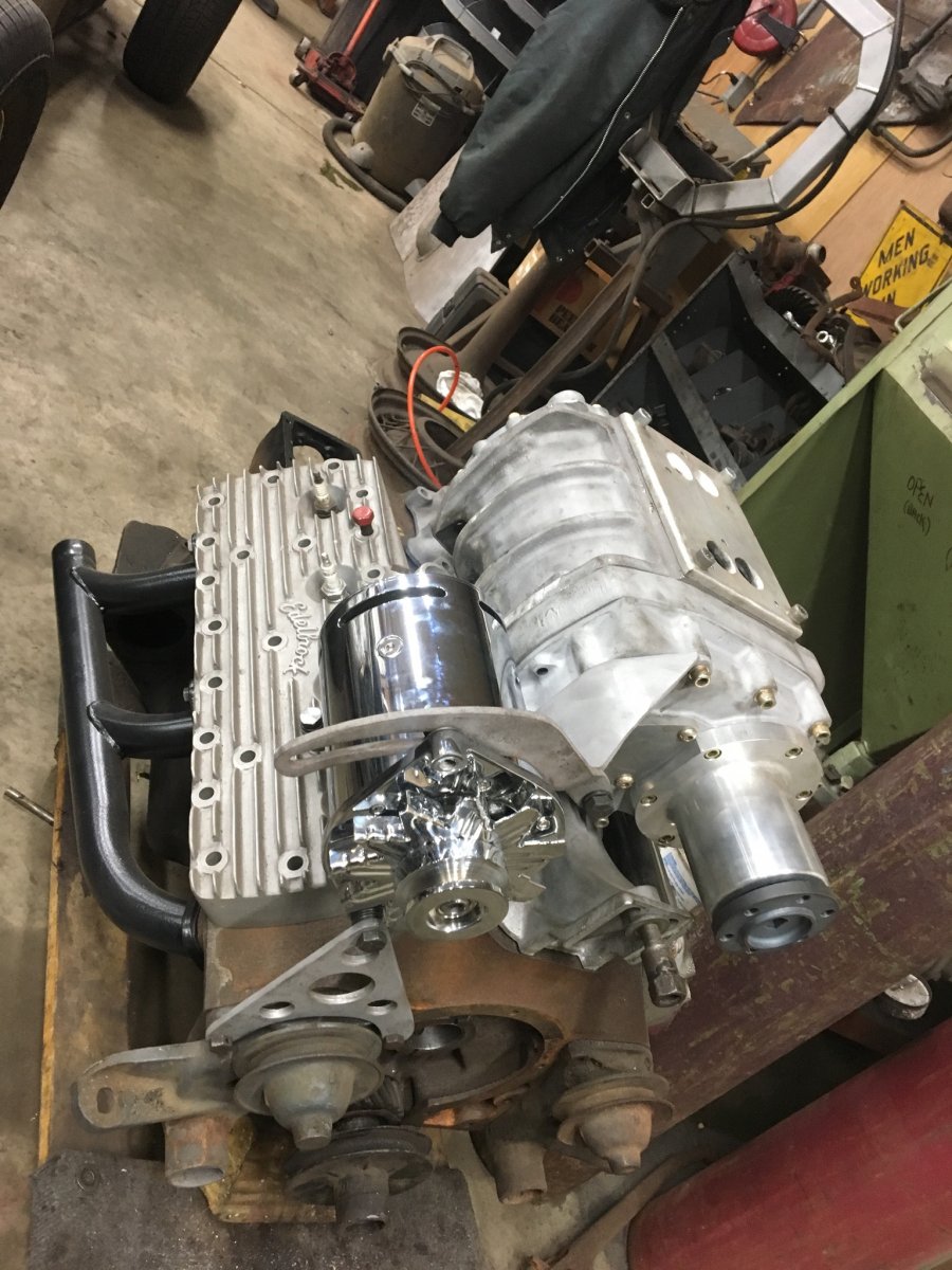

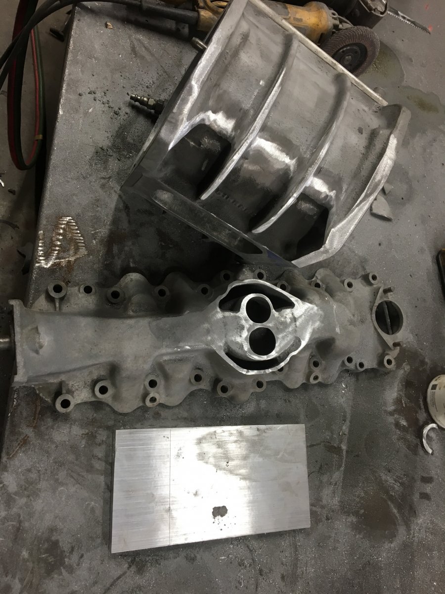

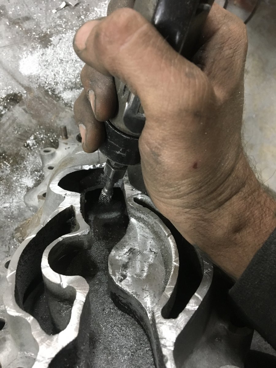

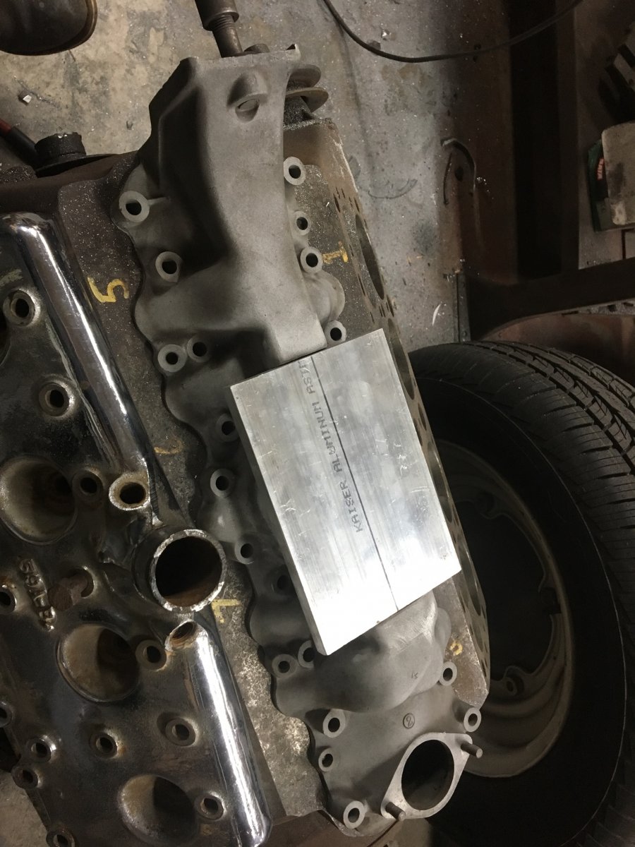

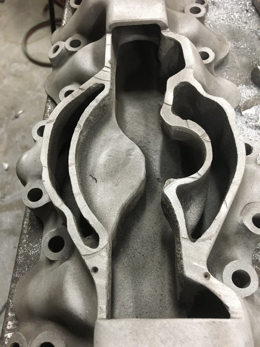

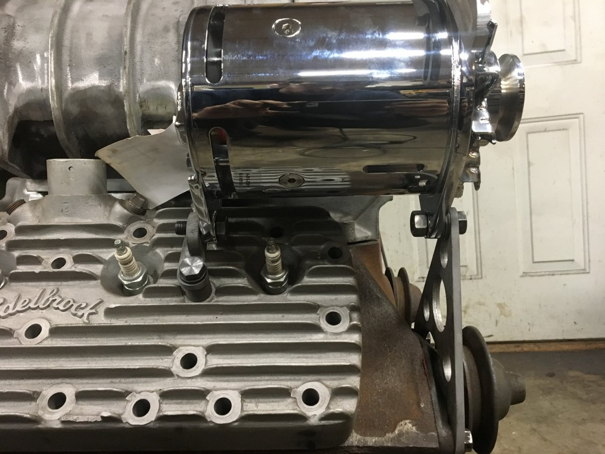

    Here’s a pruned 371 I’m building for Flathead v8, the completed setup will run dual 5/8” v belts. Still machining the blower and generator pulleys.
    EFC74B3A-67F7-40B9-97DD-27F0DB5B6BC0.jpeg DB9DB43B-2111-4002-95B9-5CC7ADDBE21F.jpeg 844CF562-2142-44E9-9A11-4A84B7D35CD2.jpeg 0D3670B9-7DB0-401C-BF57-9544513112C7.jpeg 11DE8362-D0A2-4894-B50A-10CDC7D43CDD.jpeg 4F24E0B2-A9D4-4C70-A046-A0B3B727BCE5.jpeg 5FD22BF8-75EB-4117-AC50-BAB09BC93BEE.jpeg 3921D5D2-837B-441A-871A-4886AF45B5BD.jpeg

    Mel put together that carb specifically for this application. You're right he machined the new top for the carb and did other modifications.
    Yes
    He also has another Latham on a 30 roadster running a flathead Pontiac straight 8. But wait, that's not all. He has a 34 5 window running twin, as in 2, S.C.O.T. blowers on a 394 Olds with 4x2's. He put that together in the late 60's and has been driving it ever since. He drove it to his 50th high school reunion a couple years ago.

    Thanks, just a nice simple, compact setup that should pull like hell and still be reliable, going in a 29 coupe

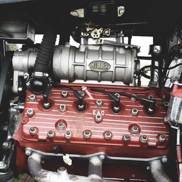

    Somebody applied a Miller logo to that thing but it is really far removed from being traditional. Looks like a Weiand. Harry Miller used centrifugal blowers but never a Roots type.

    The fake blower badge goes well with the pinstriped stock heads

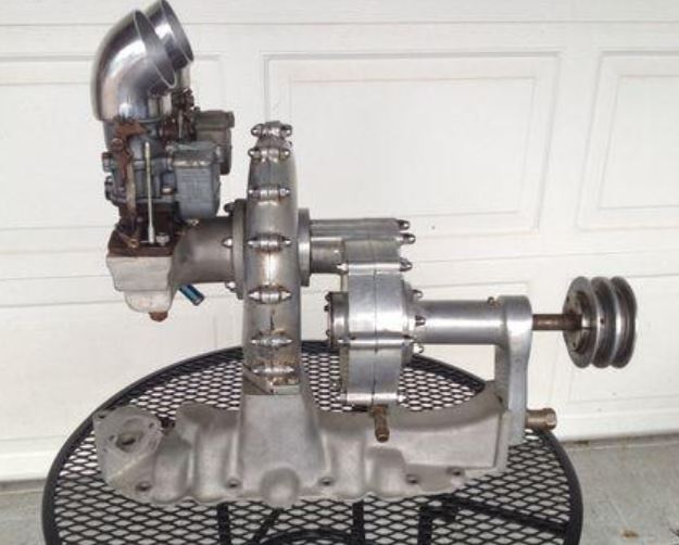

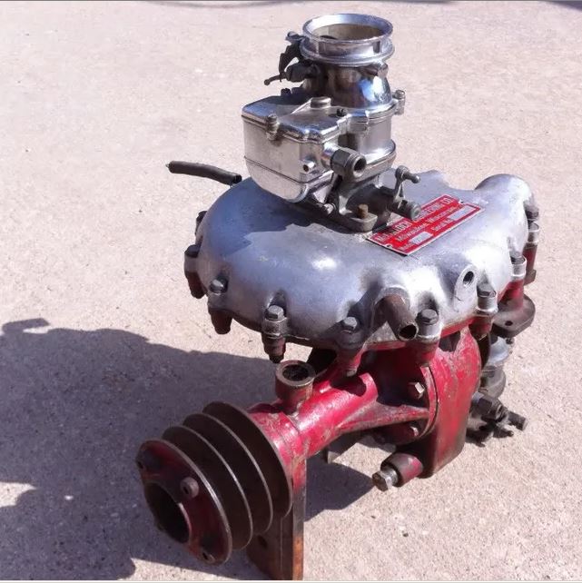

    Navarro blower setup, thought to have first run in either late 1946 or early 1947.

    Barney Navarro did first install a blower in that time frame but it was a GMC 3-71.
    The Frenzel supercharger shown was introduced an late 1949 or 1950 and that particular one was rebuilt by Keith Tardel.​
