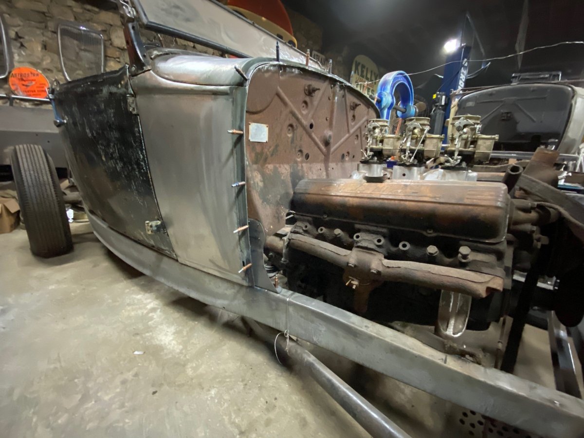

    Spent some time yesterday and drilled all of the spot welds out of the 32 firewall flange and feet and trimmed the corners of the firewall to match the shape of the Model A cowl. I also had to trim the firewall feet and braces off of the subrails to slide the 32 firewall back in. I also trimmed almost half of the Model A cowl flange off to reduce the overhang over the firewall. I may trim it back even a little more. I'd like to try and make the cowl bolt-in like a stock affair if possible. I need to weld new flanges back on the 32 firewall in the sides and corners to match the new radius next and then work on how it will bolt in. Either way I figured I'd share some sneak peak photos ahead of the video here. I'm really excited for this part of the project. Been thinking about it for years!

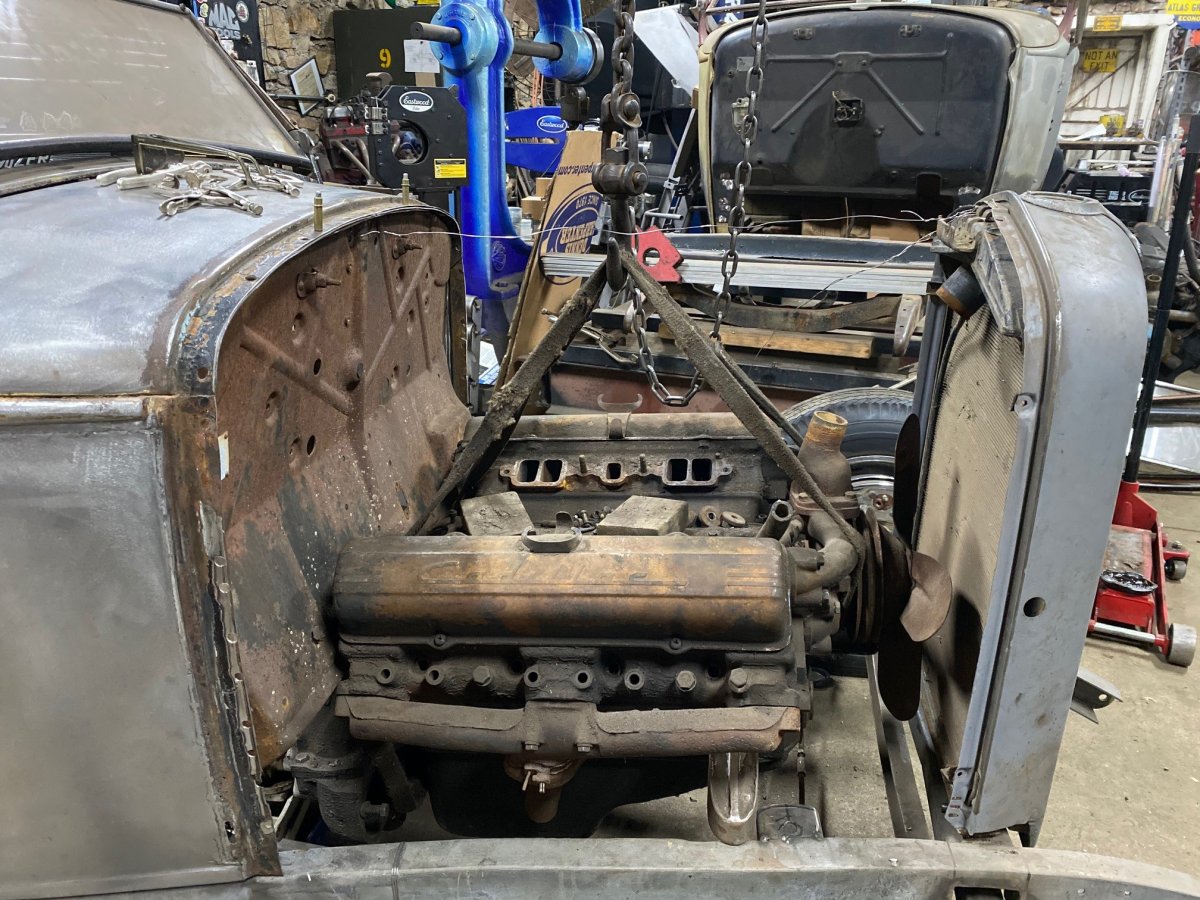

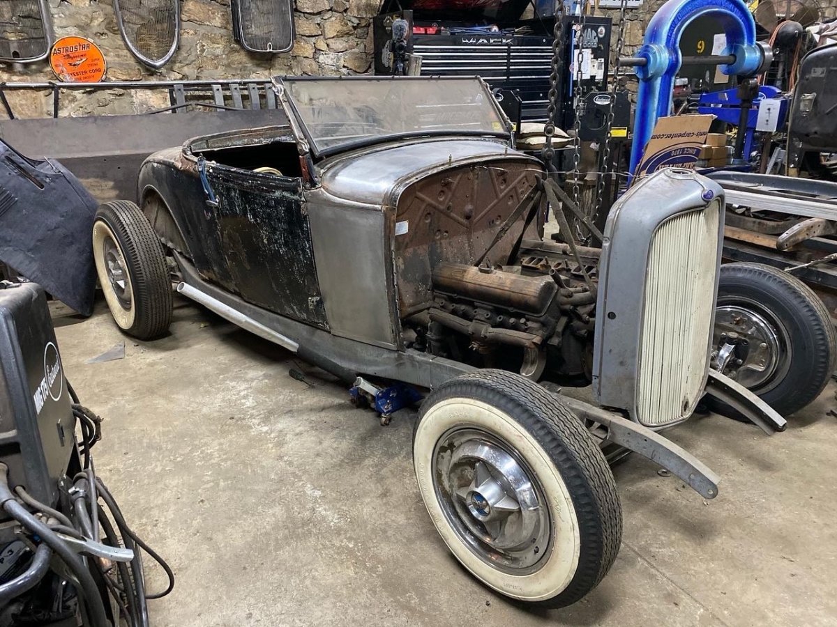

    Working on moving things around to squeeze the Caddy engine in with the factory fan and a stock 32 radiator and grill. I trimmed the bottom edge and "recess" off the center of the 32 firewall and we're in business. I need to just adjust the firewall a tiny bit more to get it sitting straight up and down but I'm happy with how it's all sitting for now. I'm going to move the motor mount brackets back accordingly this weekend and reconnect my trans mount cradle; but we're darn close!
    There's something so satisfying about making so many different parts all fit together and look stock-ish. I need to figure out firewall feet after the engine is bolted back in. I'd love to section the stock feet but they're a little crusty and I may have less time into making new feet that are a bit more simplified. I'll let the car tell me what it wants when we get to that point.
    P.S.- The engine will sit a tiny bit higher once I fit the motor mount biscuits back in and that should get the fan closer to centered in the radiator and more clearance from the front cross member. Just was a good stopping point at the end of the night.

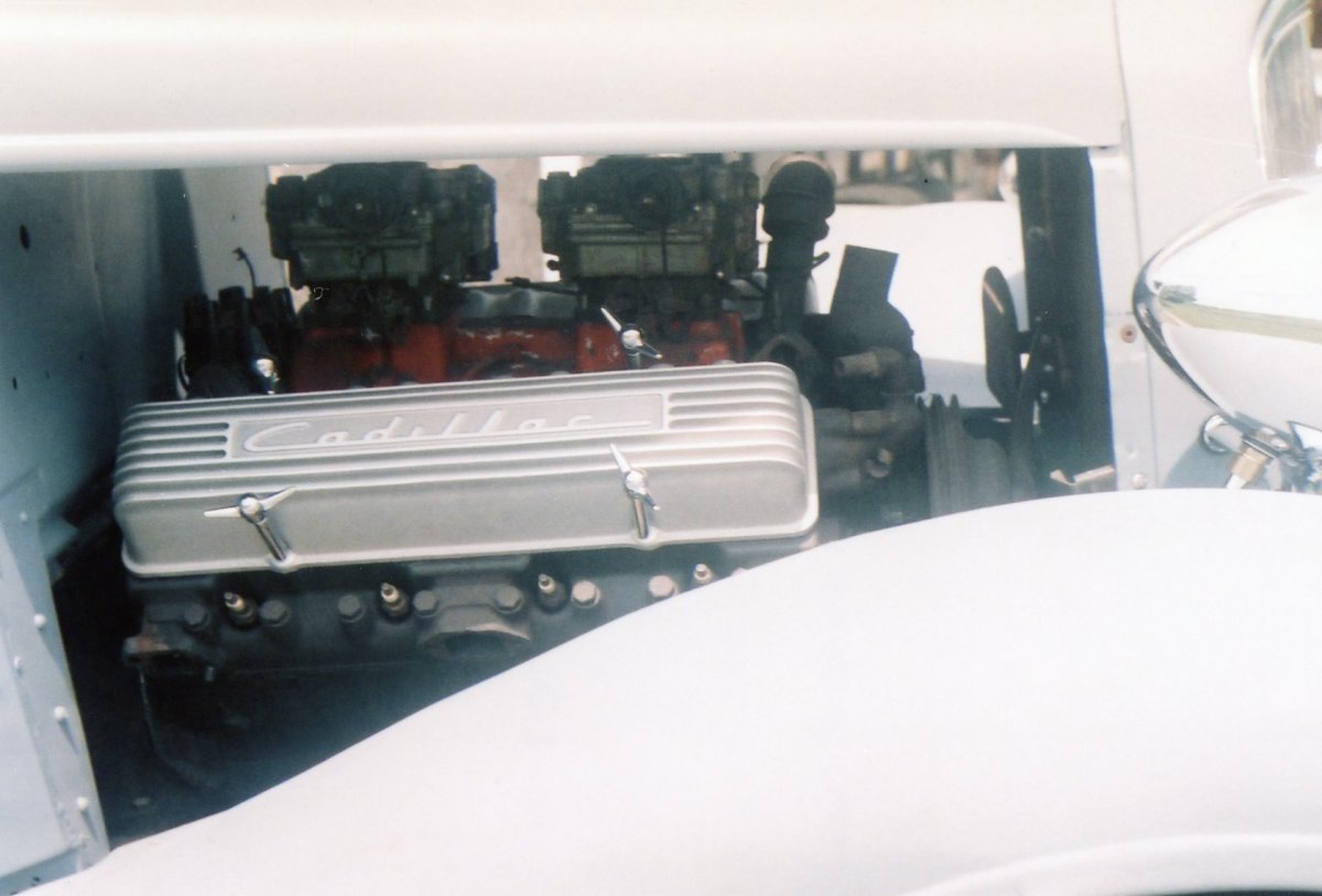

    Been following your build on YouTube. This will be a cool Hot Rod, when finished. Great engine choice......I'm putting a 331 Caddy in my 34 Chevy, although, I now have a 390 to replace it.
