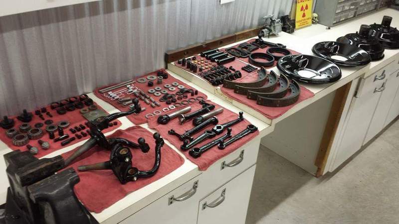

    Here are all the frontend parts ready to go back together.

    Bryan also taught me how to rebuild the factory Model A shocks. It is quite a process that begins by breaking out the Kroil to be applied along the seam of the front “cover” and the cast “base”. Let them soak for a day or three. When you are confident the Kroil has done its job, fire up an old BBQ grill and get the coals HOT!
    This, I have been taught, is a good time to crack a frosty, adult beverage open.
    1st… it gives you something to do while the grill is turning into a broiler
    B… it helps with the timing of the process, as you want to make sure all parts are equally heated
    Thrice… repeat beverage intake for each shock body going into the grill
    Cuatro… after a couple of shocks, if you happen to burn yourself, it won’t hurt as much
    After the grill is up to temp, bury one shock “body” into the coals, so it has time to think about how easy it’s gonna come apart for you, then set a timer for 20 minutes. Having some big, thick welding gloves to cover your digits comes in real handy during the next few steps.
    When the timer dings, pull the shock body outs the grill and take it right over to a vice and clamp in it. Then grab a big Channellocks and unscrew the front of it. The innards should be loosened up by the heat aaand whatever was still inside there, is nothing but charred gunk now. Let that one sit in the vice.
    Grab your next shock body and repeat the process. Your beverage should be empty by this point, so a new one will be needed to complete the timed cycle as planned.
    Now, go over to the vice, which has been acting as a heat sink for the dis***embled shock body, and remove it.
    After a short while, all shocks should be laying in pieces and cooling off. From there… Clean, blast, fit the innards, ***emble with Model A shock fluid, clean, prime and paint. Here are one set of the originals that we did. Also shown are the shorter dog bones that I bought thru Mac's.
    And finally, all the parts back together. Amazing that the only non-original parts in this pic are the linings and the grease!
    To be cont…
