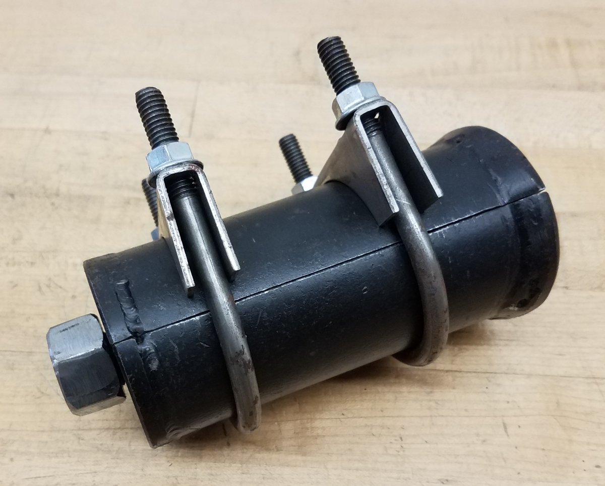

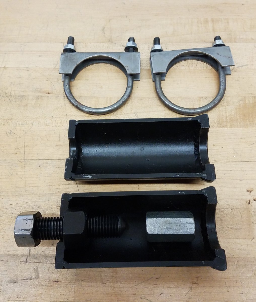

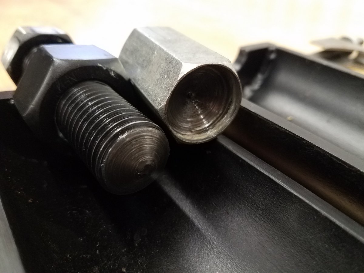

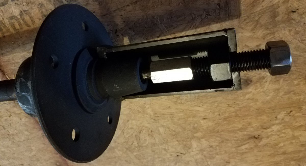

    Time to get serious, baby! I sauntered over to my toolbox, with full intentions of pulling the ace out of my sleeve. I gave a decent yank on the lowest, biggest, heaviest drawer, and a slight groan emanating from both myself and it. Reaching in, the cold steel of Big Tony immediately found my fingers and a smile curled on the edges of my lips. It was like shaking hands with a good friend that you haven’t seen in some time.
    Big Tony is my ever-faithful-homemade Ford Hub Submission Spe******t. If he could talk, I’m sure a sudo-toughguy yet whimsical, Brooklyn accent would be prevalent. He’s a 3/16" thick pipe that's about 6” long and 3” in diameter... cut lengthwise with ¼” thick steel welded sides and a 1” nut welded inside one end. The little girly “hammer-nut-drum-remover” that Mac’s sells (as a hub removal tool) resides inside of Big Tony and is machined to match the taper of the end of the “pusher”... which is a 1” threaded rod with a nut welded to it. The interlocking tapers do not allow for any side deflection, so it can’t “walk” when it’s doin its thing. The muffler clamps employ the task of holding both halves together when engaged onto the hub, so it can’t deflect like the other puller had tried to do. Sure, you could spend big bucks and just buy a similar one… but it’s much more entertaining to fab one up and then name it… but only after it has proven its worthiness to its maker!
    Here’s how he does his thing… The girly-hammer-nut is threaded onto the end of the axle, then one half of Big Tony is engaged onto the hub groove and the rod is threaded into the machined end of the nut. Then the other half is installed, and the muffler clamps are fitted around the whole ***embly. After that, you just let the impact wrench do the clockwise boogie until Big Tony pops the hub off the axle.
    Here’s a recreation of how he clamps on. (No hubs were harmed in the making of this shot, nor any other removals)
    As I brought Big Tony over to introduce him, Bryan’s eyebrows raised and something akin to admiration escaped his lips… “HooHoooo!” I clamped Big Tony into place and with a few good gack-gacks, we were rewarded with a loud POP! Heh heh heh!! Big Tony ROCKS!!!! He obliged us by repeating his amazing feat on the other side and then he was laid back in his home… to patiently wait until another hub thinks it’s gonna kick my ***.
    To be cont…
