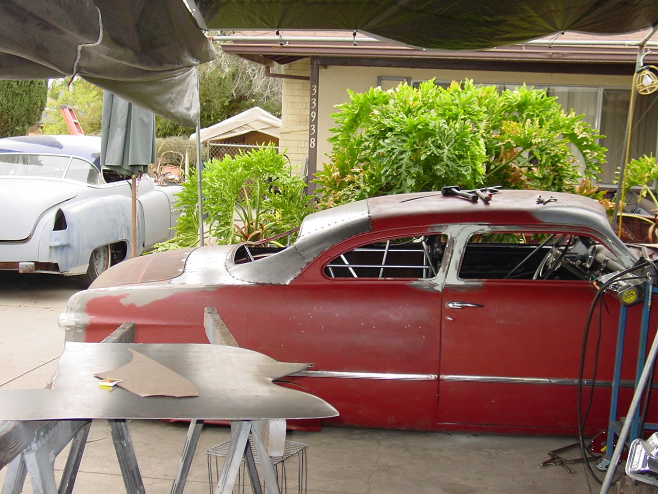

    Work continued on Shoebox #1. The upper crowns at the upper corners of the rear gl*** are being formed and tacked in place. Some might ask "why do it in several pieces?"... Its actually easier, and the shaping of the panel can be more accurate. We do add/finish the roof off with 18ga, which is similar to stock. It can be tough to work with on the english wheel, so smaller parts make it easier during the fabrication process.
    The lower sections and the continuation of the rear panel below the rear window to be started tomorrow. This should be all tacked in, in the next few days.
    Stay Tuned!

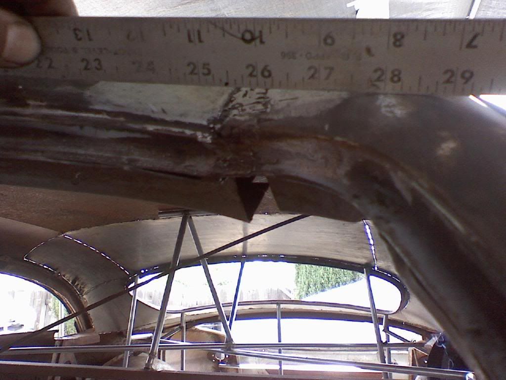

    Were off to repairing the windshield surround on Shoebox #1. It had alot do be desired. There was no way gl*** was going to fit in it properly without breaking.
    Both the A pillars were re-cut. Old lead was heated and removed. Its amazing that some folks think that lead is a good filler, it is on 'old school' terms to skim or lightly fill, but not in the forms of 1lbs per square inch. :) ... and not if the panels aren't properly aligned.
    The upper and lower corners were cut out so both upper and lower pillars could be moved for re-alignment.
    You can see during the process and measuremnts, it needs repaired.
    Here we go!
    B-Pillar realignment.

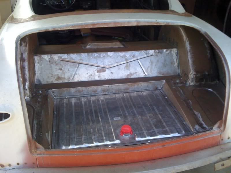

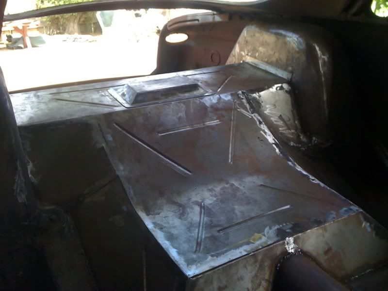

    Norm, just was finishing up the custom floor on my shoebox (shoebox#2) Car now has a 16 gallon tank instead of a fuel cell, like it had beforehand. Also has all kinds of trunk space and provisions to run a rear seat which it didn't have before. The custom grille surround is in progress, it'll be a merc style surround w/ rounded hood corners, and the car is having 51 hinges modified to work so that I don't have to run exterior trunklid hinges like it originally had.I'm so happy with all the work Norm's done on my car and am excited to see it turning into the custom that I've always wanted

    Man I went from a cell to a 16 gal mustang tank like yours. It eliminted a ton of h***les and freed up lots of trunk space.
    If you need a used filler pipe I've got extras, also a really cool bob drake flexible filler hose goes between the tank and the pipe $24 and it makes it way easier to fill the tank. I gotta pick one up!
