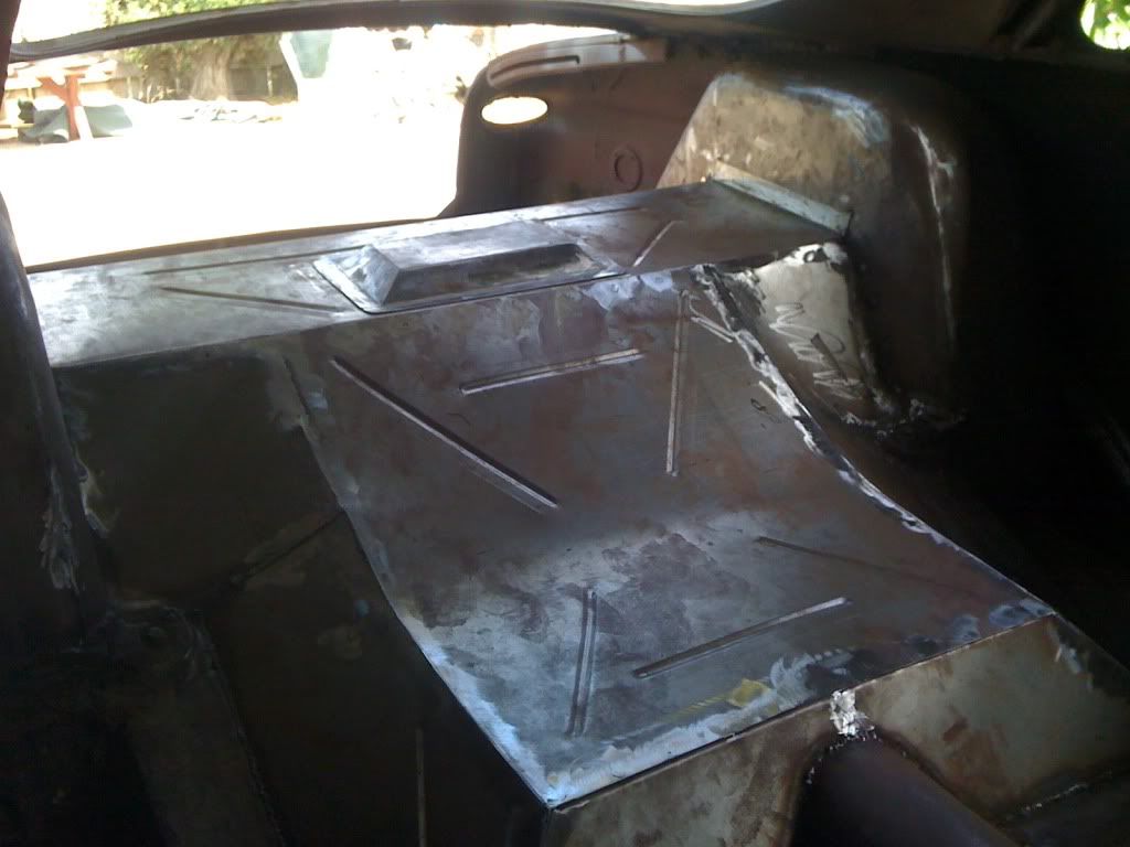

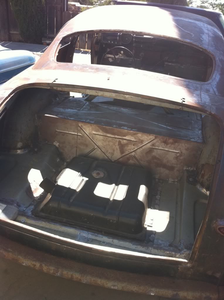

    More updates, the floor in Shoebox number 1 is completed. Fabbed up the floors we cut out, and welded them back into place correctly. The gas tank was provided with the car, so we mounted it in the middle with a double layer ring of 16 ga steel mounted around it for further strength and easy to use screw down brackets to hold it better in place.
    The 'hump' over the rear end has been boxed in with covers to gain access to air bag equipment underneath. Ease of repair is always the best in any build!

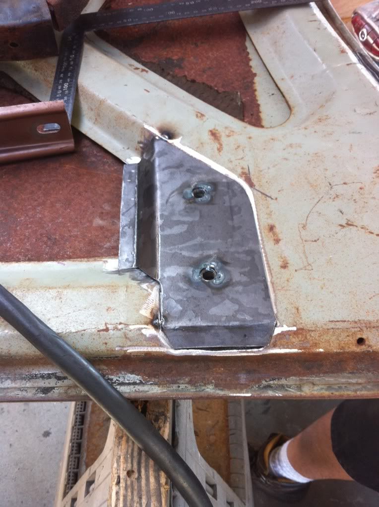

    Converting those hinges to inside the car? We made these brackets to simply weld in place and screw from the outside, to the decklid to accept 1951 Ford trunk hinges. Need some? :)

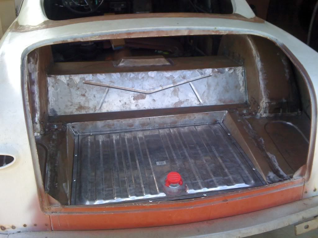

    More Floors! Got the floors (completely fabbed) in Shoebox #2 completed with the install of a 1968 Ford Mustang tank. Its the best change you could do, especially if they are like this one which lays solid body/frame on the ground. Definitely happy with the results and so is the owner!
