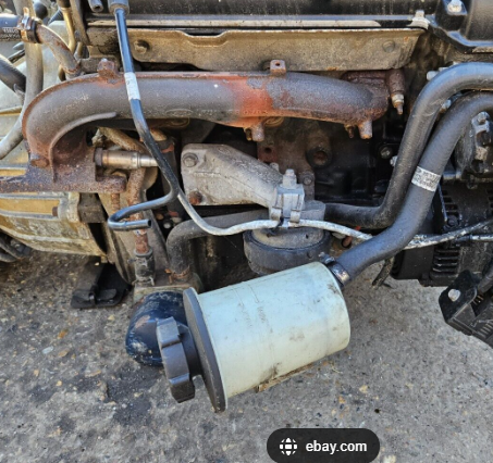

    I have a ‘00 Chevrolet 4.3l from a s10 zr2 sitting in my garage with the factory remote oil filter system.
    That might be all I am allowed to say here.
    Let me know if I should pm some pictures.

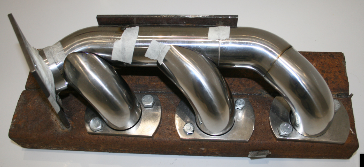

    so originally the filter comes out of the block this dont work as the later heads put the header there so the filter needs dropping out of the way
    where the filter is it hits the wishbone
    where that header flange is - it hits the steering box
    need to make a header similar to this

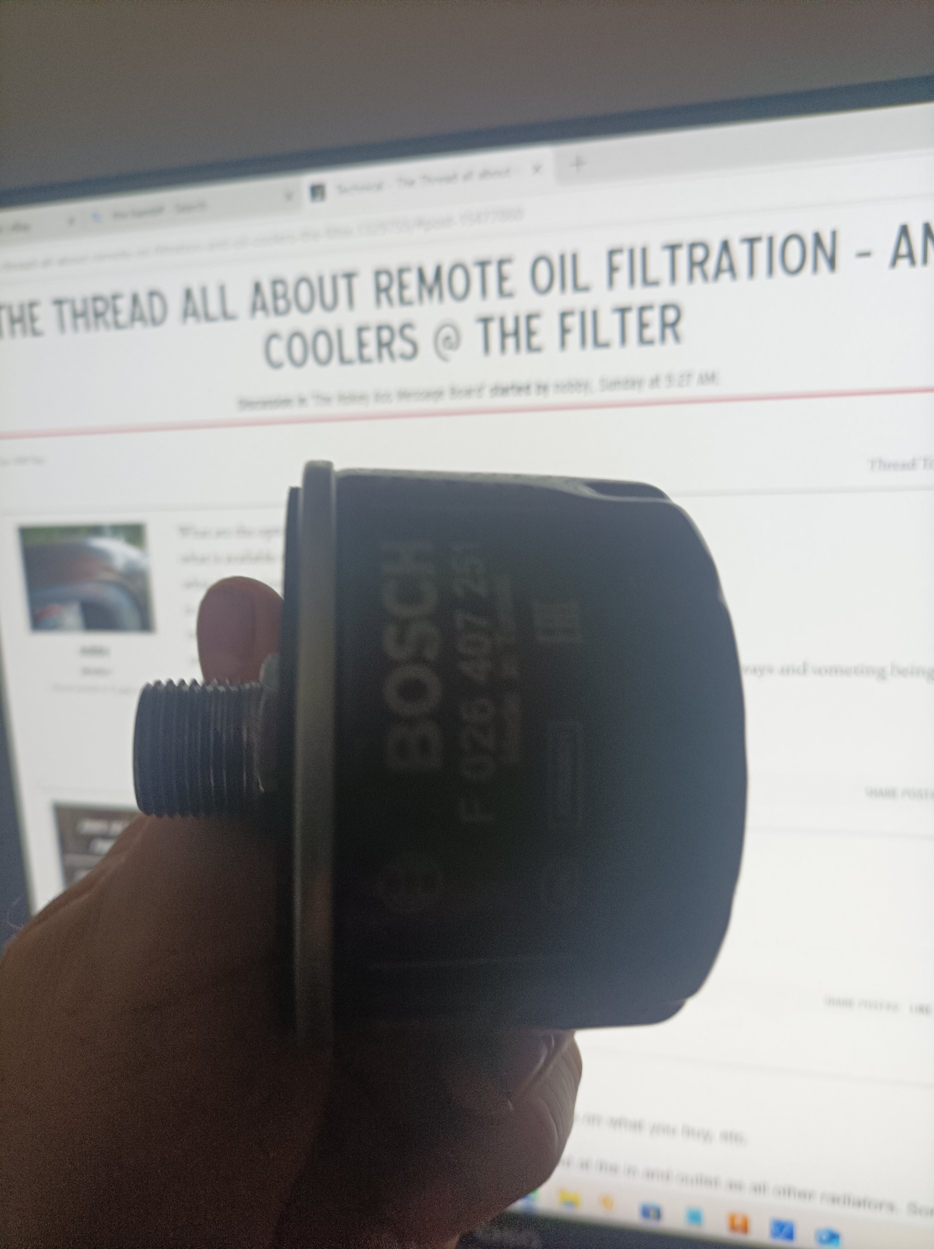

    little filter its only 2 inches deep 3'' round
    P7251
    F026407251
    it being 3/4 unf = confirmed with threaded adaptor
    cannot run engine without a filter.
    more modern stuff in metric m18 or m20
    fyi you can get a m18 to 3/4'' unf adaptor from the kit car places

    Wix makes a really short filter, maybe shorter than that, for the Renault R-10 (1970?).
  11. nobby
    Joined: Jan 8, 2006
    Posts: 1,358
    nobby
    yes, renaul t oil filters are were the goto, they are 5mm longer
