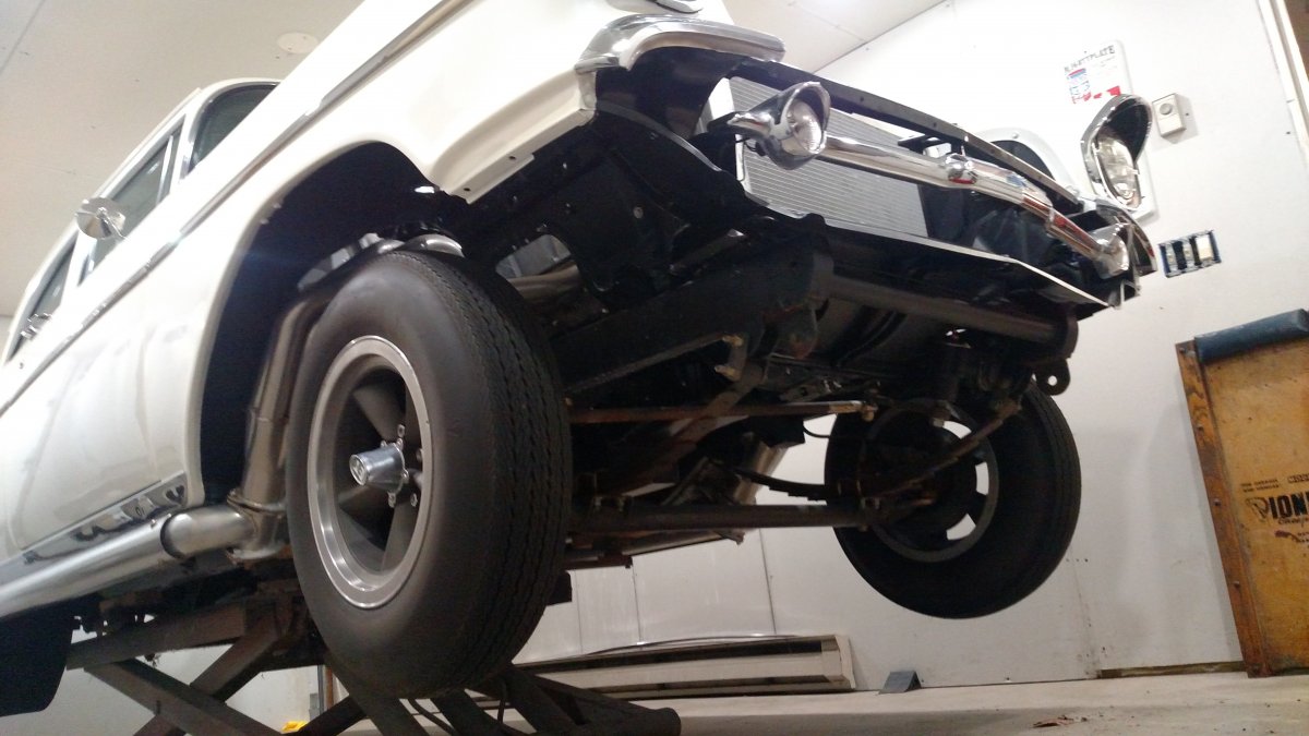

  24. chevy57dude
    Joined: Dec 10, 2007
    Posts: 9,670
    chevy57dude
    10-4 on that one! 7.75 15 Firestones up front on mine. The tall tires look right to me when the front end is up. JPEG_20170205_074901_-2042444220.jpg
    loudbang and lothiandon1940 like this.
