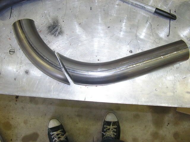

    Exhaust:
    I started out with 4, 1 3/4 U bends and 2 cones from the alliance vender, Cone Engineering. [​IMG]
    For the Flanges, i cut them out of 1/4 inch flat stock and used a hole-saw to make the port.
    I started out with the front port and cut a curved section, [​IMG]
    For the other 3 pipes, i cut a section again and will make the same cut on all three, just changing the length of the straight portion of the tube. I started with the end one because it will be the longest tube, so if i mess up (which i did) it will still fit in the shorter sections.

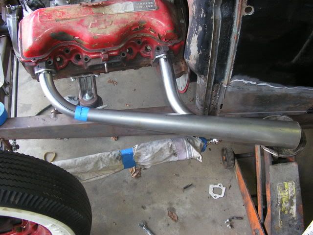

  3. Tindall
    Joined: Jun 7, 2007
    Posts: 399
    Tindall
    this is my first set iv built, that being said an inch and a half seems a little close, i think mine ended up being around 3 in.

    Yea 29's might be a little narrower.Or find someone who is running bare metal:)

  9. Fwiw, the headers four primary tubes on my 32 roadsters right side are 1/8" - 3/16" from the frame.
    The urethane paint went flat in that area, but hasn't burned to date.
    What did burn was the right side hood panel - acrylic lacquer on that.
    Funny part there is the outer curve of one primary tube is about 1/8" from the panel, but the burned area is 8"-10" back of that.
    I suspect the fan is pushing hot air and it collects right there.
    The area just over the primary tube is starting to burn.
    All of which is to say, an inch and a half may make it.
