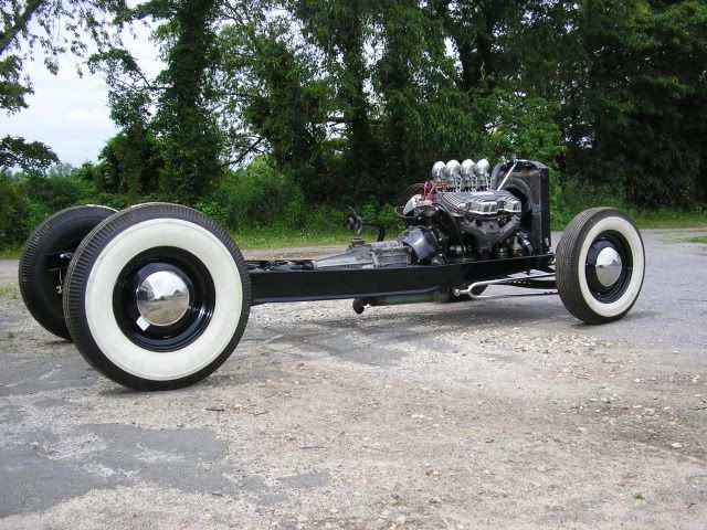

    Question: (sorry if I missed this somewhere) what material are those brake lines?? They don't look like steel or stainless steel? Is it just the lighting or are they something else?

    its a nickle/copper tubing made for brake lines...i work at an autoparts store and we order it in...its not cheap but it is the nicest line i have ever used...flares very easy and perfect every time.

    That motor looks really great, I'm just wondering what the thought process was for using the exhaust manifolds instead of the headers.
    I remember when you built those cool headers, I'm not critical in any way as the motor is really killer looking, just wondering?

    this was the first time the motor was fired up so i ran it through some mufflers so we could hear if there was anything wrong.... also im gonna keep the manifolds on for a while till i get all the bugs worked out in the motor...

    I see you dropped the Muncie idea in favor of a T-5. What was your reasoning and what model T-5 are you running?

    I wanted to run an overdrive trans...and have a 3.90 rear end. Also the shifter location on the t-5 is ideal... its a s10 tailshaft with v8 gears

    Good reasoning. I'm considering a T-5 myself which is why I was curious what setup you used. The S10 tailshaft makes sense.

  27. very cool build. I have a 30 full fender Tudor that is getting a 409/superT10. Any details on teh buildup of the motor? I ***ume the t5 is a WC, I would think it wil handle the 409, especially with the skinny tires, they should go up in smoke before you hurt the trans. I have a '53 chevy truck with a pretty nasty blown GMC 270 with a WC behind it, did the same thing, v8 close ratio gearing and a S10 rear housing. put a shim on the tailshaft to install the gear so I can run an old mechanical speedo.

    its a 63 409, 30 over with 10 to 1 forged pistions....it has big block h beam rods, hydraulic cam...
