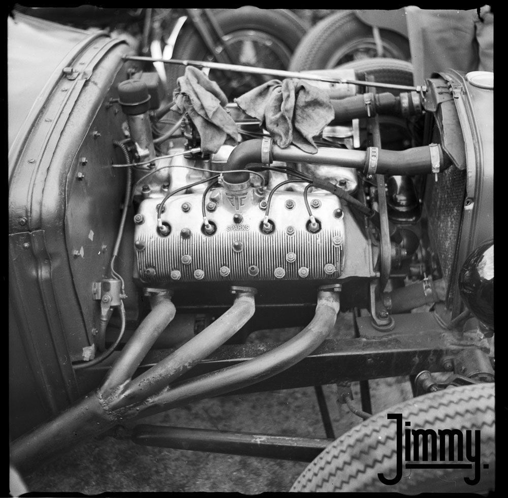

    An Excerpt from Dean Batchelor’s Book The American Hot Rod (Page 85)
    One outstanding exception I can think of were some heads made in the 1930’s by Art Sparks. These 21 stud heads (actually 24 Stud) were water-cooled over the valves, and had fins similar to those on a motorcycle cylinder – running transversely instead of lengthwise over the cylinders. Art explained to me that he wanted a different rate of heat dissipation for the valves and pistons, and this was his way of accomplishing that

    Just to mention there are 8 spark plugs per head though in the pic only four are wired..

    Looks like these heads are no longer unknown. Johns Rod & Custom - thanks for posting. I wonder if a set of these heads still exist, or if the set in the photo were the only set of these heads that were ever cast and are long gone.

    It would be fascinating to learn how he planned to fire 16 plugs off a flathead electrical system.

    those air cooled fins and possibly redundant plugs may mean that was intended for aircraft use? Just speculatin

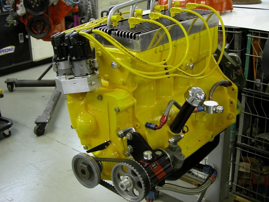

    The common way was to use a Nash straight eight distributor as the Nash was a twin p-lug engine from the factory. Here was my way. Inexpensive and direct way to fire twin plugs. new ply. jpg.JPG

    What are the distributors? Any mech adv.?

    I used Pinto distributors. I have done it with others, I did one with Mallory distributors for a Chrysler outboard for an odd fire Chevy V6 for Al Liest. The Pinto are stock with the exception of advance springs being changed for a more rapid advance. Head shown also takes water from around the exhaust valves, but then just flows back to the holding tank. Water doesn't actually flow around in the head.

    Pinto, what I thought might be..I was thinking of machining one to fit a Crosley, just to get a larger platform..Looks like you have points..I would need advance curve to start at 750 and be in by 2000 rpm, and handle 4k [dist] rpm..Possible?

    I don't know why not. I can absolutely attest to them running well past 8000 at the crank. They are Bosch distributors and use the same points rotor and cap as an air cooled VW. So parts are going to be around for a long time.

  29. Thought I would give this thread a bump with a new detailed photo of the 'SPARKS' heads from the late 40s, likely '47, scanned from negative. You can see someone ground down the fins o_O:(:mad:
