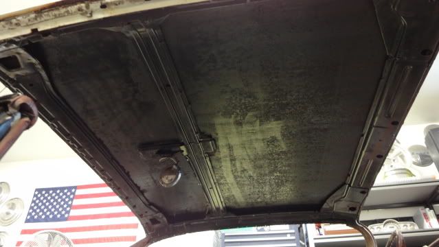

  30. fuzzy bunny
    Joined: Feb 28, 2007
    Posts: 448
    fuzzy bunny
    Hey guys heres a short update for ya.
    I got the roof stripped and all of the window channels cleaned out and Por-15'd. A little mud and some primmer and It will be time for shiny stuff!
    Got the under side all cleaned up and painted.
    Then sound dead'nd it to add a little regi***y for block sanding.
    And then more on the saga of the hood. I cut out most of the rust and the emblem holes and made a new panel that sofens the roll at the bottom of the hood. Then I started shrinking the shape out of the top. The Idea is to make the hood a little more stream lined and less like the front of a...buick...
