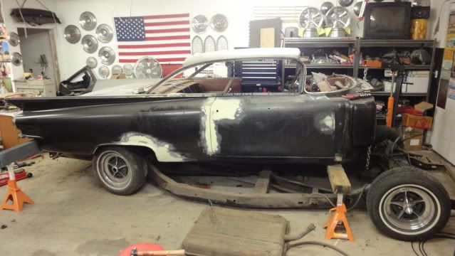

    I hope so. I have switched gears a little. I am focusing on the mechanical aspect for a while to get the thing drive able then hammer out the rest of the body work. with the body off, it will make finishing the bag system and breaks way easier sinse i have a fist full of lines and electrical to run. Also it will let me get the motor and trans hooked up the tork tube and make sure it seals right.
    And Its going to be green but i will look up that brown. A good brown is hard to come by. Thanks.

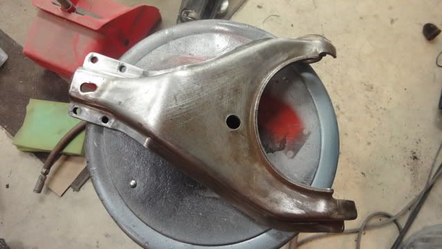

    Now the the body is no longer in the way of progress on the frame I started taring down the front end and finishing up all of the lose ends from the bags and such.

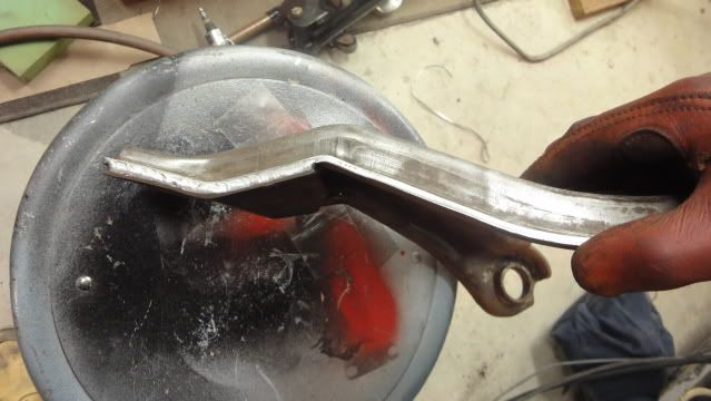

    I started by pulling the upper a arms off. They were pretty crusty and grose not mention beat up. The upper a arms were rivited together factory which makes servicing a pain in the ass. So all of the rivets (that were left) got growned out to get the a arm off. Then It wanted to fall apart and the two plates that make up the upper arm started to spread.
    I clamped it in the vice and the two plates were different shapes, so out came the grinder.
    Then welded them together.
    Cleaned everything up for paint.
    and paint

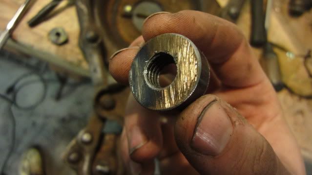

    I was concerned that if I ever blow a bag The car will be so low I cat drive it any where. I thought about it for a while and decided that If I had adjustaple bump stops I culd kind of lift the car back up enough to limp it home. So heres what I came up with.
    I started by removing the stock fixed bump stop.
    I then cut off a piece of my internally threaded barand made a bung.
    Then I re-drilled, and tapped out the lower a arm from the bottom in the same size and thread as the bung.
    Then I ran a bolt up through the bottom and threaded the bung onto the bolt to make sure it was good and centered. Then weld the bitch in.
    Once I finish the actual bumpstop part of it Ill show that too.

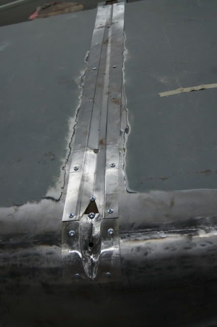

    Weeellll...here is another small update for those of you out there keeping track. Not much new, mostly just boring mundane chassie clean up. But I did finally find the piece of hood trim I have been searching for. whoda thought It would take a year to find a 63 polara hood spear? Oh well I guess that means the hood saga continues.
    I measured out the center of the hood and trim and place it on the hood to trace, then cut out the shape. amazingly this piece of trim is almost the exact dimentions of the factory stamped spear.
    I just kind of eyeballed the new front hood contour and wouldn't ya know its exactly where it needs to be. I think I need to do somthing different for a while. :D
    Then I started to build the actual trough that the trim will sit in and screwed it down till I get the rest made. It was a pretty simple piece to make just measure break, measure break, measure break.
    Now I just need to finish the nose recess and the very back and I can start burning it in.
