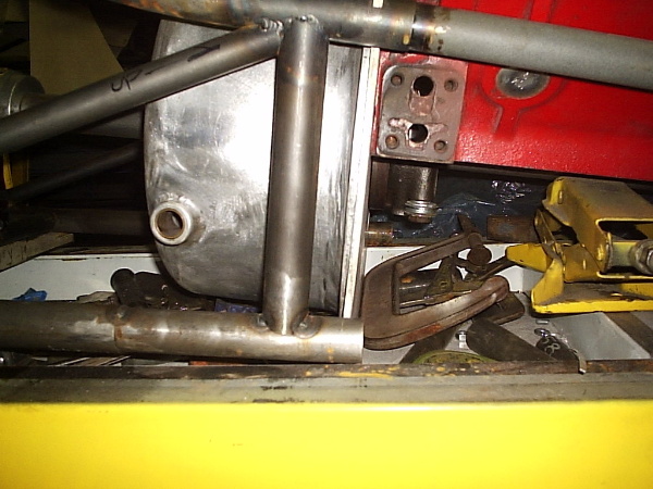

    First let me say that this recreation is not a real race car, it's a glorified engine stand. The modifications I'm about to do I would never do to a real car.
    The first thing I was troubled about is the engine set out from the center of the rear end. It was just too tight. So I decided to remove the upright at the motor plate and slide the engine forward two inches. I will probably get this all tacked up this week in my spare time.
    The next mod. I will be doing in a week or so is to cut the cage loose just behind the rear end and slide it back two or three inches. This all come s from looking at and scaling photos and trying to get the steering wheel back over the rear end. Also the cowl was around 24" long and I couldn't get more than 19" of space for it.

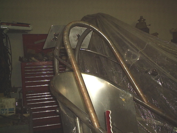

    I try to do something every day. Last week I got the fire wall upright and 1" diagonals tacked in . Then I cut the cage off and slid the top tube up the inside tube 3". I droped the bottom hoop just behind the rear end mount plate. I put a 3" piece over a 9" inside doubler and slid the rear hoop back on and tacked it to the rear uprights. I extended the seat uprights about 1.25" . The brake lever mount is tacked back in and I will re bend the lever to bring the top back about 2". Today I made the steering support that bolts to the center third member bolt. Monday I removed the dummy block and line up bar. Then dismantled the 3.64 third member and put just the pinion in with the female coupler in place I can still put my rear axle bar in and support the cage when I need to put the main rails on the front.

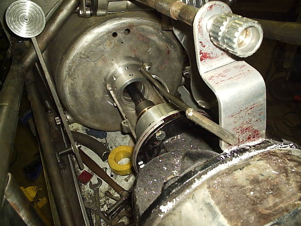

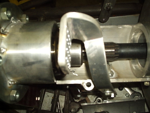

    Last update I got the drive shaft cover installed and tacked in. Then I drew up the foot pedal and kick out fork for the "Safety Slider" which is my version of a coupler disengagement device. This is mandated, Or recommended by the powers that be, to be able to uncouple and lock out the coupler when Cackling or starting up in the pits.
    Last week I built the pedal then the fork. Next I welded the pedal pivot into the bottom cover. I made a temporary link which will be replaced with a clevis and 5/16" rod end. The photos show the Pedal in the back position which is engaged and forward as in disengaged. Saturday I will machine a bronze coller that will press on to the mail coupler for the fork pins to pull the coupler back and forth.
    I have also built a clutch pedal similar to the original one but I'm not sure I am finished with it yet.

    I finished up the bronze collar for the "Safety Slider" today. Open the pictures and click next rapidly and see it go back and forth.

    Worked some Sunday doing small details, Seat belt mounts, chute pack mount plates, chute line mounts, bent brake lever back some and crotch shield all just tacked it place.

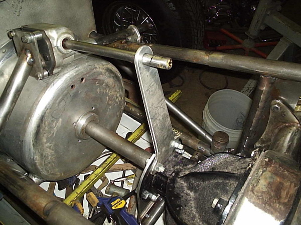

    Ben doing a lot of thinking about the foot pedal for the Safety Slider. We want to put more people in the car besides me. The proximity of the pedal to the throttle could be a problem. I cut the pedal off and drilled it for a rod up to he steering support. this works great and I will install a detente ball to help hold it in and out of gear.

    Got more done this week. Bent the "Safety Slider" rod down and shortened the handle. Cut and bent the 1/2" headache bars and tacked the chute mounts in place for a look see. Today I trimmed the seat for seat belts and worked out most of the hammer marks ,still some to do just but back in to see if I changed the width any. I started making several old style Dzus tabs but not done yet.

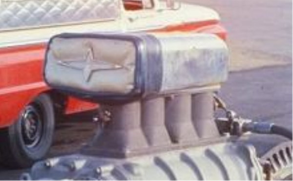

    I found the metal flake upholstery material . Now what is the stamped sheet metal star off of?
    dwrfab Don Ross www.donrossfab.com

    Don...That star looks as tho from a pontiac seat upholstering...somewhere in the 60s....

    I've seen those on E bay it's close but not the same ours had a 3/16"or so lip around it with a recess inside. We got this cover from the Anderson Brothers with the Hilborn injector and M/T valve covers around 1965.
    Thanks Don Ross
