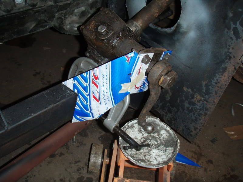

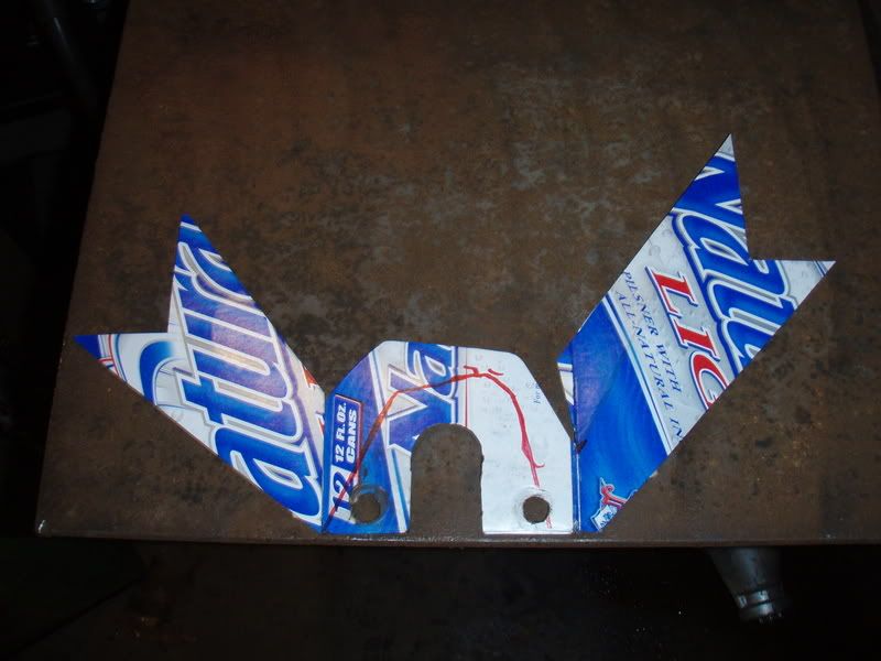

  5. Kool Kat
    Joined: Mar 5, 2001

  25. The arrows are where I compensated for the thickness of the material for the bends.
    I forgot to take any more shots after it as cut out.
    It fit good on this side, but the other had to be cut off, and welded back on. Half inch plate is hard to calculate and bend correctly!
    I wanted to make sure the box could be removed later, so I tacked it together before going any further. Needs a little trimming, maybe a few "lightening" holes. Looks a little bulky, but with the way the box is designed, I can't think of any other strong way to mount it. It's only tacked on for now, if anyone has a better idea, please let me know.:confused:
