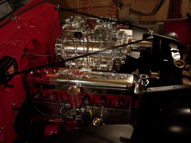

    i have a 58 235 im buildin with a mcculloch supercharger.
    gonna be pretty wild i hope. its going in a 51 chevy kustom so i dont really need the crazy horsepower or anything. would be nice but im building it look and sound crazy as i plan on driving the hell out of it once done.
    this thread has alot of helpful info for sure!

    BTTT!!! ftwkustom, did you ever get that supercharger on there????
    lets see some pics, I'm kindly dreaming about a blown 261 in a model A with a lasalle trans and a steep gear in the back!
