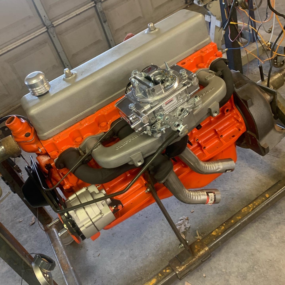

    I'm building a basically stock .040 over 57 truck 235 for my 50 pickup. 848 head, stock 261-spec cam, Fenton headers, Fenton dual intake, Carter YFs. Will post some pictures one of these days. I've enjoyed reading through this whole thread off and on over the past week.

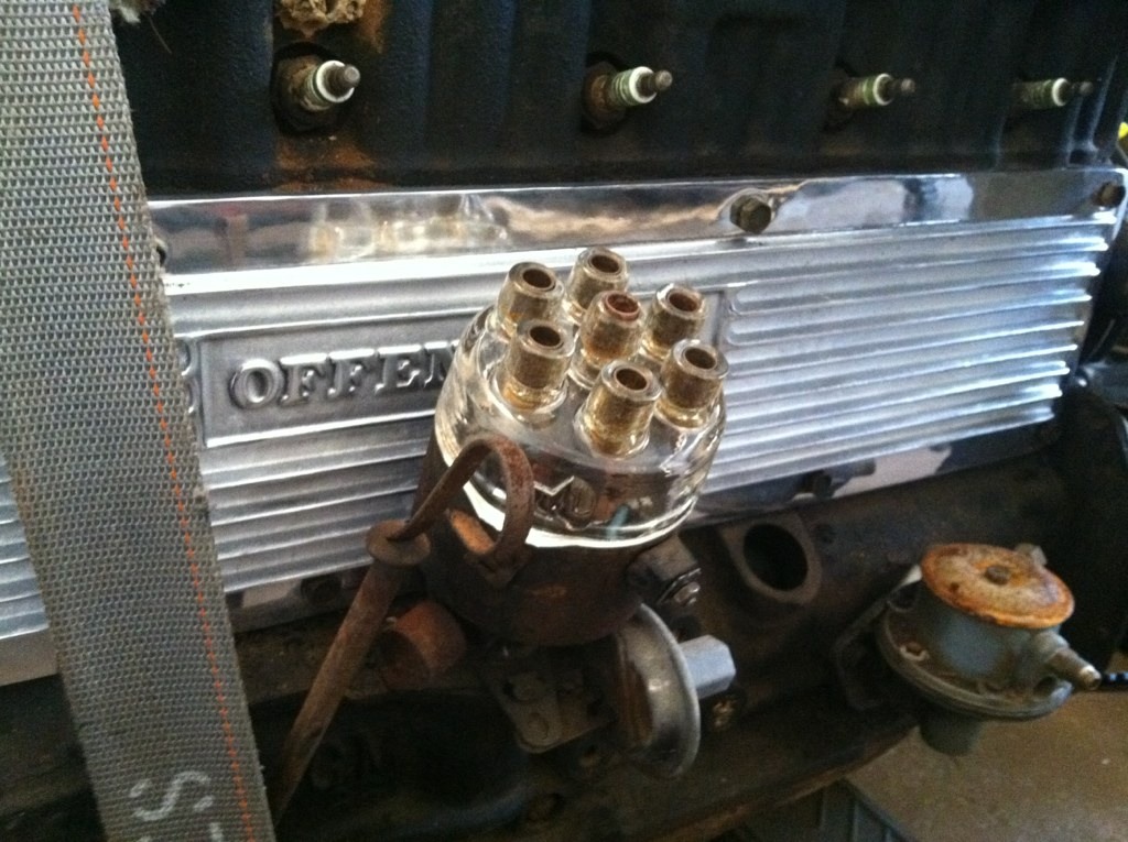

    Wow, that’s an old post. The distributor cap was supposedly made by autolite. Made of gl***. That motor looks totally different now.

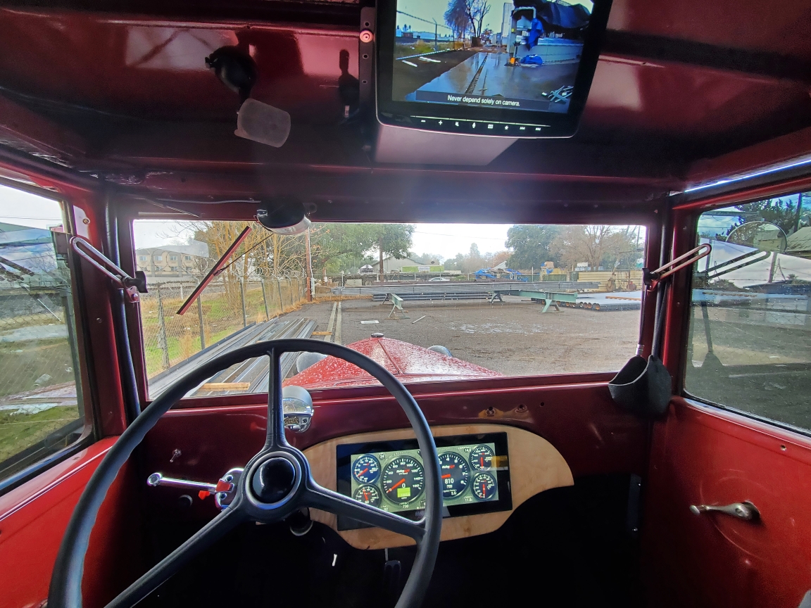

    I'm currently running a 235 with 848 head, shaved block and head with .040" cast flat top pistons. This is in a 1933 Chevy 1.5 Ton OB Ch***is with SM420, closed drive shaft, stock rear end with 5.43:1 gears. Holley Sniper EFI with Hyperspark on Clifford 4150 intake. Clifford split headers into Flowmaster Super 50. Everything runs great, so much better than with the stock manifolds and single barrel carb.
    I am building the 261 stroker to replace the 235 in my 33. My intention is to build a daily driver; this will include F-450 S130 rear axle with 4.30:1 gears, and a TKX with 0.72:1 5th gear.

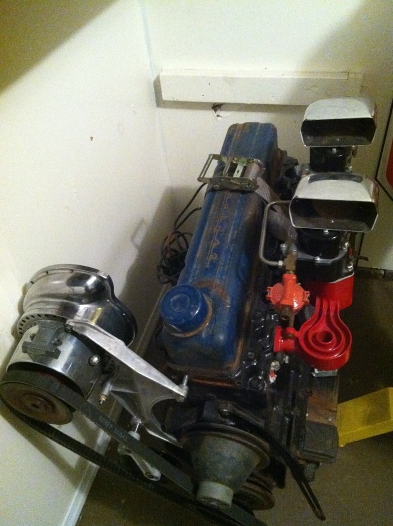

    after reading this thread more times than i can remember , and seeing the blower mtrs. i thought it needs to be woke up again ! how about more pix and info on blower application . are these bottom ends really up to the task ? how much room is needed at the front for the drive ?

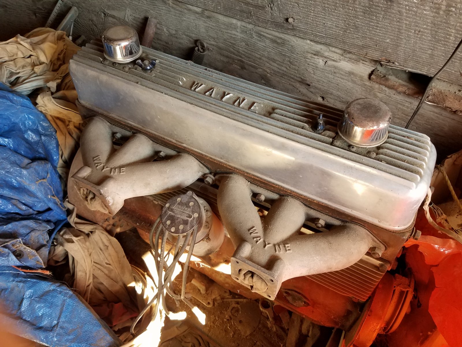

    What was purpose of placing the exhaust valve in a resessed pocket?
  18. Gofannon
    Joined: Feb 8, 2007
    Posts: 996
    Gofannon
    "In 1919 Ricardo was studying the phenomena affecting the combustion within the petrol engine and the diesel engine. He realised that turbulence within the combustion chamber increased flame speed, and that he could achieve this by offsetting the cylinder head. He also realised that making the chamber as compact as possible would reduce the distance that the flame had to travel and would reduce the likelihood of detonation."
    Harry Ricardo - Wikipedia
    Cutlas Fan likes this.

    What kind of head was that, with 3 intake ports on the distributor side?
  21. 52HardTop
    Joined: Jun 21, 2007
    Posts: 1,115
    52HardTop
    That's a 12 Port head with those being the exhaust ports. The intakes on the other side.

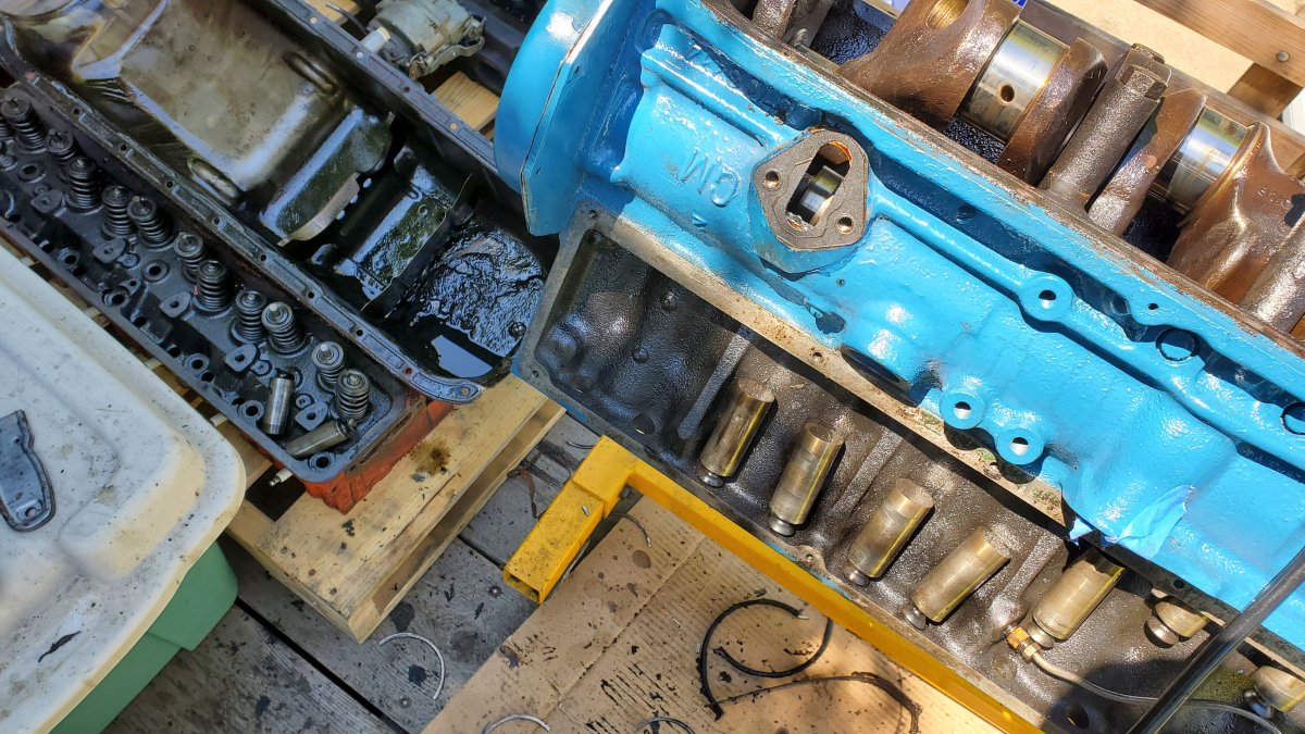

    I spun a bearing recently and it just seems like it could be the pump, do 235's have oil pressure issues?

    It's been my daily driver for years and have never built an engine that spun a bearing 2 miles down the road after a rebuild. Everything went together perfect. The pump is a few years old but I dis***embled before the build and it seemed great. Number 3 and 4 rods are toast and number 3 main is toast.
